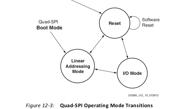

The lab starts with introducing the selection of boot device. The QSPI memory interface (Quad Serial Peripheral Interface) is a SPI (another asynchronous serial communication protocol) module which has a memory mapped register interface, which allows direct interface for accessing data from external SPI devices and thus simplifying software requirements. The bootup of the QSPI interface takes place in the order of the following finite state machine :
The UG585 manual states the following: In the I/O mode, the software can choose varying degrees of control by setting appropriate register bits to control different aspects of read data management. The Linear mode does all the necessary read management functions such as reading the ROM, to booting up the software. The Feedback clock which the lab manual instructs us to enable, is a memory interface clock that needs to be greater than 40 MHz. The feedback signal is received during the I/O state of the QSPI bootup sequence.

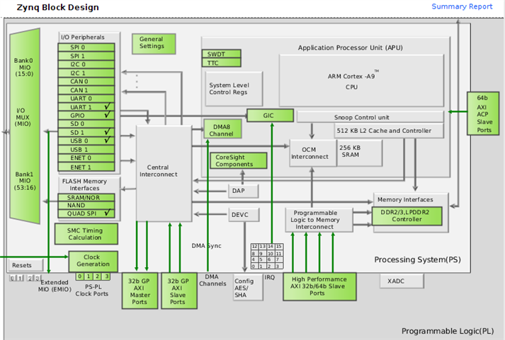

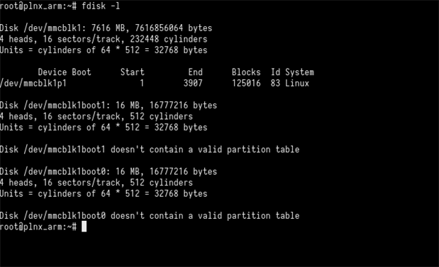

The next step was setting up the USB MIO pins. Followed by setting up the SD Card MIO pins. But wait a minute, I don't see any SD card slot ! The UG585 states that :
"Boot from SD Card: The BootROM expects the SD card to be connected to MIO pins 40 through 45 ". Thus, from what  I could conclude, there would be a "on board" memory unit (I highly suspect the Flash since it cannot be mapped by a EMIO) which consist of the bootloader and the Petalinux kernel. Sure enough with a little check :
2 bootloader partitions and a partition for the Petalinux? The answer would be unveiled in a later blog.

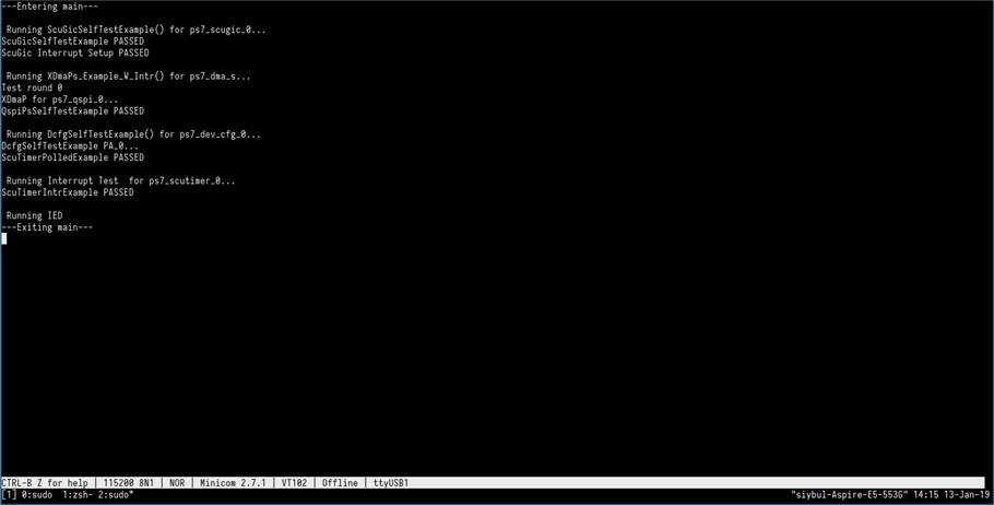

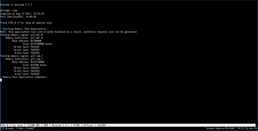

I won't talk much about the way the MiniZed has been programmed. One can look it up if needed. Also, one can tweak around with the generated code to see different results. For example, the core header file that Memory_tester revolves around is memory_config_g,c  This was a file generated from the hdf, which includes the peripheral name and memory units.

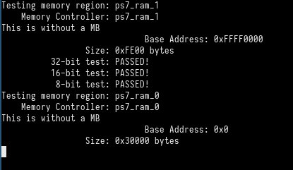

Firstly what happens if we try to test the memory unit ps_ram_0 which is being used to store the application ?
The program just stalls. Well self apparent explanation image.
PS NOTE : Don't play around with this too much, my board got really hot when I left this program running for 15 minutes!

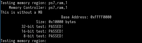

Secondly what happens if we extend the test range of ps_ram_1 to the end of the address space (here 0xFFFF_FFFF)?
It works perfectly fine. I have added the modified code to my git repo, here : My PTP repo
