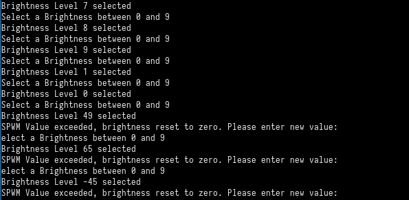

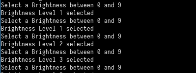

So now we move onto building our .elf file - on SDK. We have to start by importing one of the codes given in the zip files - LED_Dimmer_Init.c . It's a very straight forward code - and after reading the dma_test.c, this one seems to be like a cakewalk. But for the sake of those reading the code for the first time, I would briefly cover the code -
  • Initialize a ScuGIC interrupt for the PWM IP. Even though it never will be used, it is good practice to do so.
  • Set the brightness level according to the user's preference.
  • Run the LED using a PWM signal - where the level depicts the width of each duty cycle.
Output of the code is :
Tomfoolery
Just to answer some curious lads out there.
I removed the lines calling the interrupt system setup function  (see here My repo ). Question is - will it still work or not?
Sure enough worked like a charm !

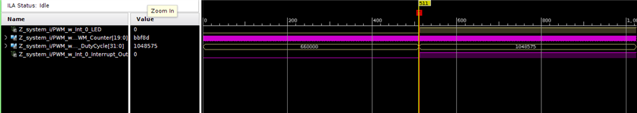

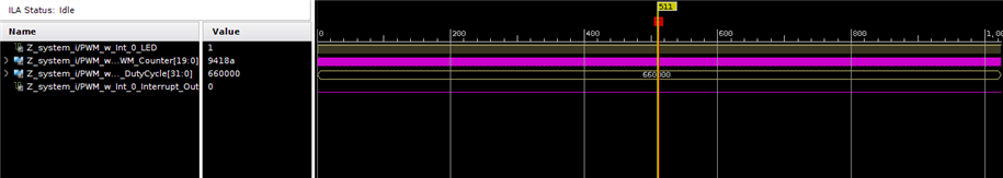

The second part of the lab talks about using the AXI-JTAG Master IP.
The AXI-JTAG Master core is an interactive IP where the user can constantly interact with the bd IPs through TCL.. To be honest, it is a really cool sounding IP. Can be very helpful in debugging especially the AXI IPs. Below are few of the screenshots I've tested out :
So that wraps up lab 8. Has given full justice to the AXI-JTAG IP core and the ILA IP core.
