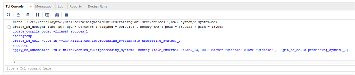

TCL interface
The IDE shows a "TCL" interface (Pronounced "tickle" by Josh Foster in the videos that accompany the lessons). It appears to be a command-line interface in which advanced users can manually punch stuff in to script the development a little. I'm looking forward to learning more about this later on. But in Lab #1, I could at least see commands and responses scrolling through this area at the bottom of the screen.

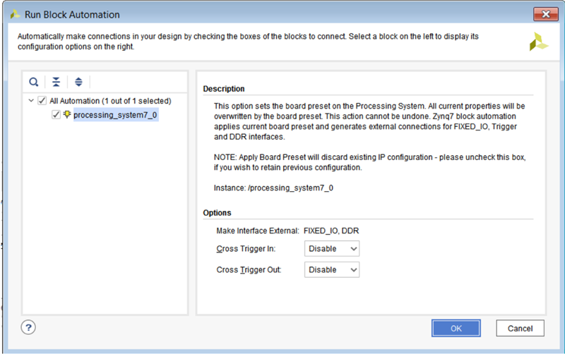

Run Block Automation
The Block Automation interface speeds up the act of enabling peripherals and configuring IO.

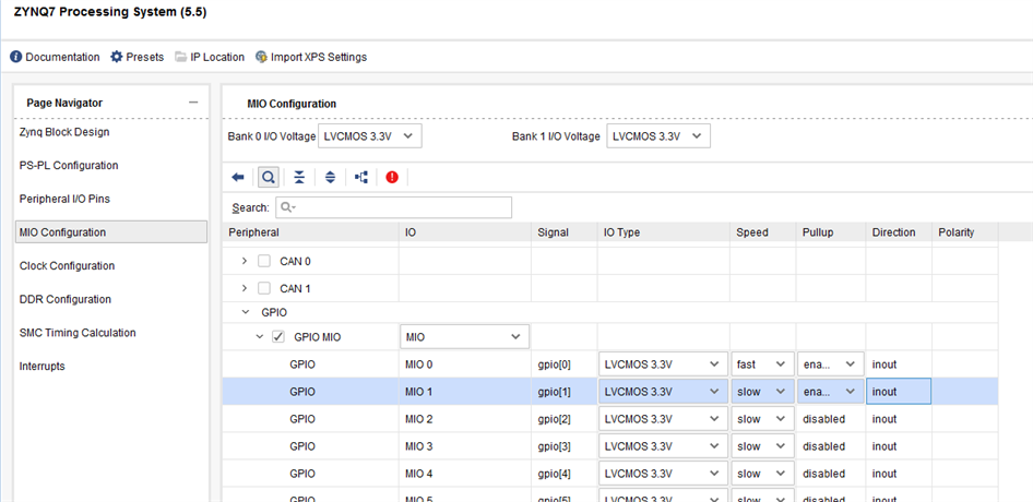

Configuring IO can be seen below:
