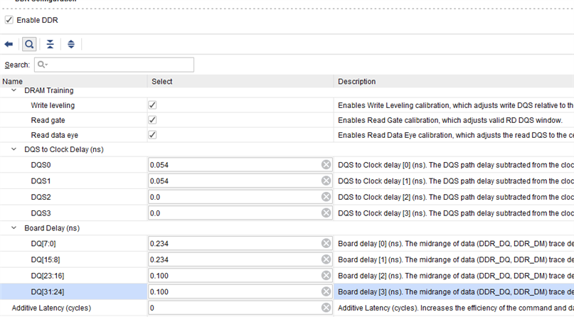

DDR (RAM) configuration
Configuration of the DDR RAM can be done a few ways. The Instructions walk me through the nitty-gritty of defining exact memory type, part number, bus width. It even allows for customization of things like memory clock frequency, junction temperature. There are some other necessary settings like latency for each of the four memory buses between the Zync and the DDR chip. If you've ever looked at a board and seen squiggly lines between two chips where it looks like the designer was just messing around and not taking the most direct route, that is a technique to ensure that all the lines in the bus have the same impedance and the same latency (as defined by trace width and trace length). I don't know too much about this process other than there are some provided formulas.
Here are the settings that we used in the training. We have to fine-tune the propagation delay in nanoseconds between the Zynq and the DDR memory.

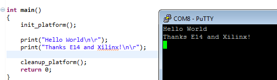

Finally, we can create a new application! The SDK has a canned "Hello World" program that we can use as a base. While we have the bitstream loaded, and the Board Support Package loaded on top of it, we click "File--> New --> Application" and can select a "hello world" option. This dumps in all the correct header files, 'includes', and creates a generic C file which prints "Hello World" out to the console.
Once that is done, we can push the code down to the REAL PHYSICAL (finally!) hardware.
Right before that, we have to change the DIP switch on the board to tell it to boot from JTAG instead of Flash. Once we select "Run" from the SDK and watch a few pages of debug info scroll by, we are greeted very kindly from the computer overlord. I got like... REALLY crazy once this happened and spiced up the code a little bit. Hope that is OK image

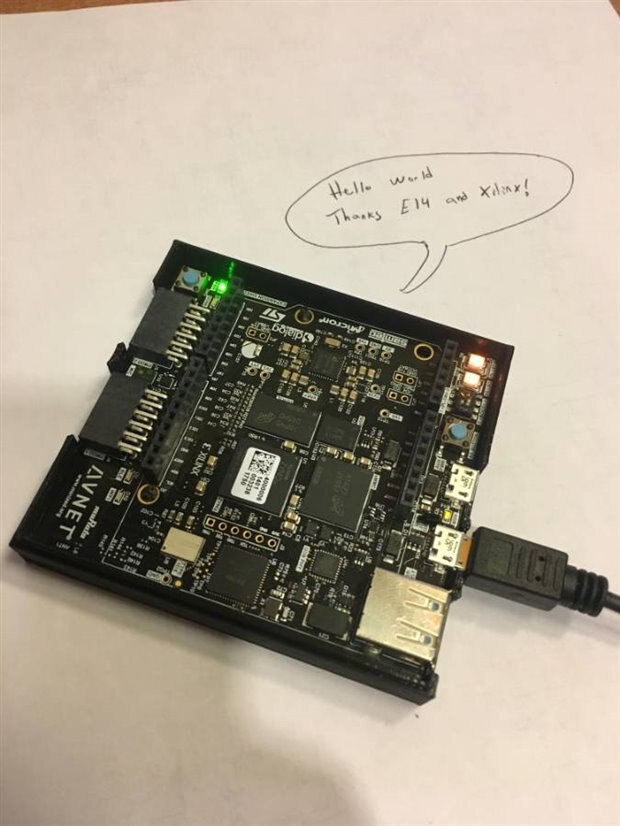

I usually like to do videos for each post, and I will make an effort to do so in future posts. Time has gotten away from me and I'm working to make up lost ground. In replacelement of that, here is an action shot of the MiniZed running my WAY AWESOME "Hello World" code image This picture is pretty explicit, so please hide all of your loved Ones and Zeros...
