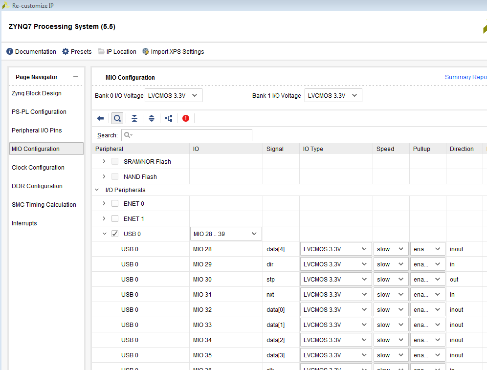

This was pretty straight forward. It did require careful following of the lab lessons to catch all the little portions that are required. Essentially, in Vivado I am going through the tool called "Re-Customize IP" to map the new devices. For example, with USB, I choose this from the MIO (Multiplexed IO) menu at the left, then check the box for "USB 0". Some options required customization of the options that are then available.

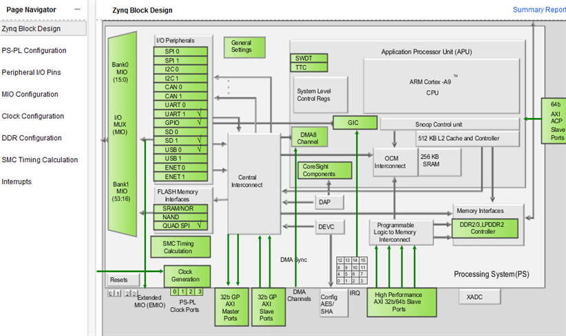

Once the new components were included, the Block Design looked like this which shows that everything is enabled.

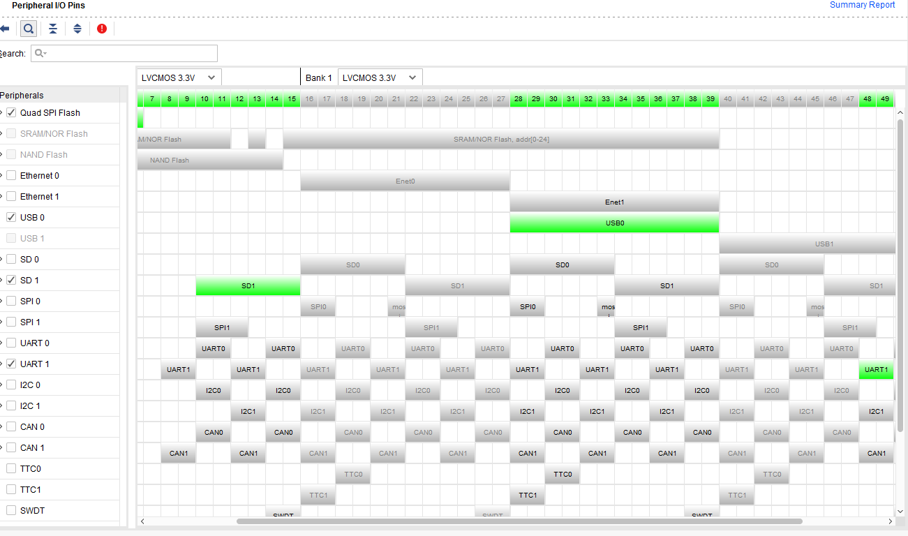

We also check the IO pins to be sure we haven't created any conflicts.

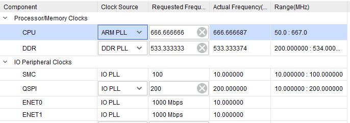

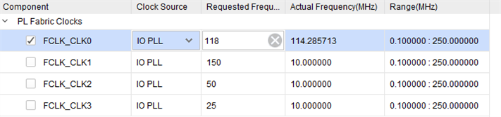

The next portion of the lesson has to do with setting custom clocks. I am still very new at a lot of this; so you will get to learn along with me! The Zync has a few (three ?) "PLL" devices - Phase Lock Loop. They are essentially master metronomes for the system; and subsequent systems can use this timing; or a divided-down version of any PLL source.
We can see the CPU is configured to listen to the "ARM PLL" at ~666. MHz. The DDR memory gets its own clock source from the "DDR PLL". The rest of the IO in this lesson is configured to use the dedicated "IO PLL". We can set different requested frequencies as long as they are integer divisors of the master PLL that they listen to.
The program shows what happens when different requested frequencies are chosen. In this example, I requested 118 MHz; but Vivado shows that I'll actually see a different value since 118 doesn't go evenly into the master PLL.

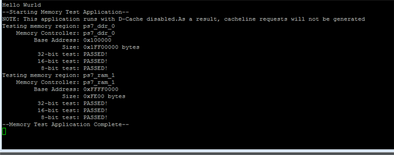

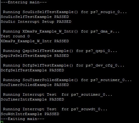

Once all the configuration changes are done, we validate & export the VHDL file and open the SDK for some memory tests.
The memory and peripheral tests were canned but very useful to validate the design. I was able to run them both successfully; thus completing the lesson.
