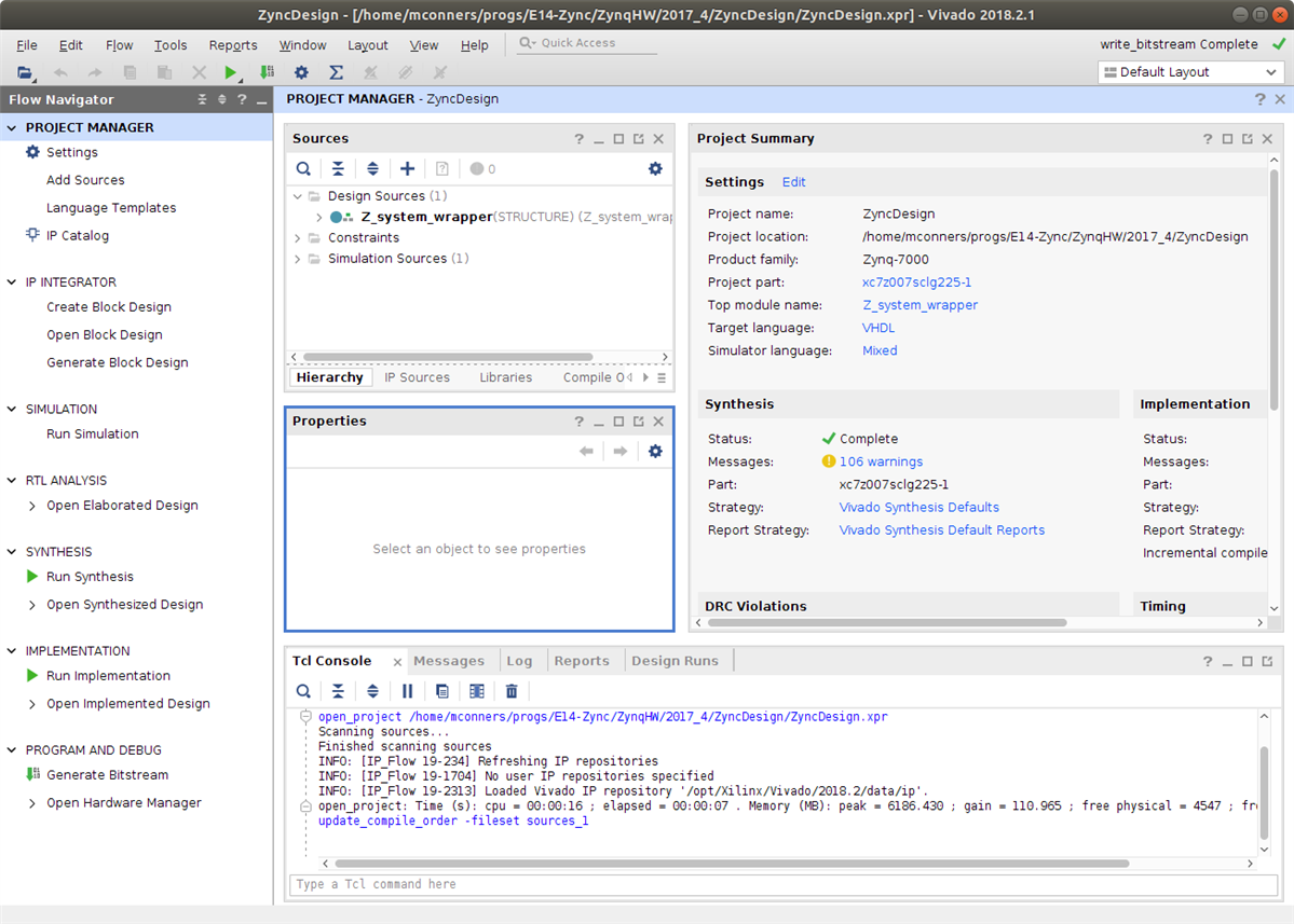

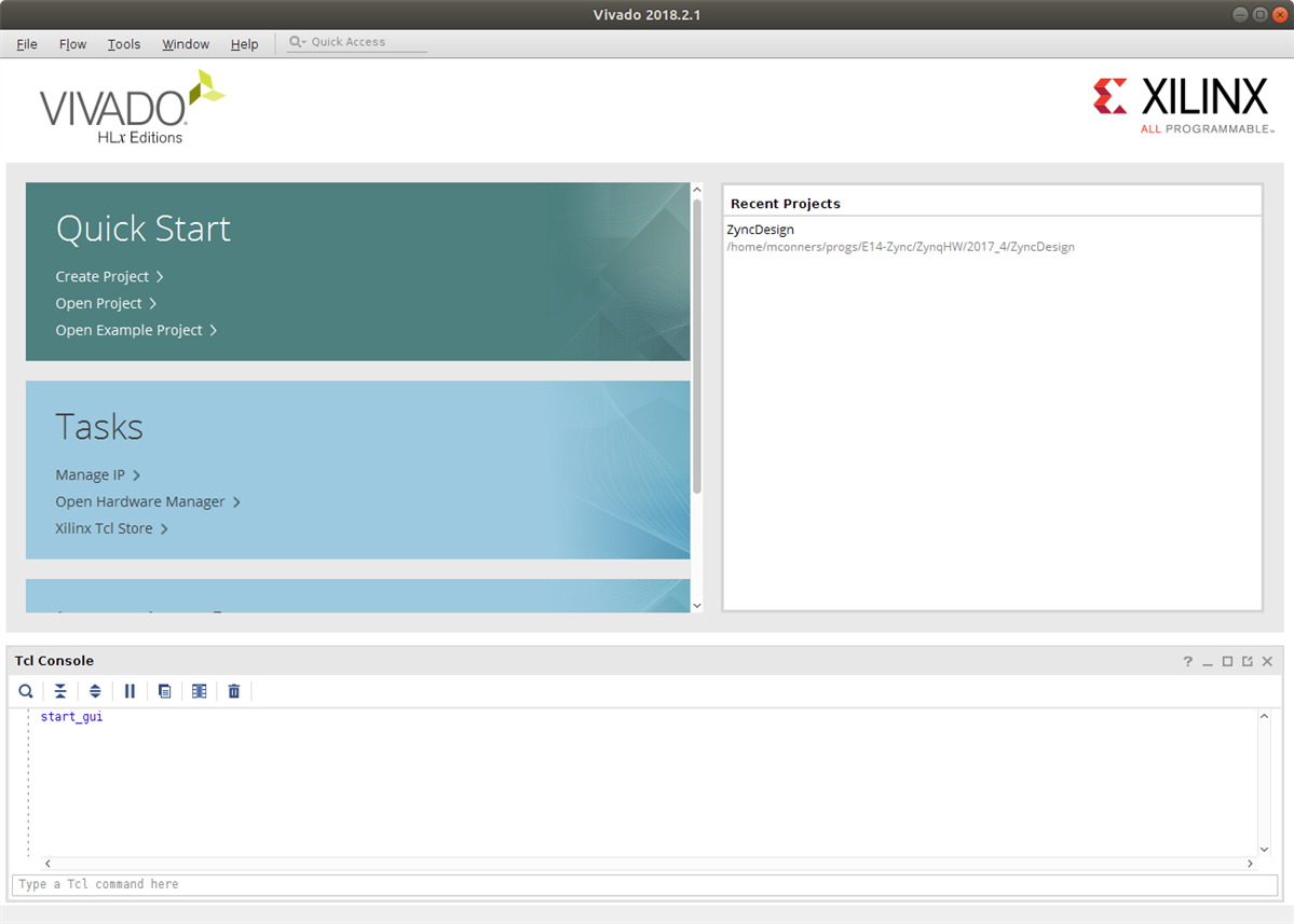

You can see the start_gui TCL command in the lower TCL Console window.
The TCL commands are in blue and the responses are in black in this view.
It shows that it opened the project:
open_project /home/mconners/progs/E14-Zync/ZynqHW/2017_4/ZyncDesign/ZyncDesign.xpr
and apparently updated the compile order
update_compile_order -fileset sources_1
