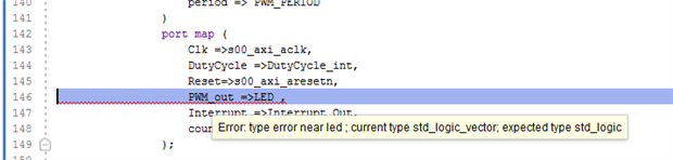

I found that I had incorrectly typed one of the instructions - I declared the PWM port as "std_logic_Vector" instead of "std_logic". This took a while to trace out since the line which was underlined in red wasn't where the actual problem was created. I had seen the red underline early in the lesson; but ignored it until the end hoping that it was just waiting for another part of the lesson to correct the fault. I tried to "run synthesis" to validate the design; and that's where Vivado halted me with an error message.
This shows where the problem actually occurred.
