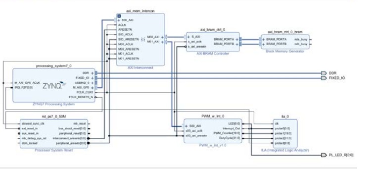

You may remember when we left off, we removed the JTAG interface from our board design, but we left the PWM module and the Logic Analyzer, so the Block Design looked like this:
and I said something about next lab we would do some more TCL scripting and I guessed it would be about removing some IP that we added. BOY WAS I EVER WRONG.

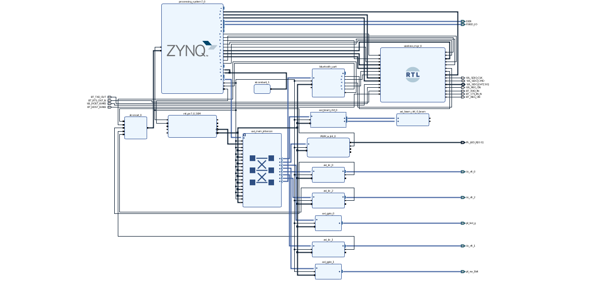

They had us open Vivado, go to the TCL console, change directories into the support directory for lab 9 and type:
source ./lab9.tcl
what that does is execute the TCL script and perform all the commands in the file. I was pleased with myself because you have 2 options when you do this, start from your continuously built labs, and execute the script against your code/project base, or delete your stuff and start over using a zip file of where you should be. It said in the lab that if you encounter errors, you should start over using their zip files. I had no errors, so obviously I must have followed all previous lab directions correctly.
Now this TCL script they had us run was 678 lines long, that includes comments, but it was no doubt a big file. As it was running I saw the above diagram turn into this:

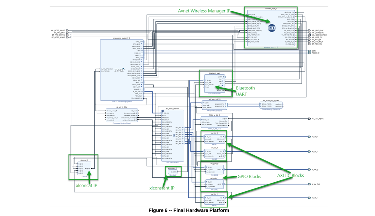

Now that's a little hard to read, so I'll also include the annotated one from the course materials :
They created all of that with TCL commands. And at the end of the script they saved the project, ran the synthesis and implementaion and generated the bitstream for the project. The say it can take anywhere from 15-40 minutes to execute this step. I didn't time it, but I'd estimate I was in the 15-20 minute range, maybe quicker, it didn't seem that long.
