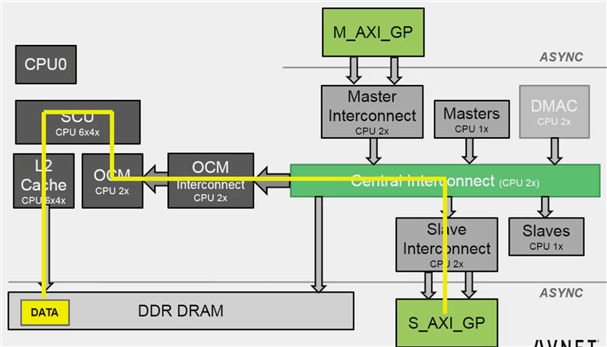

Lab 6 is all about Direct Memory Access - DMA.
DMA is a much more efficient way to access memory. This can be handled by the core FPGA and doesn't wast precious CPU cycles like it may otherwise require. Direct memroy access doesn't require all the data to flow through the central processor; but rather through the central interconnect on the chip to the DDR controller, then back and into the RAM.
The "slow" data path; as shown in the Avnet training slides.

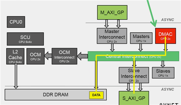

Then, with the use of Direct Memory Access, the data flows through the central interconnect to the DMA Controller, then right over to the DDR.
The Zync chip has 8 concurrent DDR channels - 4x for the PL and 4x for the PS. Additionally, USB, Gigabit Ethernet, and STIO have intrinsic DMA built in.
In the lab, we import the hardware settings from an earlier lab, then export our VHDL and launch the SDK. Within the SDK, we generate a new board support package with the new hardware description, then import a sample program which tests the different methods of moving data. The program calculates the time delta (measured in clock cycles) for the two methods of transfer.
