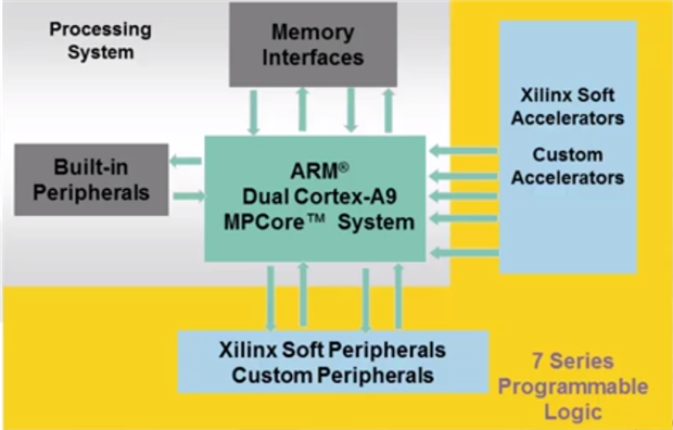

It can be Easily Understood With Help of Architecture in Below.
Architecture of MiniZed PSoC :
Here It can be seen as a Device with Two Blocks (Areas) tightly Coupled (connected) : 1.Processing System (Gray Area) and  2. Programmable Logic (Yellow Area)
Processing System (called as PS , informally call it  CPU or MCU ) works just same as a normal MicroController or a Small CPU with Periperals (similar to BeagleBone Black)
Programmable Logic (called as PL )Works as a FPGA (Informally call it as FPGA)
The Intersting thing is Both Blocks are Independent in Functional but talk to Each other as shown in below fig
The ARM core in PS( CPU )  talks to the Device(Custom Logic or IP core) we Built in Programmable Logic using  the Memory Space Addressing (Simply as a Location with Address in DDR memory)
The PL(FPGA ) talks to ARM core by sending data to DDR memory through the Registers Designed as sort of Middle man or Interfacing
In this way these both Guys - Our PS (CPU )and PL ( FPGA ) guy who are unknown to each other but talks as if they are on same channel but Actually their Different Channels are made to Appear as Same by the DDR Memory and Registers as Middle men for them.

    Good explanation - It makes much more sense to me now image
    It is /both/ an FPGA and a regular ARM processor.
