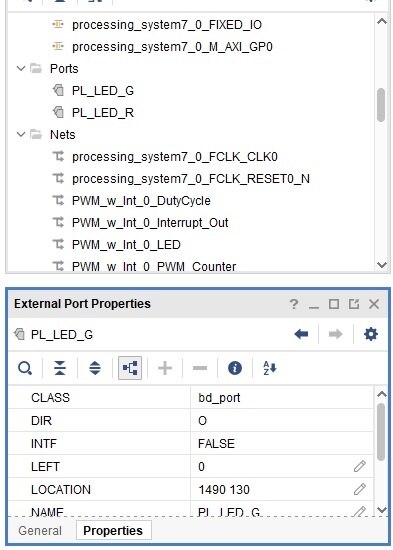

I added another instance of the IP PWM_w_Int, and connected it to PL_LED_G

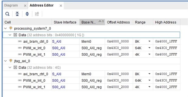

The new address of the second PWM channel (Green LED) is 0x40002000:
The green and red PL LED pins are also available on the Arduino headers as A3 and A4 so I didn't have to add any new port definitions:

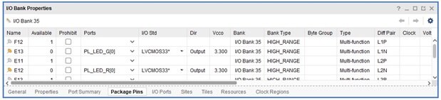

I stumbled upon the IO Bank definitions after getting many bitstream generation errors and set up the Green LED PWM2 on E13:

#define PWM_BASE_ADDRESS               0x43C00000
#define PWM_BASE_ADDRESS2              0x40002000
Xil_Out32(PWM_BASE_ADDRESS, brightnessRed);
Xil_Out32(PWM_BASE_ADDRESS2, brightnessGreen);

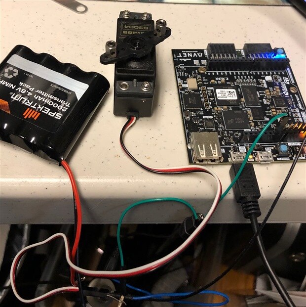

Here's my servo test setup:

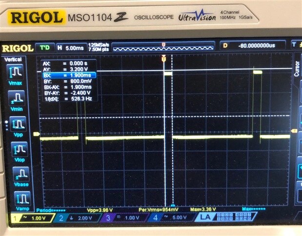

Here's a scope trace of the PWM signal:
I may have to boost the PWM signal from 3.2V to 5VDC for the servos to operate consistently.
Currently the video streamer and the servo drivers are on two separate MiniZed boards, although I am trying to get everything to work together on one board.
**update 19 Jan
I added a level shifter to the AO3 and AO4 outputs and ran a short test program that runs the servos in sine wave patterns:

    Nice job! Do you know why the issues with E13 versus using E12? You could also use the accelerometer right on board the MiniZed if you're able to read it. I wasn't able to find any example code for I2C…
  • aspork42
    aspork42 over 7 years ago
