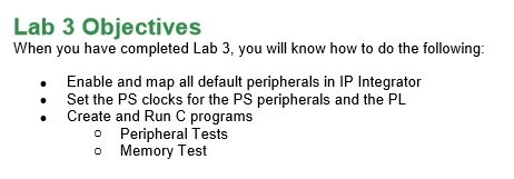

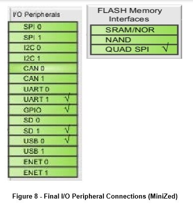

Lab 3 objectives:
This lab is designed to set up the hardware configuration in Vivado and the SDK for the actual components and features found on the MiniZed board.
This is similar to the include file for a microprocessor GPIO mapping you would use with a typical compiler, although much more complicated.
There is a nice "wizard" type interface with tabbed pages to let you visually see how the peripherals are mapped and connected to each other.
Vivado has a very visual interface that makes it easier to comprehend how the individual components are interacting.

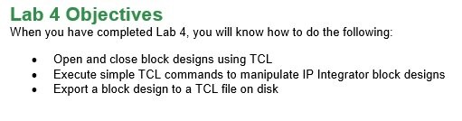

Lab 4 objectives:
This lab showed how to manipulate the Vivado program by using a scripting feature called TCL.  Several of the tasks from the first few labs were "automated" using TCL commands similar to a batch file, and saved in a .tcl file.
I might be dating myself, but the TCL interface is much like the COM (Component Object Model) interface I used to have windows programs "talk" to each other.

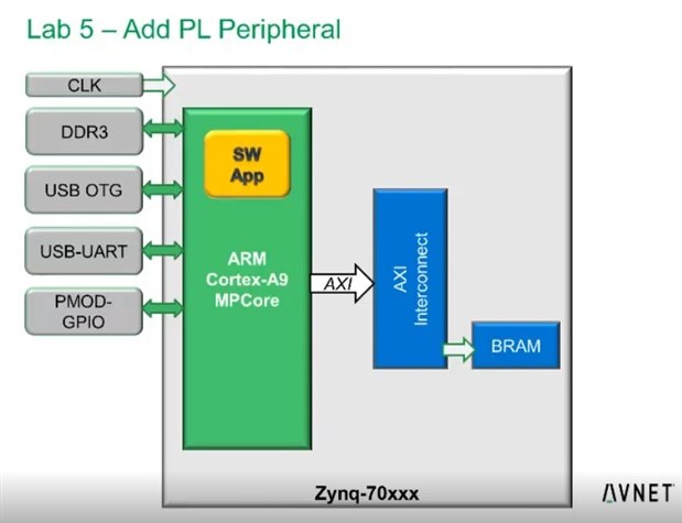

Lab 5 objectives:
This part of the training is new to me.  I've never had to worry about mapping memory since the days of EPROMs .  There are multiple ways to connect peripherals depending on the speed and features required for your configuration.
The AXI interconnects are used to interface the peripherals in a master/slave relationship.  There are high speed and low speed AXI ports, and you can configure the data size and memory parameters for each port.
I watched this video 3 times and did the lab twice to figure out what was going on.

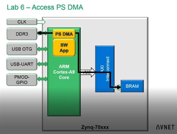

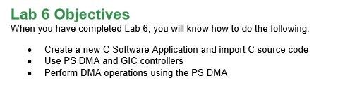

Lab 6 Objectives:
Lab 6 is a continuation of lab 5 by using the different memory banks DDR3 vs BRAM to execute code and showing the speed differences.  I'm still digesting this one.
