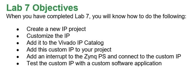

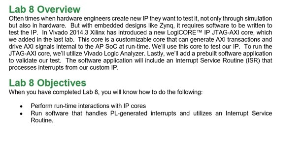

The objectives of Lab 7:
https://www.xilinx.com/products/intellectual-property.html

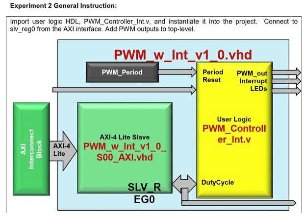

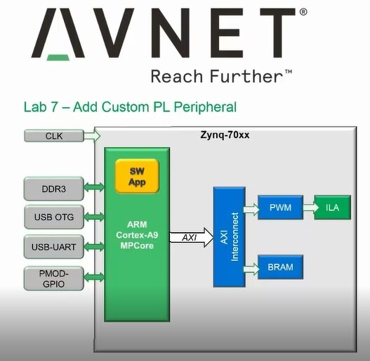

The basic objective of the last few labs in this training module is to light up an LED and control it with a PWM output.
In addition, the JTAG interface was explored, along with ILA debugging.  A few hours into this session, I could enter a number into a
terminal program, and the LED would change brightness from off to full-on.  The ILA is a logic analyzer GUI that utilizes the
dual-port memory to view signals real-time.  In this case, it was used to view a trapped interrupt signal.  Very cool.

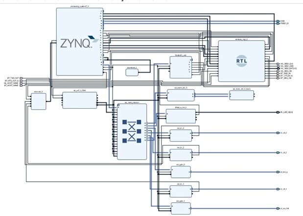

I am amazed at the auto-connection and routing routines in Vivado.  I've spent hours making nice looking schematics that only takes seconds here.

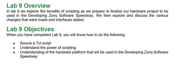

Lab 9 started off well.....

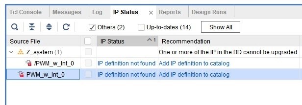

Then I ran the Lab9 TCL script...….
12 errors, 551 warnings, 58 critical warnings, 1,137 info, 207 status messages.
[DRC INBB-3] Black Box Instances: Cell 'Z_system_i/axi_mem_intercon/m01_couplers/auto_ds' of type 'Z_system_Z_system_auto_ds_0' has undefined contents and is considered a black box.  The contents of this cell must be defined for opt_design to complete successfully.
[Vivado_Tcl 4-78] Error(s) found during DRC. Opt_design not run.
[Labtoolstcl 44-513] HW Target shutdown. Closing target: localhost:3121/xilinx_tcf/Xilinx/1234-oj1A
The TCL script added a bunch of things, I just need to figure out the error messages.

    DAB over 8 years ago +1
    I am confused. Did you get the new part defined or did it bounce? DAB
  • rsc
    rsc over 8 years ago in reply to DAB +1
    ===> 12 errors, 551 warnings, 58 critical warnings, 1,137 info, 207 status messages. ===> [Vivado_Tcl 4-78] Error(s) found during DRC. Opt_design not run. That's where I'm at. Scott
