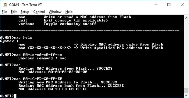

Lab 10 objectives:
In this lab, the QSPI flash memory was read and written to using a simple terminal window menu.
When I was working on this lab, I made a new bsp, but forgot to change the stdin/out from ps7_uart_0 to ps7_uart_1, and it took me a while staring at a blank terminal
re-compiling several times before I figured out my mistake.
