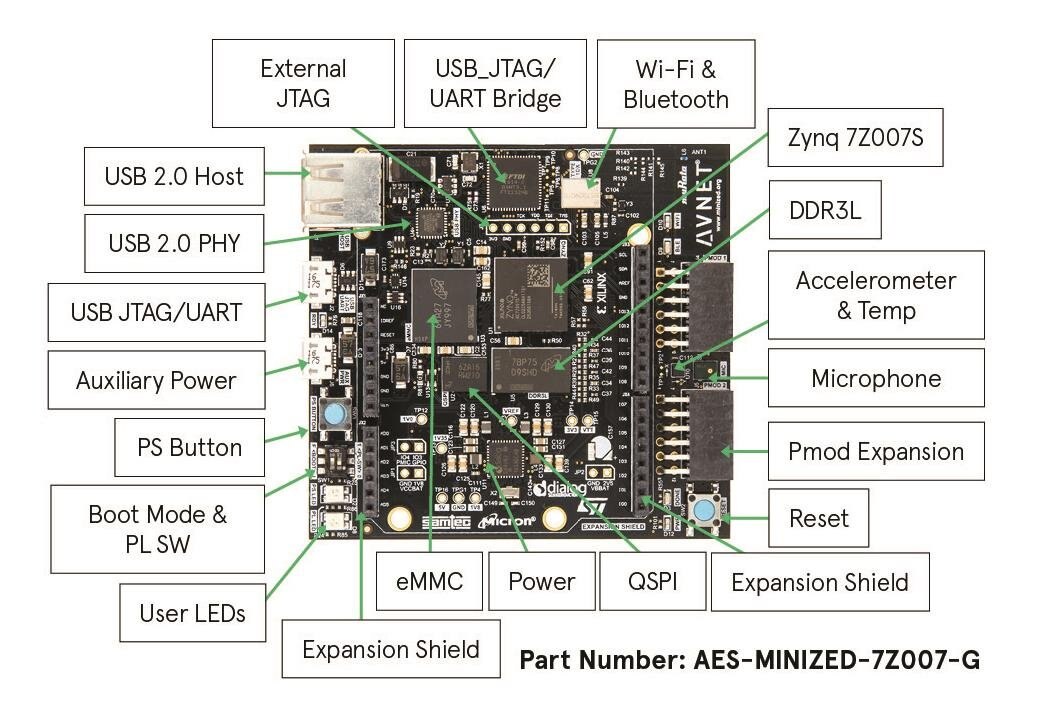

First of All What is Minized Board ?

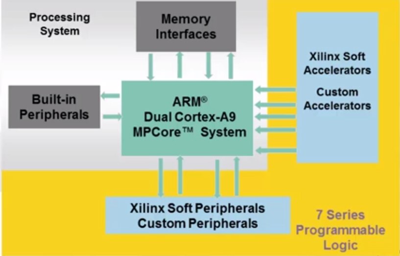

Minized is Xilinx Zynq XC7Z007S based Programmable SoC (System on Chip) , which has a  Processor Subsystem (PS) of ARM Cortex A9 core and the Programmable Logic (PL) based on Xilinx( Artix 7 for Minized )fabric.
What is Programmable SoC ?
It is simply a microController like device but which Large Number of Peripherals (UART, Bluetooth,WiFi etc)and High Computing Power CPU core (ARM cortex A9) and in addition to this It has a Programmable Area (Similar to that in FPGAs) which can be used to build or Design any Hardware ( such as USB controller device , Counters,Multiplexers etc)or Other Custom Blocks (Adders , DSP systems etc).
It can be Easily Understood With Help of Architecture in Below.
Note: Below Architecture is of Zynq7000 which has 2 Cortex A9 cores where as Minized based on Zynq7007s has Single ARM Cortex A9 core
Architecture of MiniZed PSoC :
Here It can be seen as a Device with Two Blocks (Areas) tightly Coupled (connected) : 1.Processing System (Gray Area) and  2. Programmable Logic (Yellow Area)
Processing System (called as PS , informally call it  CPU or MCU ) works just same as a normal Micro Controller or a Small CPU with Peripherals (similar to BeagleBone Black)
Programmable Logic (called as PL )Works as a FPGA (Informally call it as FPGA)
The Interesting thing is Both Blocks are Independent in Functional but talk to Each other as shown in below fig

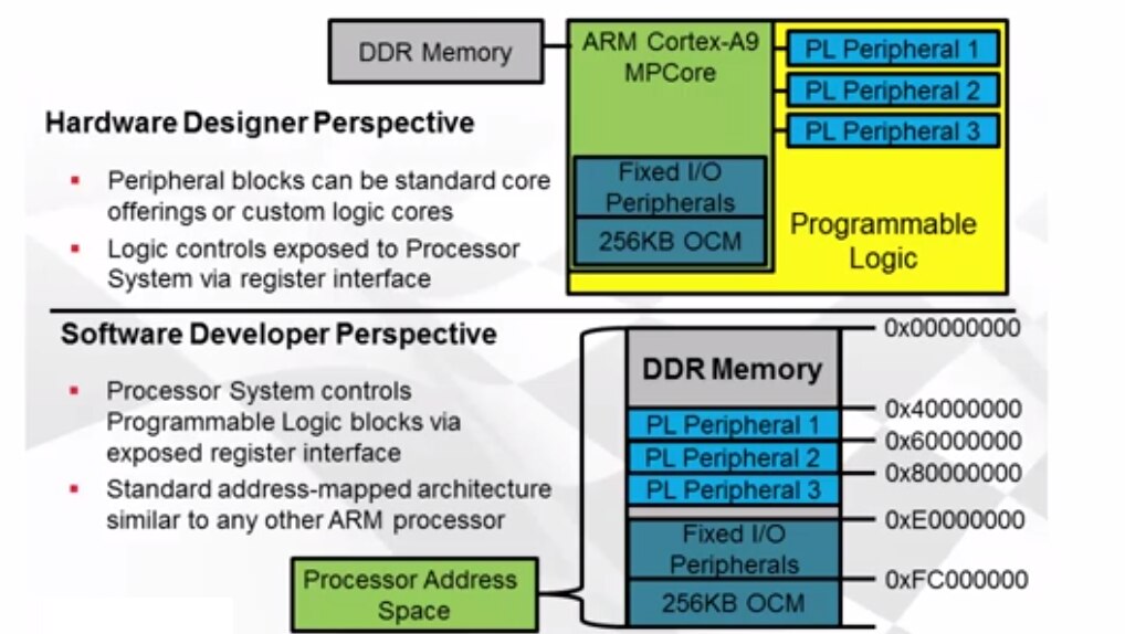

The ARM core in PS talks to the Device(Custom Logic or IP core) through AXI Interfaces we Built in Programmable Logic using  the Memory Space Addressing (Simply as a Location with Address in DDR memory)
It means , A software Designer can See the Device in PL fabric as a memory location , Interact with it in same way as that of with Memory .
The Blocks or Devices in PL talks to ARM core by sending data to DDR memory through the Registers Designed as sort of Middle man or Interfacing by Mean of AXI .
In this way these both Guys - Our PS and PL ( FPGA )  who are unknown to each other but talks as if they are on same channel but Actually their Different Channels are made to Appear as Same by the DDR Memory and Registers as Middle men for them.

By Exporting the Hardware into the SDK , Vivado Directs SDK the Peripherals available in the Design with their Addresses to interact with it by means of Hardware Defination File (.hdf file).
So that When we start working with SDK , you just need to work on the Address locations just as you would in any Embedded System or MicroController Programming, This Approach Helps the Software Designer to get rid of Hardware Complexities and Signaling Problems in Low Level , It gives you an Abstraction to see the Whole System with All peripherals as similar with Unique Address Locations and Load or Store Data into that Location Accomplish a Complex Task of Interfacing that Mysterious Hardware Block.
