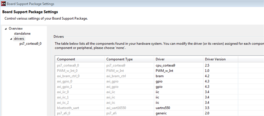

Importing HDL and generating BSP
The HDL file is generated from Vivado and describes the 'hardware' that is included in a project. This means things like a UART, BRAM, Flash, SPI, and any custom IP like the aforementioned PWM controller. The HDL file is literally just 'describing' the hardware. So it will list things like memory addresses, what the physical pin layouts are, what clocks and timing setups are used. It is up to the BSP to tie these physical descriptions with specific drivers and libraries to make them work together. Once the BSP is created, the software developer will have everything that they require to start developing the actual software.
BSP hardware components and associated drivers to be included:

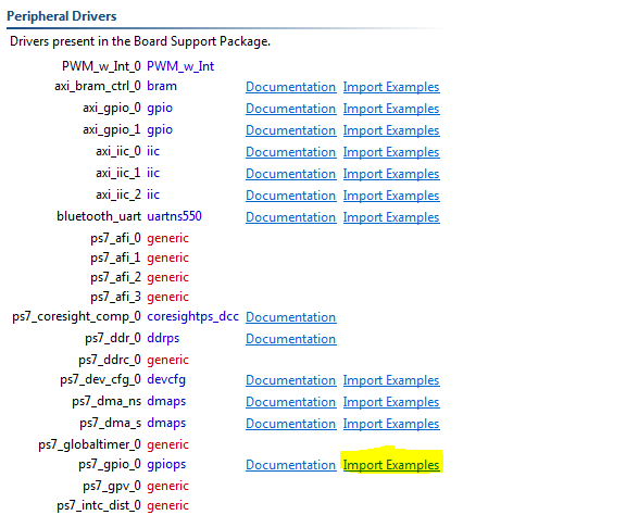

Once the BSP is created, we can examine the system.mss file which describes the BSP. This file shows all the relevant info for the BSP; and even includes links to example code for each of the individual drivers that are used.
In the lesson, we click on "Import Examples" for the ps7_gpio_0 and pull in example code for reading GPIO inputs and writing an LED on and off based on that input.

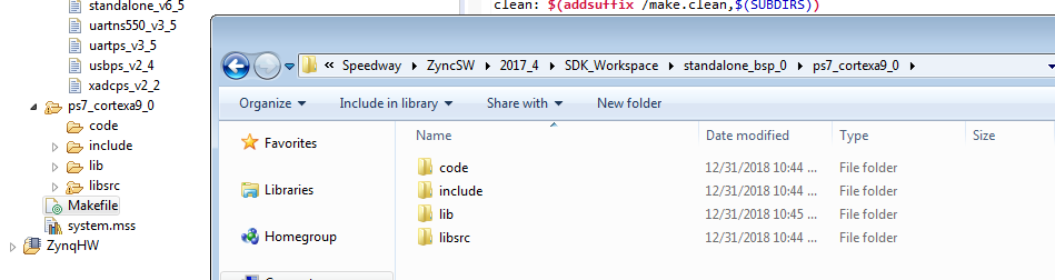

We also are shown that the Project Explorer is showing us what is physically located in our workspace on the hard drive of the computer. So if we ever need a back door into the file structure; it is all present in this location.
It is noted that these four files are removed & re-created every time a new BSP is generated. This means that we should never edit them directly as they will be blown away. If changes are required; it could mean re-generating the HDL from Vivado or re-importing individual libraries as required.

    DAB over 7 years ago +1
    Nice update James. Since the files are overwritten, you can always move them to a different folder if you want to keep past versions. DAB
    Nice update James.
