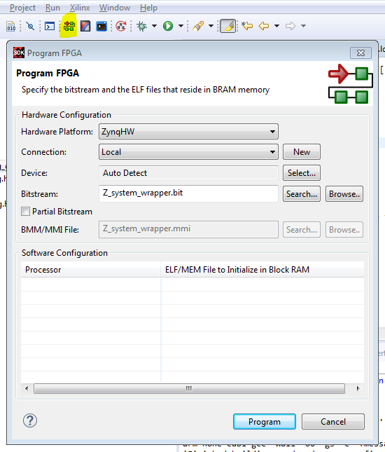

We open the SDK after having our board plugged in and press "Program FPGA" (the button highlighted below).
This sends the current loaded application in the SDK down to the board. Again - this is just held in volatile memory and NOT saved to the board itself. The bitstream is written when the "Program" button is pressed.

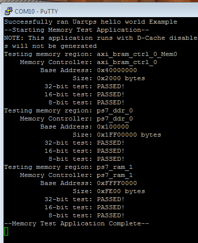

The Hello Zynq program is run (right click on top level folder in Project Explorer --> Run As --> Run Configuration --> New --> Run) and we get our output shown in the serial console. (I'm running PuTTY as my console application).
I also then ran the quick memory tester application which tests the first 4K in BRAM, DDR, and regular RAM. The Test_Memory_FullDDR also also run and it validates a full 1mb of DDR memory.

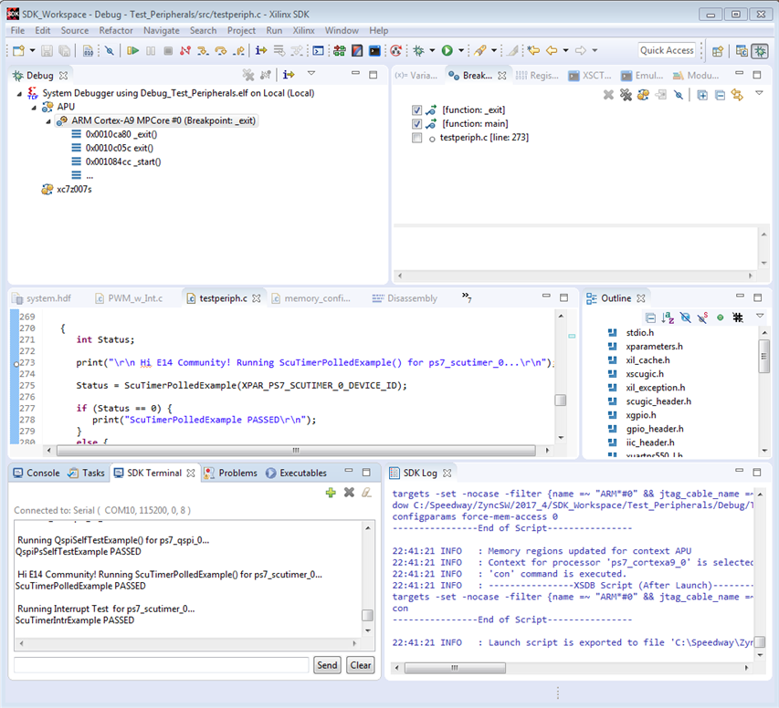

The last portion of this is running the debugger. Using similar methods to the "run as", we right click our program in the explorer and hit "Debug as" and then "New"; "Debug". The difference here is that the SDK "perspective" changes to the "debug" perspective. This feels a lot like Visual Studio when you "F5" to debug a program. The bitstream is written to the MiniZed and we have a new view of the SDK. We can set breakpoints, step through code, pause execution, check variable status/values, and manually check all sorts of other things if we chose. Another difference is that I am able to close PuTTY and use a terminal directly within the SDK's Debug perspective as a tab. This felt much more useful and more complete for this type of debugging.
We are also presented with our source code, the C file, and I was able to edit directly in the debug window then "relaunch" the debugger and try out the changes. This was very powerful as it would allow a fast way to work through code changes and test things.

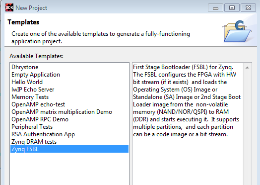

Creating the FSBL from template
This is pretty straight-forward. From within SDK, we click "File--> New Application Project --> then chose FSBL from the list of available templates. One change is that we tell SDK to create a new BSP (Board Support Package) instead of using the existing one. This is because the requirements of the FSBL are different from the regular BSP as it includes a file system library (xilffs).

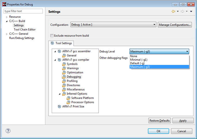

We then check the Properties for the build. There are numerous options for compressing down the build size and for setting the debug level. The default is No Optimization, and Debug level to Maximum. For a final deliverable, then these should certainly change to be more... embedded image
My release file came out at 157,500 bytes (153k); so about 5% smaller.
