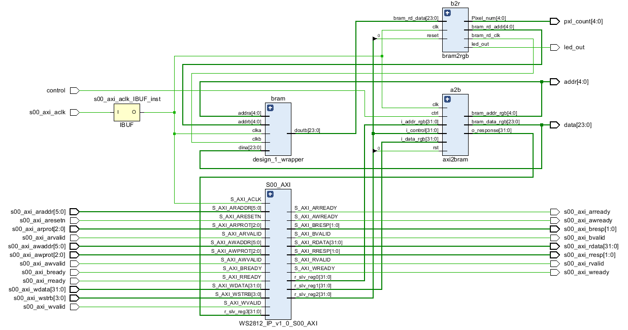

For my Path to Programmable project, I wanted to build something that would use both the PS & PL of the Zynq-7000.
The original plan was to build a logic analyzer that used BRAM & DRAM as a sample buffer, but I realized that I might not get it to work before the deadline.
In search of something simple, I decided to build a WS2812 controller.

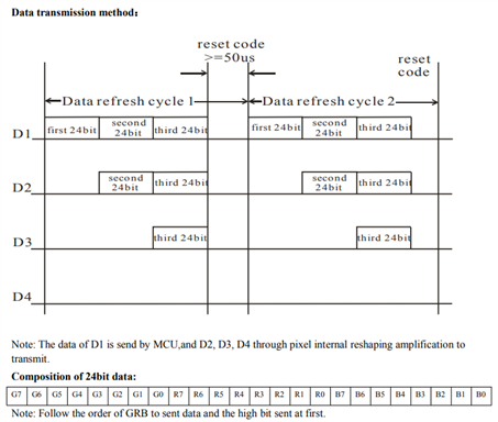

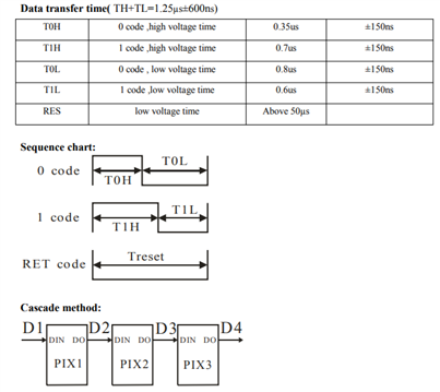

The WS2812 RGB LED uses a single wire serial protocol that infers '1's and '0's by varying the width of a pulse. WS2812s can be driven from a microcontroller, but most implementations that do not use DMA take up a lot of CPU time because even if a single LED in the string needs to be updated, the entire strip needs to be refreshed - so unless the data is stored in a buffer, data for the entire strip needs to be generated.

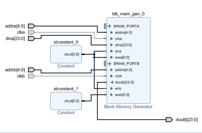

My project moves the serial output generation & refresh to the PL. The idea is that software in the PL simply writes 'data' to an 'address' in the BRAM (which corresponds to the RGB data of a LED of a given index), and the logic in the PL independently iterates through all the data in the BRAM using the other port, refreshing the LEDs.

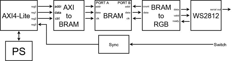

As shown, the main parts are the application that runs in the PS, the AXI4-Lite interface, a custom AXI to BRAM interface, dual port BRAM, a custom BRAM to RGB interface and a RGB to WS2812 generator. I could have used memory mapped BRAM using the Xilinx AXI-BRAM IP, but decided to build a custom interface that uses registers.
I used Markus Koch's WS2812b VHDL controller - which only needs to be supplied with RGB data and handles the pulse generation for the serial output.
I also wired up the PL switch on the MiniZed to an AXI4-Lite register, which allows software in the PS to read the state of the switch.
The AXI to BRAM interface is currently very simple: it simply uses the address and data from the AXI4 registers to write to the BRAM. I plan on modifying this so that I can set bits in the control register to control all these operations much better.

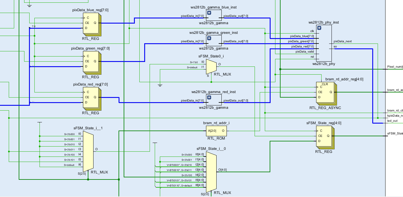

The code for BRAM to RGB interface is more complex and uses FSM to control everything. It goes through a couple of states which involve fetching data from the BRAM, sending it to the WS2812 PHY, waiting for the PHY to signal that it's ready for the next set of data and then incrementing the address or sending the longer 'latch' pulse depending on whether the all the LEDs in the string have been refreshed.
rgb_phy: process (clk)
    begin
        if reset = '1' then
            bram_rd_addr <= (others=> '0');
            --bram_rd_data <= (others=> '0');
        elsif rising_edge(clk) then
            CASE State IS
                        when S_GET_BRAM =>
                            bram_rd_addr <=  LED_Addr_Count; -- send an address to the BRAM
                            State <= S_SEND_TO_PHY1;
                        when S_SEND_TO_PHY1 =>
                            pixData_red <=  bram_rd_data (23 downto 16); --map the data from the BRAM to the WS2812 Controller inputs
                            pixData_green <=  bram_rd_data (15 downto 8);
                            pixData_blue <=  bram_rd_data (7 downto 0);
                            State <= S_SEND_TO_PHY2;
                        when S_SEND_TO_PHY2 =>
                            pixData_valid <= '1'; -- latch the data (this is required by the WS2812 controller
                            State <= S_WAIT_PHY_ACK;
                        WHEN S_WAIT_PHY_ACK =>
                            if (pixData_next = '1') then --wait for the WS2812 PHY to assert its ready signal before sending more data
                                State <= S_NEXT_DAT;
                            end if;
                        WHEN S_NEXT_DAT=>
                            if (LED_Addr_Count = "11111") then --if all the LEDs have been refreshed (32 total)
                                pixData_valid <= '0';          --de-assert the 'valid' signal (as required by the WS2812 PHY)
                                LED_Addr_Count <= "00000";     --reset the counter
                                State <= S_LATCH_LED;          --move to the state that sends a long pulse to latch the LEDs
                            else
                                LED_Addr_Count <= LED_Addr_Count + '1'; --else, increment the LED address count
                                State <= S_GET_BRAM;
                            end if;
                        WHEN S_LATCH_LED =>
                            pixData_valid <= '0';           --to latch the LEDs, de-assert the valid control signal
                            if (pixData_next = '1') then    --wait for the PHY to respond
                            end if;
                        WHEN others =>
                            sFSM_State <= "00110";
                    END CASE;
        end if;
    end process;
{gallery} WS2812 Controller IP
BRAM configuration
IP Schematic
WS2812 Controller

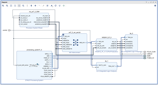

The WS2812 controller (PHY, BRAM and AXI controllers) were packaged as IP, and imported into the main block design.
