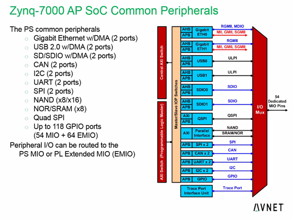

This video was mainly dedicated to explaining how the Zynq-7000's peripherals are organised, connected and how they need to be utilized.

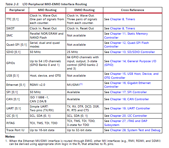

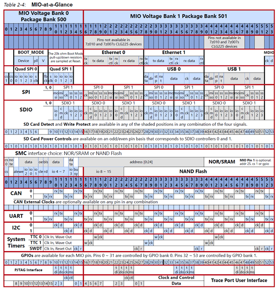

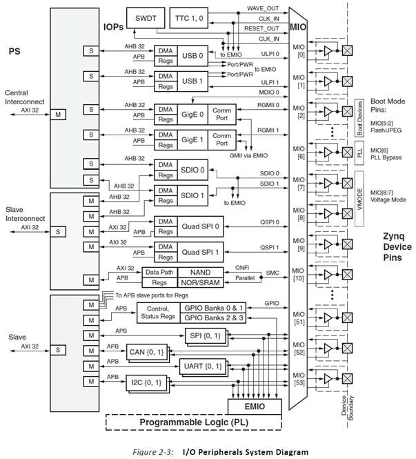

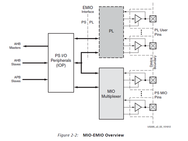

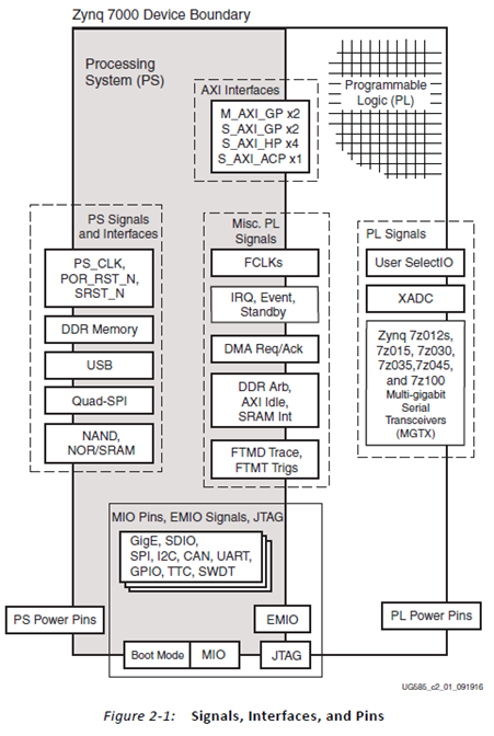

The PS has a couple of interfaces implemented as hard IP (like a microcontroller). These interfaces aren't brought out directly because they are internally muxed, as shown in these diagrams taken from the Zynq-7000 TRM.
In short, some go thorough the 'MIO Multipexer' to connect directly to the PS I/O pins, while some have the ability to be routed to the PL (and PL I/O) via the 'EMIO' interface.
Here's where it gets a little more complex:
  • Some interfaces are solely available through the (direct) MIO interface i.e. they can't be routed to the PL I/O via the EMIO due to constraints like timing eg: USB.
  • Routing of pins needs to be done in groups eg: if SPI0 CLK is shifted, the remaining SPI0 pins also need to be shifted.
  • An interface cannot be split between MIO & EMIO, but unused pins can be left disconnected.
image           imageimageimage
USB, QSPI and  the Flash cannot be routed to the EMIO, so naturally when assigning pins with the pinmux tool in Vivado, prioritize these interfaces by assigning them to the MIO first.
In most cases, when a peripheral is routed to the EMIO, everything will remain the same with a few exceptions eg. the MIO Ethernet  interface uses a 4-bit interface @ 250Mhz, but when routed to the EMIO it uses a 8-bit interface at 125Mhz.
The 7z007s (MiniZed) in the CLG225 packages supports only 32 MIO pins, but all other Zynq-7000 parts include 54 MIO pins. This restriction means that either USB MIO or Ethernet MIO is supported, SD card, NOR/SRAM are not supported and NAND Flash width is limited to 8 bits.

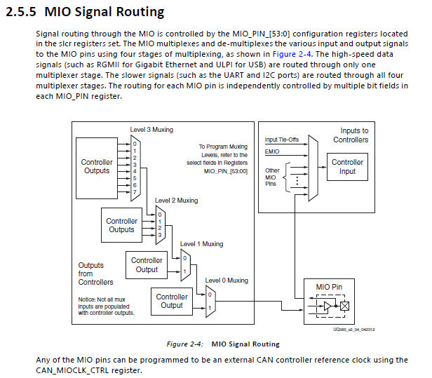

UG-585 (The Zynq-7000 Technical Reference Manual) has more details like how the signals are routed through the multiplexer (high speed signals go through only one stage), the logic levels and electrical parameters.

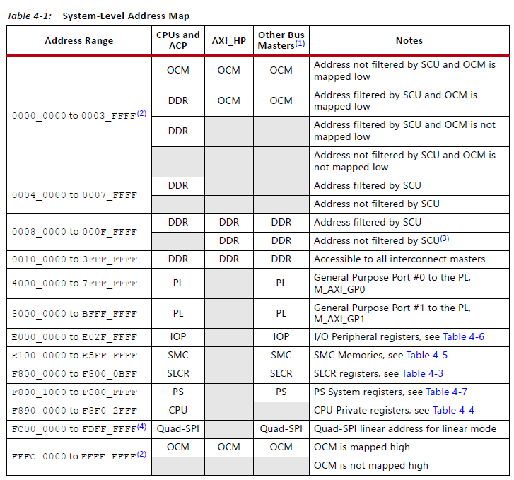

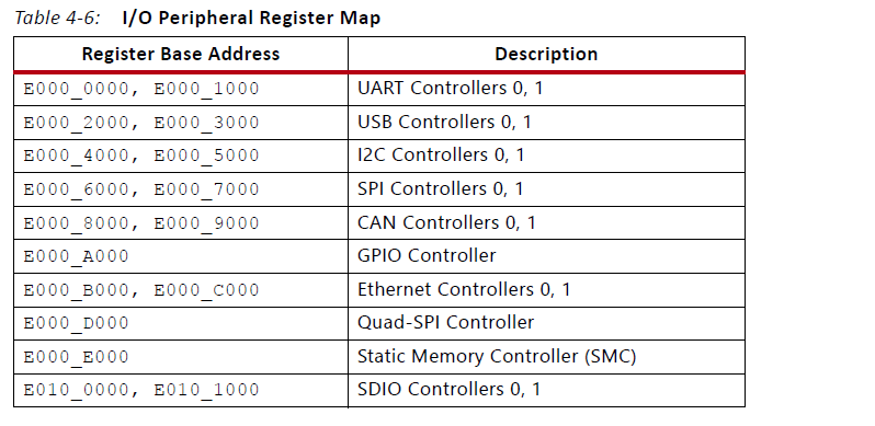

The next couple of slides were about the Zynq Address Map: where the SCU, DDR, MIO, General Purpose AXI ports, System Registers, Memory Controllers etc lie.
The address of most of these are fixed, with the exception of PL based peripherals which are automatically assigned by Vivado (although they can be modified)

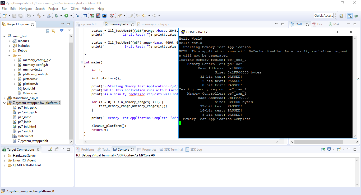

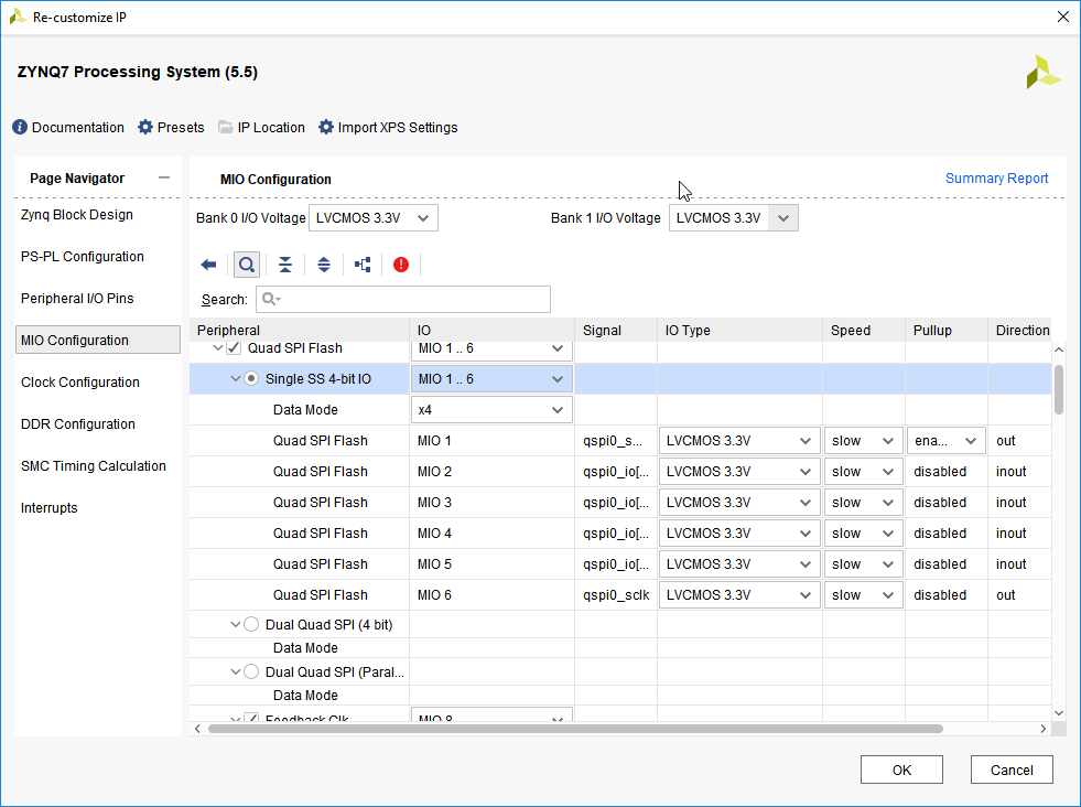

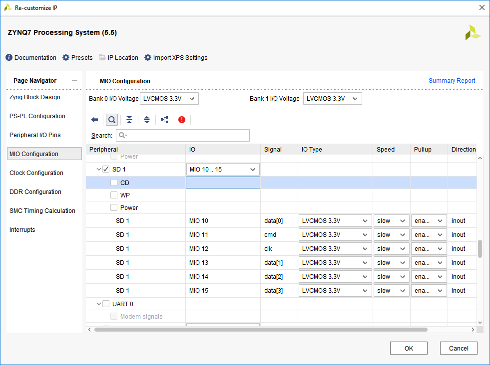

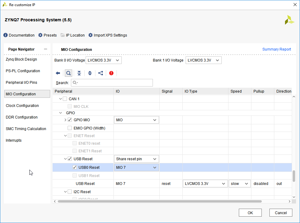

Lab 3 - PS Configuration Part 2 - MIO Peripherals
This lab involved configuring the peripherals that were previously discussed.
{gallery} Peripheral Configuration
Quad SPI
USB Reset
SD
Clock Configuration

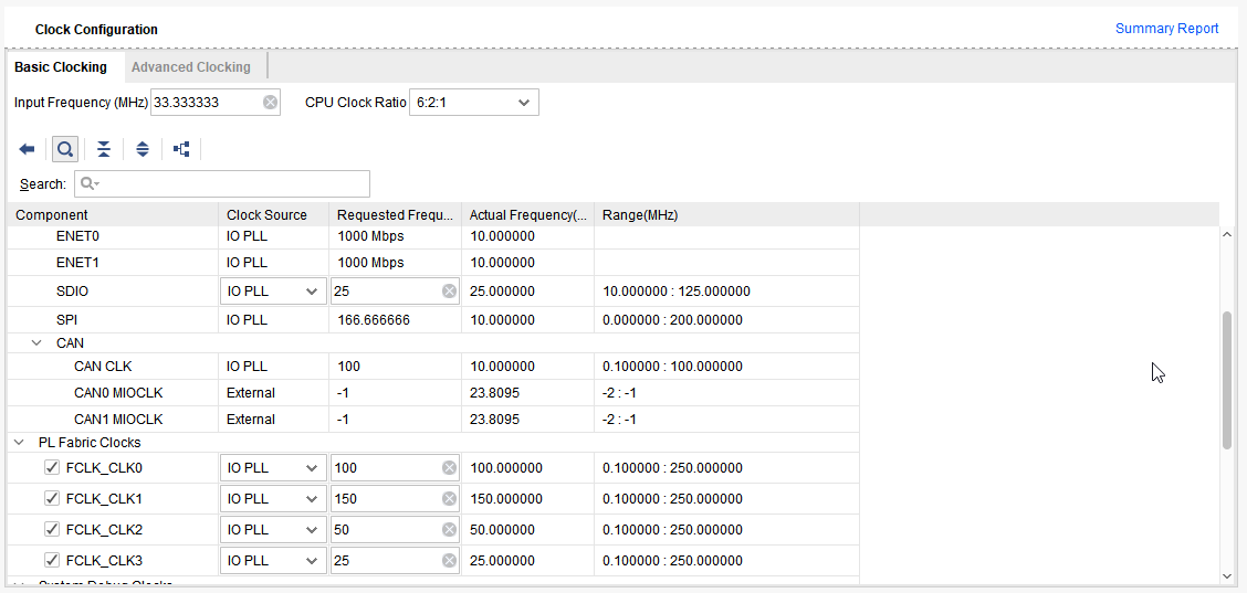

After the MIO was configured, the clocks & PLLs were set. Since the block design was updated, the HDL wrapper needs to be regenerated. Just to make sure that nothing is left over from the previous wrapper, we 'Reset Output Products' - when similar to 'cleaning' a compiled project.
Next, the bitstream was generated as usual, but the minor recommended change was to explicitly set the location for the exported hardware & SDK workspace to prevent any issues from cropping up (instead of using the default location)
In Xilinx SDK, create a BSP as usual followed by a new application. This time in addition to the 'Hello World' template, also create and run 'Memory Tester' & 'Peripheral Test' templates.

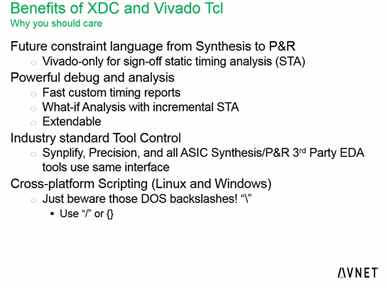

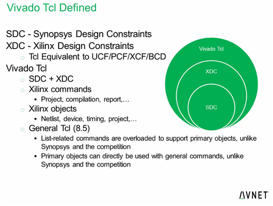

The Chapter 5 video was about TCL, which is a scripting language that is commonly used by EDA software. TCL is an interpreted language and can be used to automate tasks - performing any action in the Vivado GUI echoes the corresponding TCL command in the console.
As per the video, Vivado TCL combines SDC (Synopsys Design Constaints) and XDC (Xilinx Design Constraints) and is very well suited for scripting tasks, automatic timing analysis, generating reports etc.
Most importantly, everything created in a Block Design can be recreated using a TCL script - which makes it very useful for sharing configurations, making & restoring backups etc. since you don't need to use the GUI.
The last couple of slides were about the files that Vivado automatically generates: PS7_Init (C, TCL & HTML files which describe processor specifications - DDR config, clocks etc) & a .BD (block design).

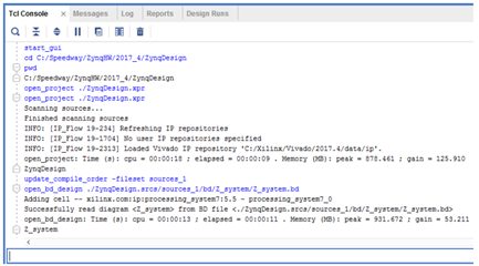

First, directory navigation: use the 'cd' command to navigate to the folder containing your project (remember to use forward slashes!)
'pwd' returns the present working directory & use can use 'dir' to list files.
cd C:/Speedway/ZynqHW/2017_4/ZynqDesign
pwd
dir
Open your project
open_project ./ZynqDesign.xpr
Open the block diagram in the project
open_bd_design ./ZynqDesign.srcs/sources_1/bd/Z_system/Z_system.bd
