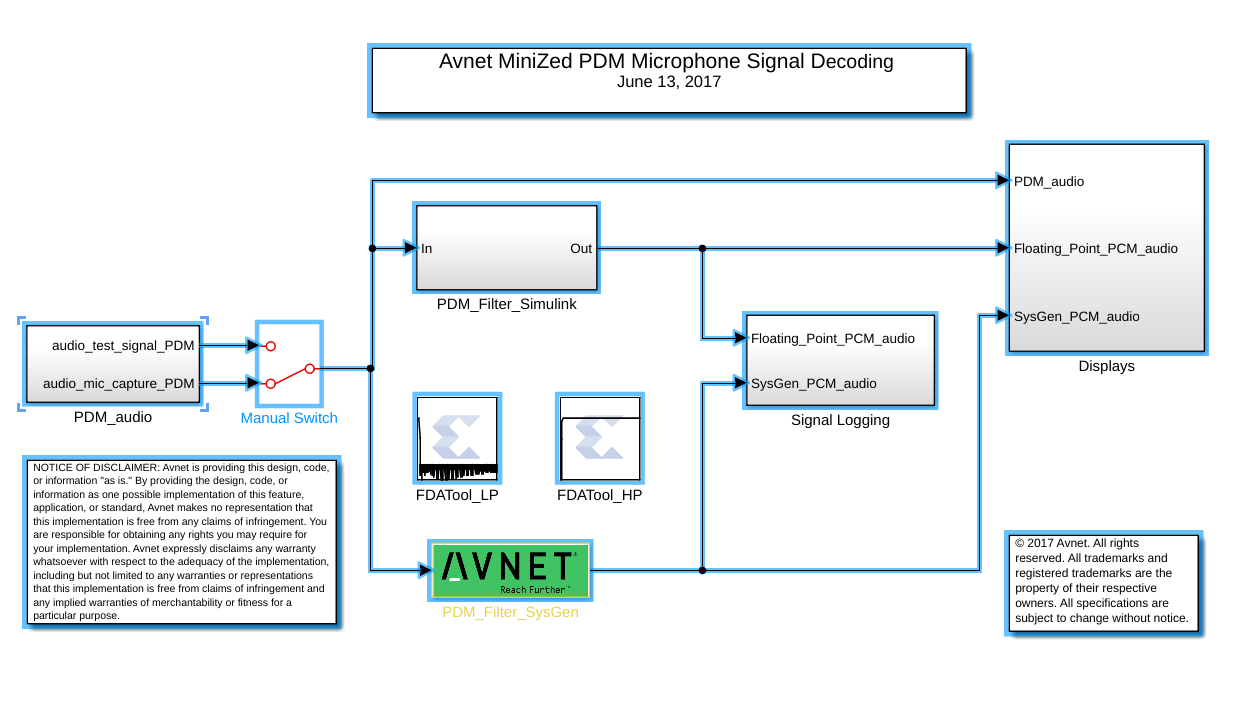

The Microphone Sub System
The microphones included on the minized board are surface mount ST MP45DT02MP45DT02 MEMS (Micro-Electro-Mechanical Systems) connected directly to Zync - 7000 AP SoC on the MiniZed board. It can take the PDM (pulse density modulation) from the microphone and convert it to 16 bit PCM (pulse code modulation) in two's complement format at a decimated sampling rate suitable for audio. Ok, I quit. That sounds too hard already. Just kidding, I found an example project that would help me.

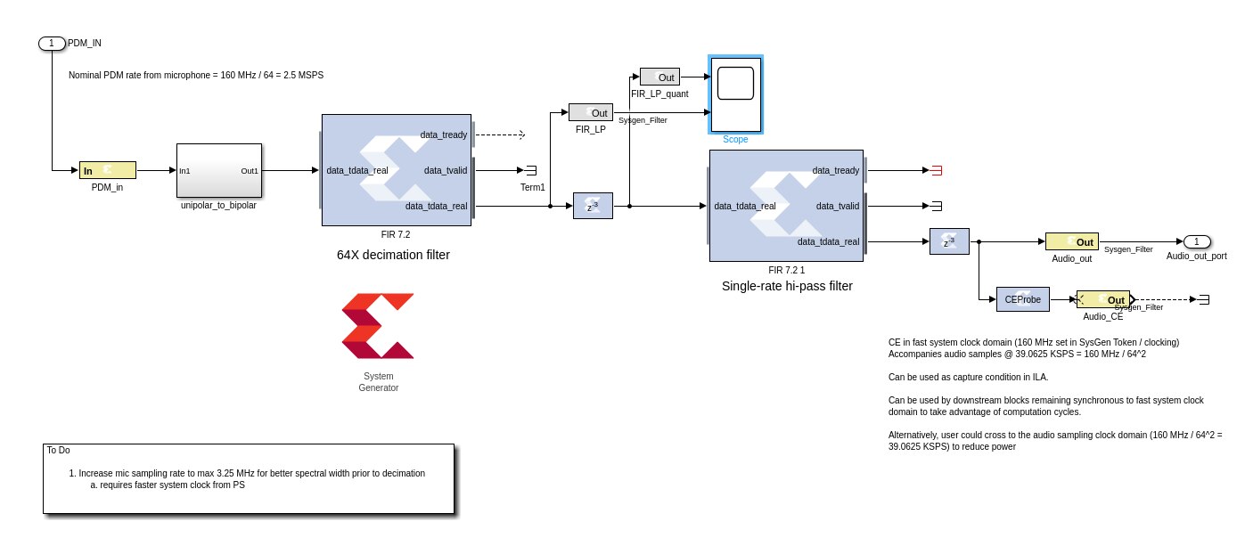

I happen to have a version of MATLAB, which was necessary to conduct this experiment. That, along with System Generator utility of the Vivado design suite allow you to model circuits in MATLAB, using Xilinx IP blocks, and then export that design out to Vivado to program the FPGA.
You can see this is an Avnet design. I just borrowed it. Diving deeper into the Green Box we find
the Low Pass 64x Decimation Filter, the output of which goes to a scope, and to a High Pass Filter, the output of that goes to CEProbe, which can be used in the Vivado Software to trigger data capture. Remember that, it's important later.

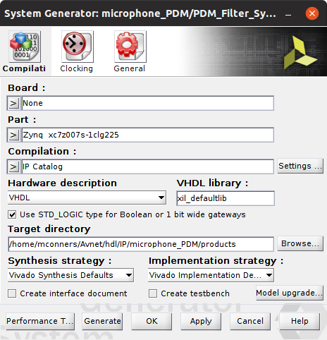

Now that we have created the design using MATLAB, we can click on the System Generator block (the Red Xilinx logo above)
Notice the board is not selected, but the Chipset we have is in the Part: box is. That is the part number for the Zync Chip on the minized. Now this is where my plan started to fall apart. I didn't realize it at the time, but when I selected generate above, it seemed to run without errors. I checked the target directory specified, and there were output files, so I thought I was good to go. So I proceeded, I wanted to get through this lab as is, then come back and modify it to add the FFT IP. Somewhere between this step and coming back to add the FFT IP, I had to upgrade my version of linux, and subsequently my version of MATLAB. When I tried to regenerate the IP using sysgen, I was given an error that I did not have the appropriate license for XIling to use the System Generator, and my research showed the cost was ~$1000. So, subsequently, my project ended up being this experiment, but I don't mind, I tried, and I failed. That's part of being a scientist. At any rate I will continue to document the rest of this experiment.

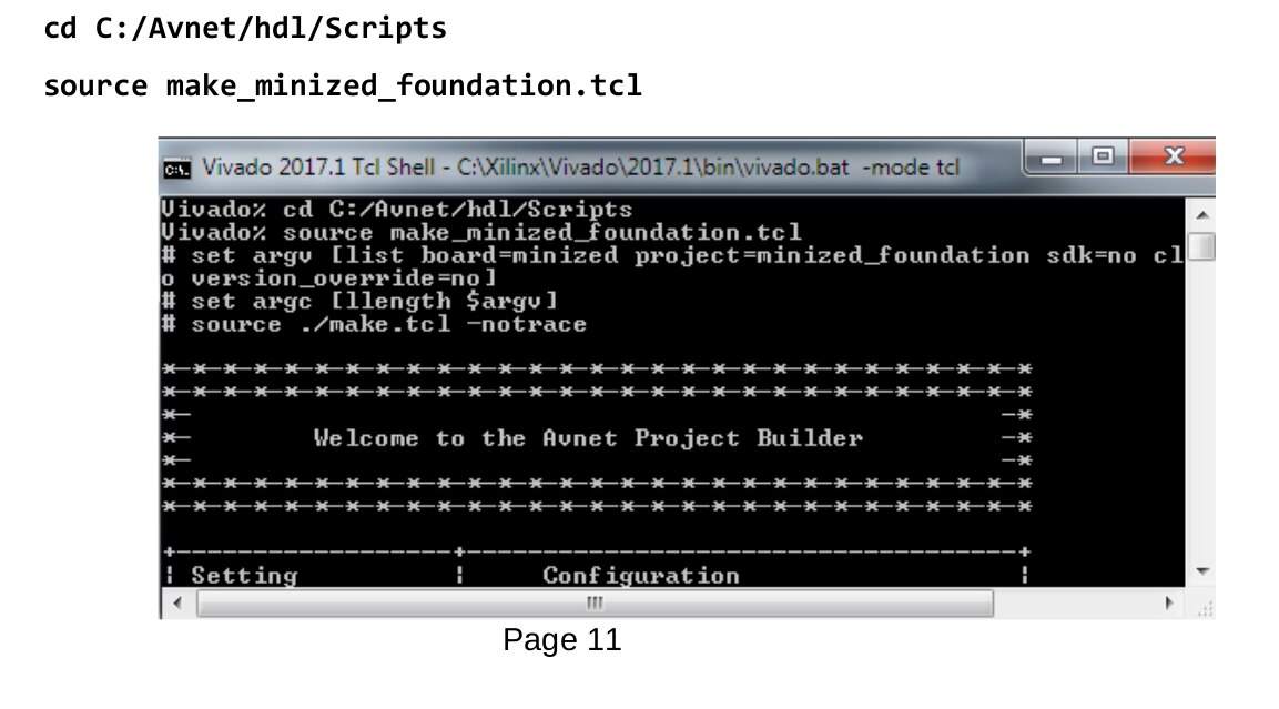

Applying what I learned in the course materials:
The next part of this would have had me completely lost had it not been for going through the exercises provided in the course work. They had us navigate to  a scripts directory that had been downloaded with the rest of the project and DO WHAT!? Execute the TCL Shell. TCL me with a feather:

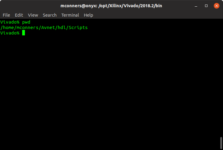

My directory was a little different cause I'm on a linux system
Now this was where I was glad I went through the course. The very first thing I got was a TCL error that I was using the wrong version of Vivado. So I updated the version number and tried again. I was not afraid to get in there and start making changes. Then it complained about the Board Definition File not being included, so I had to find that, which I found by googling around. There were other errors here and there, but I got through them all, which would not have possible without the training.
The process took about 20 Minutes to complete once I had clear up all the errors.

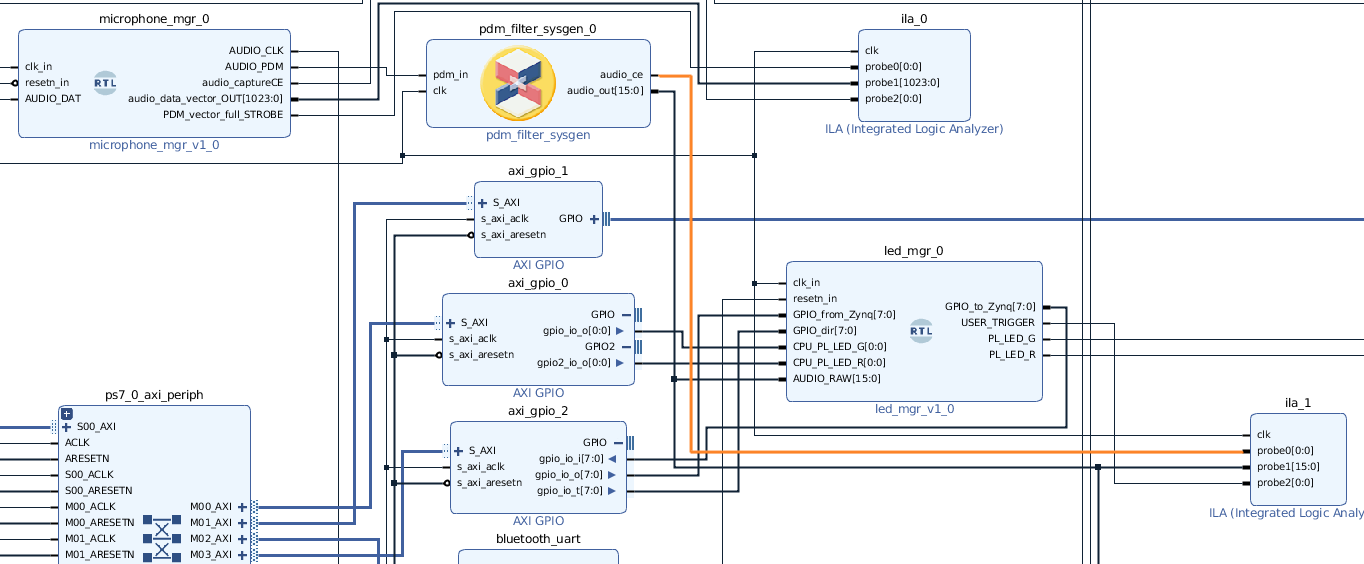

I was directed to open the Block Diagram, which we always did in the training, but WOW, they had populated almost everything you could. I'm still not sure if it was the Board Definition File I found, or if it was just the scripts said, "Hey let's configure every part we can find on this thing", something to research. I think it's a combination of both. Anyways here is the stuff that is important:
The 4 pertinent blocks are microphone_mgr_0,
pdm_filter_sysgen_0, that's the stuff we made (or I thought I made) in MATLAB,
ila_0, logic analyzer, we played with that in the labs
ila_1, another logic analyzer
Hey, notice that orange line, I highlighted it for you, that's the CEProbe line I said we could use to trigger data capture. I told you not to forget.

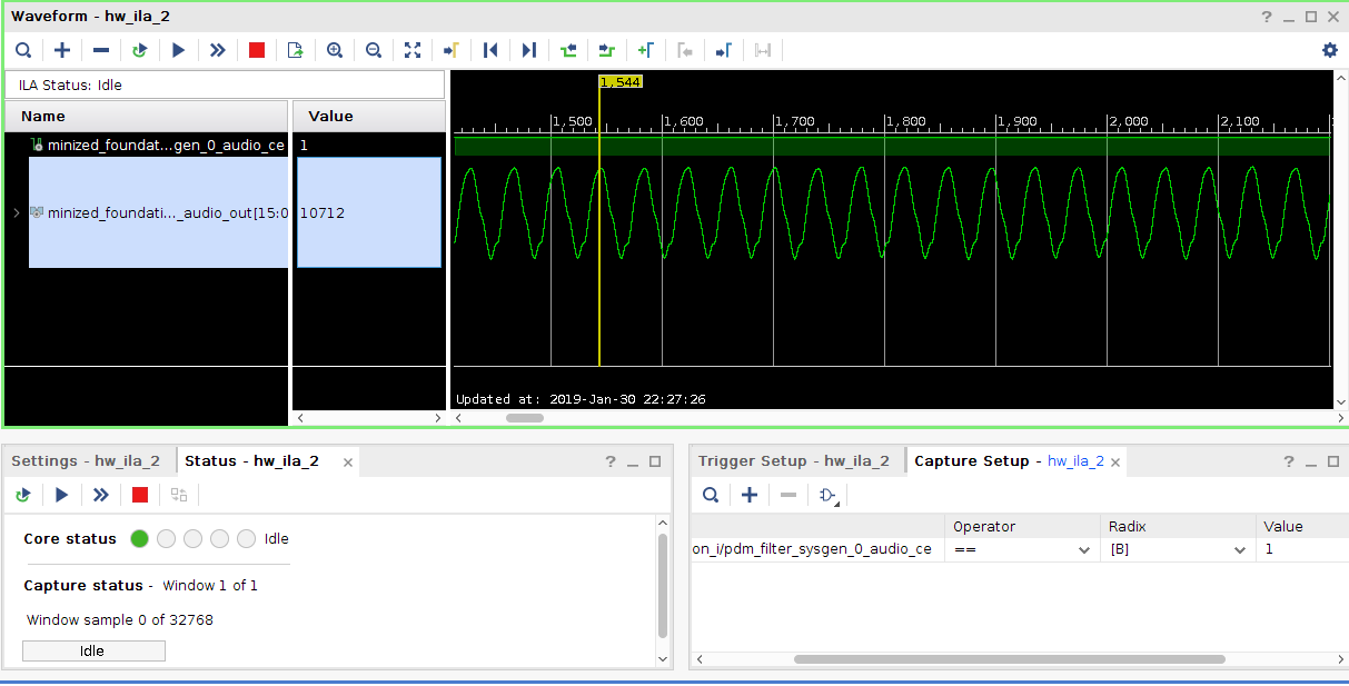

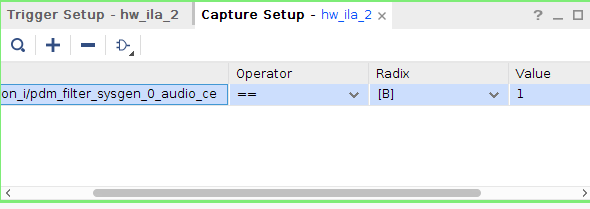

Ok, so they had me set the trigger minized_foundation_i/pdm_filter_sysgen_0_audio_ce == 1

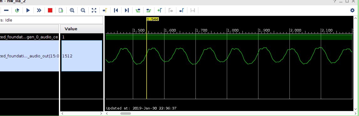

Directed me to place a sound source near the board, I used a tone generator i downloaded for my phone, set the tone to 1khz, started the capture,
As you can see it captured somewhat of a tone. I didn't check it with an oscope or anything, but it seems reasonable to be about 1Khz.

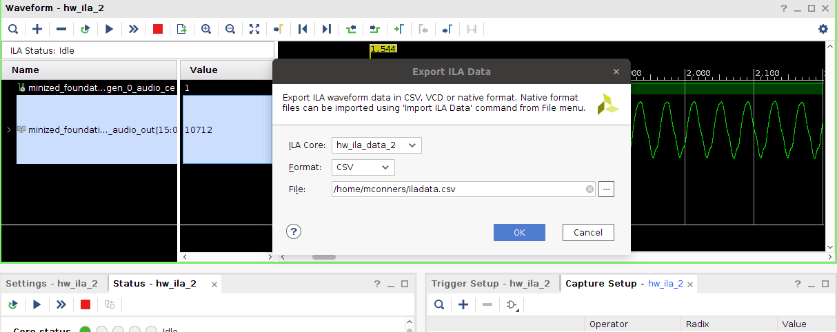

They then give me the option of exporting the data to a CSV file

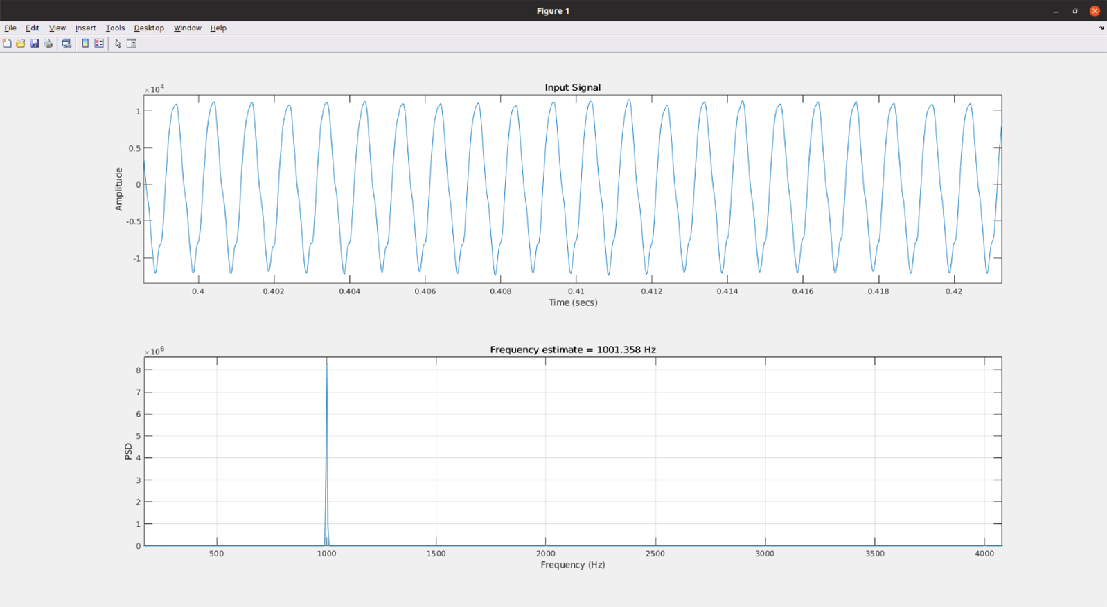

Now that I've got a csv file, I can open MATLAB again and analyze the signal
You can see the tone is centered around the 1Khz mark, and the estimated frequency is 1001.358 hz

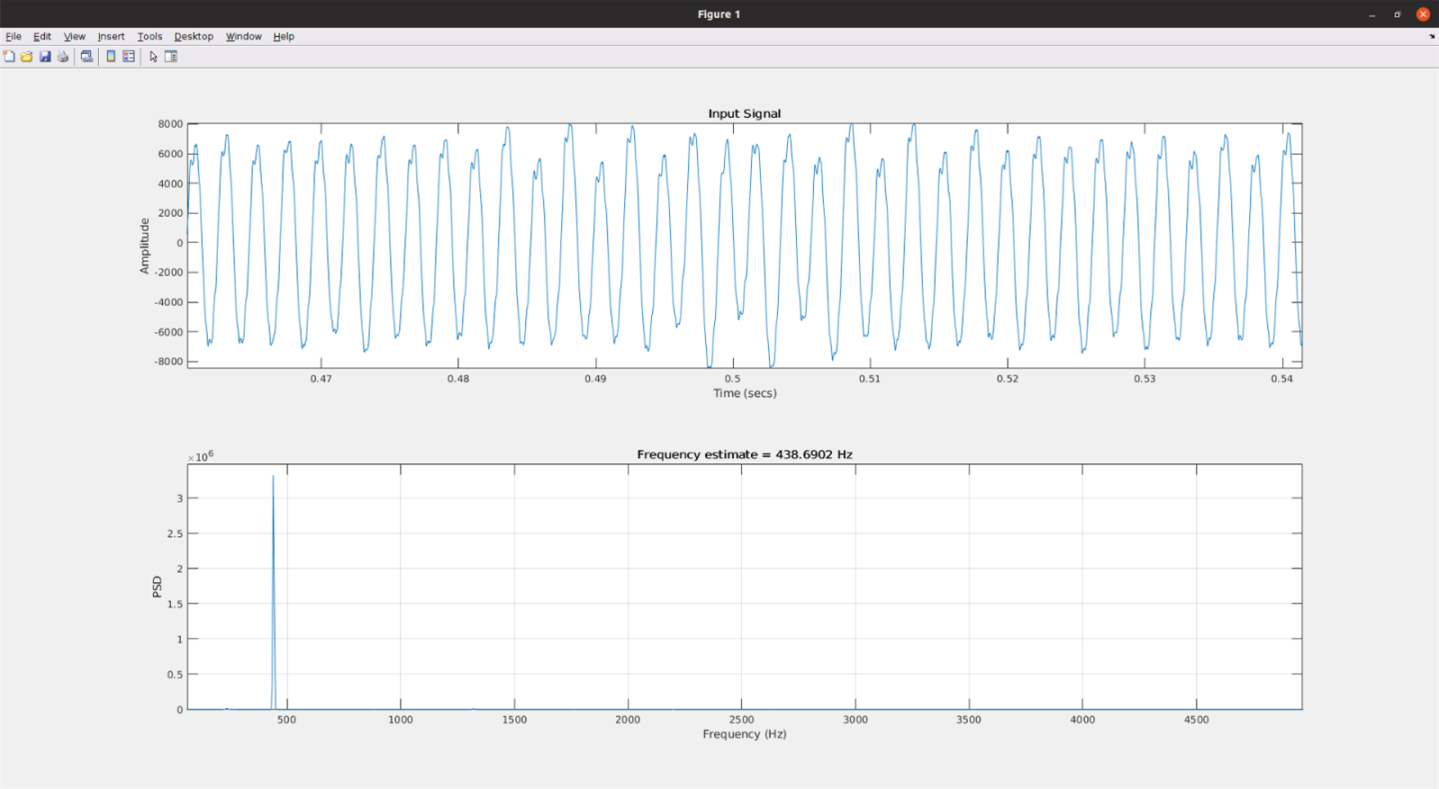

Just for fun, I'll repeat the capture with a 440hz signal
And again with the MATLAB
So I'd say that's a pretty reasonable capture and estimate.

    As I mentioned above I had thought I had seen system generator work earlier on, so I may have had a temp license that expired. During the course of this experiment, I had taken a chrome update, and suddenly chrome started crashing unexpectedly, I figured it would get fixed so I didn't roll back, but after about a month, and googling around and finding no one else experiencing the same issues, I updated ubuntu, and the chrome problem was fixed, but then MATLAB and sysgen didn't work right anymore. So I had to get the latest version of MATLAB, so maybe I lost something during that whole ordeal. But I also noticed that with the new version of sysgen/MATLAB I got a popup dialog with Errors that I didn't get in the earlier version of the combo, so maybe I was getting errors all along, they just weren't clear, and I was just using the version of the output files that were distributed.
    The error I got in sysgen was:
    Sysgen license checkout failed.
    XILINXD_LICENSE_FILE = /opt/Xilinx/Vivado/2018.2/data/sysgen/hwcosim_compiler/p
    p_ethernet
    So it wouldn't write the output file.
    And when I started looking for that license, it seemed like it was ~$1000.
    But, as I say, I haven't given up, I may find a way around it, either way, without the training I wouldn't know what I know now.
