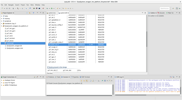

We will base on project from lab 5. We need to launch SDK. Then we need to check if in system.hdf there is present BRAM IP block.

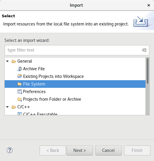

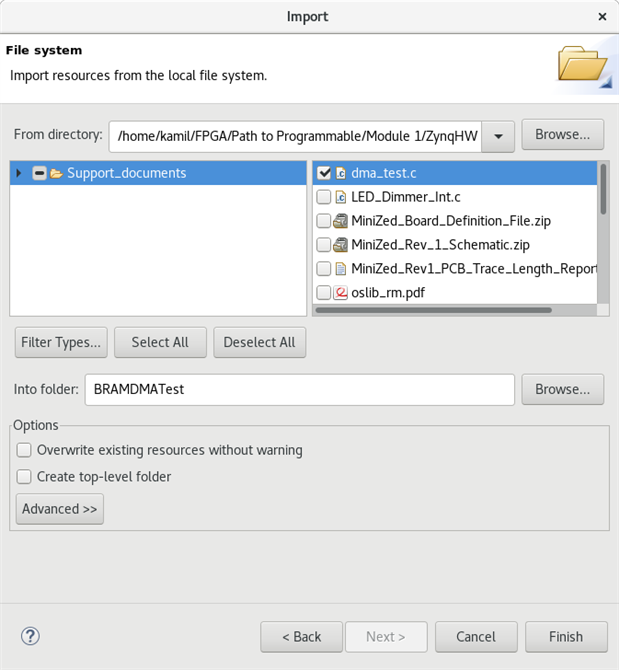

Now please create a new application project with empty application. Then we need to import test application called: dma_test.c provided in course materials.

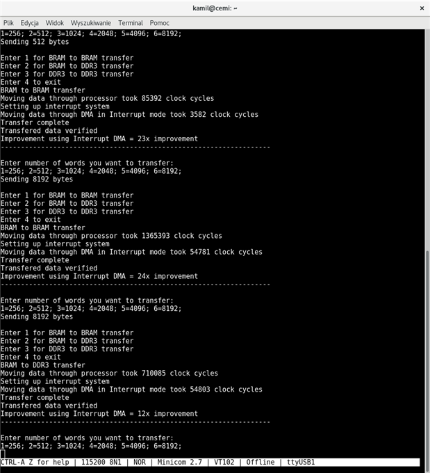

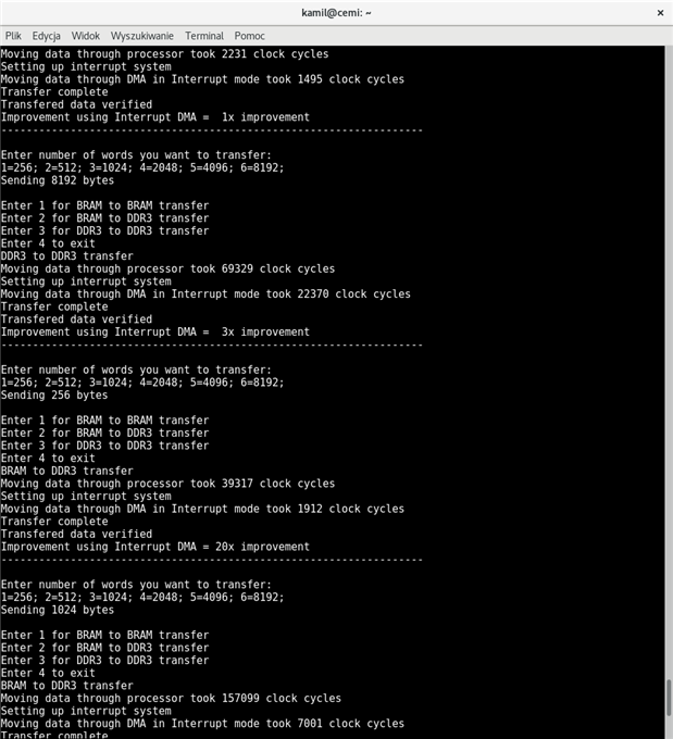

There is a simple application which allow to test improvements in data transfer with usage of DMA.  I do not why by during choosing option 1 BRAM to BRAM transfer the application hangs. It always stops in this method:  Xil_DataAbortHandler. I am using the Vivado in version 2018.2 but source file is for 2017.4, so maybe there are some differences in configuration ?
Update:
I found the reason of this issue. It was wrong Interconnect IP type. I choosed AXI SmartConnect instead of a AXI Interconnect. Here is output after correction:
