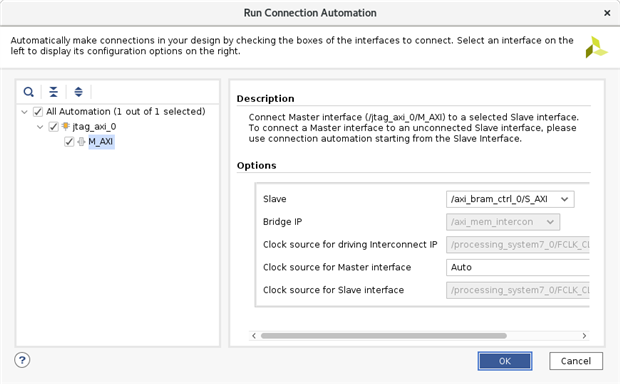

Please select Add IP and choose JTAG to AXI Master Core from IP catalog. After that please run connection automation.

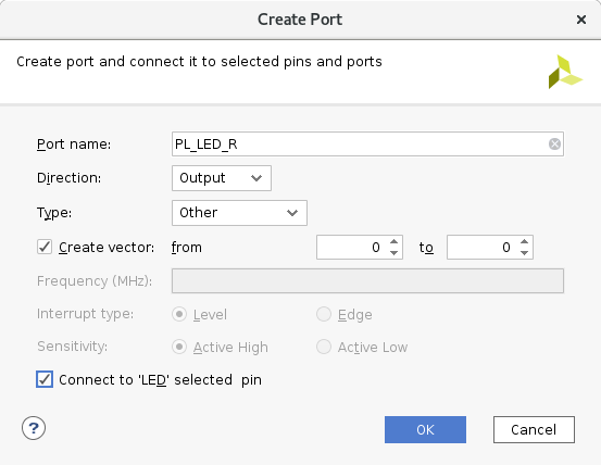

After that we could add a LED constraints to PWM_w_Int IP. Please right click on LED[0:0] pin located on the PWM_w_Int_v1.0 IP then select crate port.

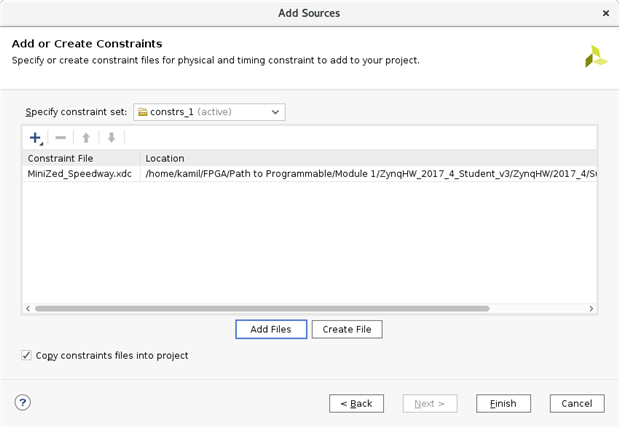

Now please select option Add Sources from Flow Navigator menu. Choose Add or create constraints and load constraints from Speedway support documents.

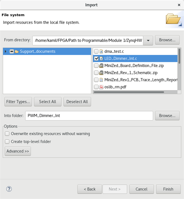

2. Import test application for LED control

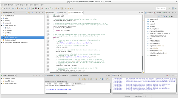

In SDK select File->New->Application Project, enter the name of application then choose empty application and press Finish. After that select import and from Speedway support documents choose LED_Dimmer_Int.c.

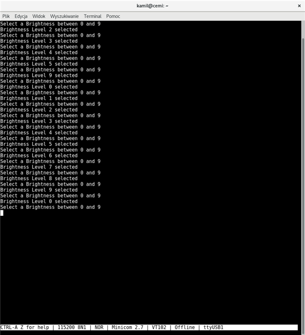

Now please Program the FPGA. After that please choose option Run -> Launch on Hardware(System Debugger) the LED_Dimmer_Int application. From command line application you will be able to change the Red PL Led brightness.

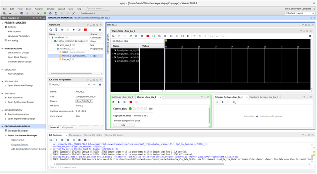

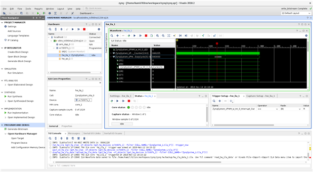

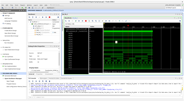

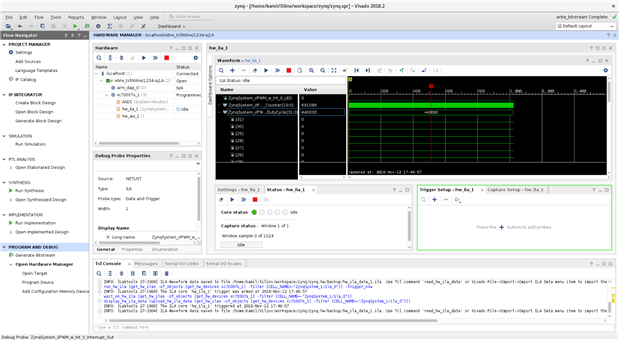

Please open hardware manager from Flow Navigator and select option Open target -> Auto Connect. After that please select the ILA core.
Now we could press: Run Trigger Immediate for this ILA Core button. You should see following waveform:

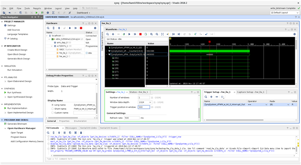

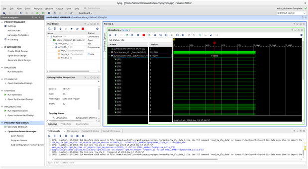

You could configure the radix of PWM_Counter and DutyCycle by choosing Unsigned Decimal option. Now when you type 4 on terminal and choose again Run Trigger Immediate you should get following waveform:
The DutyCycle ise set to 440000 because of the value 4 that was entered into the terminal. Software in the PS multiplies the entered number by 110000. The period parameter sets the counter depth of the PWM counter. The period default is 20, the counter counts to roughly 1 million. So any number over 1 million should create an exception interrupt. We will try to catch this exception by trigger in ILA.
Please go to the Trigger Setup window and select the Interrupt_out signal. Please select the value to R and the trigger position in window to 500. Now you could click Run Trigger.
Now you could type into the terminal few digits then letter. The trigger status should change from Full to idle.

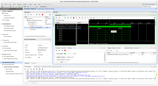

run_hw_axi [get_hw_axi_txns write_txn]
When you press Trigger Immediate in the waveform you should the brightness set to 660000.
