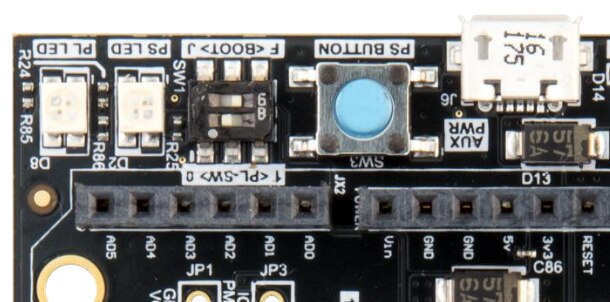

1. Configure the SoC PL with bitstream
At the beginning we need to configure a hardware and set proper boot mode. We need to enable JTAG boot. We need to enable JTAG boot. It could be done by setting dip switch to position J. Here is picture of this dip switch.

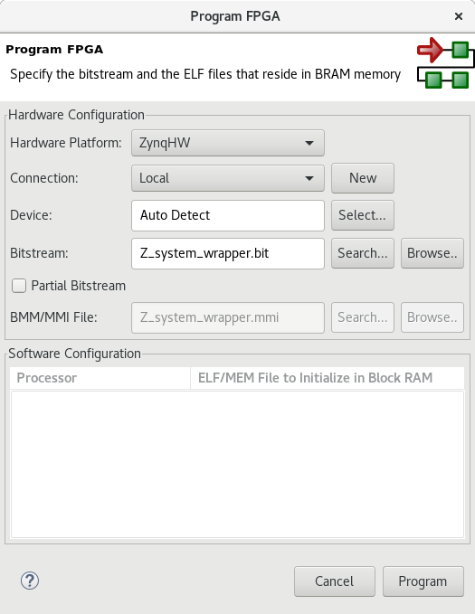

Now we could program FPGA by choosing following option: Xilinx Tools -> Program FPGA.
When it finish the blue LED (D3) on MiniZed should light up. In the SDK should be the message that FPGA was configured successfully.

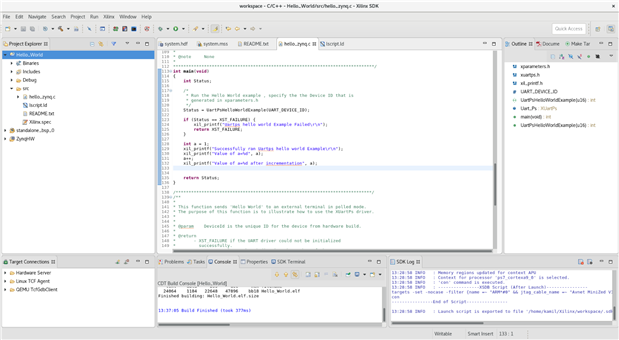

2. Running the application

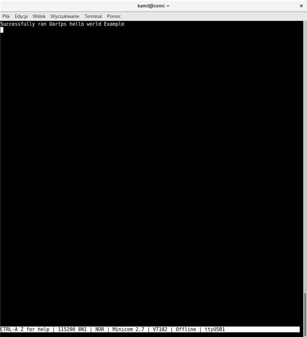

To run application please choose option Run As ->Launch on Hardware (System Debugger) from Project Explorer. After that SDK will download the Hello_World ELF to the on-chip RAM and begin executing the code.
You could see output in serial terminal:

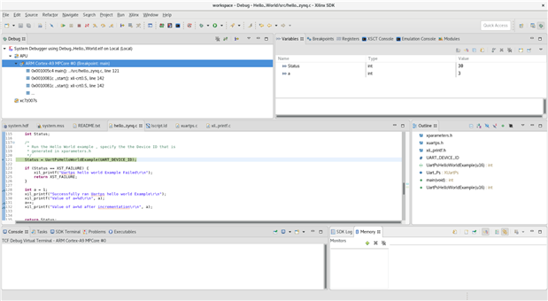

3. Debugging an application

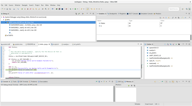

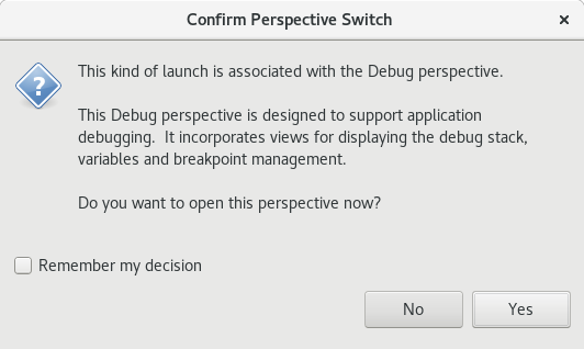

To run application please choose option Debug As ->Launch on Hardware (System Debugger) from Project Explorer. The code will be downloaded to the target memory. We will be switched to the Debug perspective.
In this perspective we have all debugging options like: Run Code or Step Run etc.

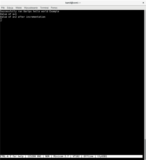

I have added to this example code a variable called a with its incrementation.
I have added a three breakpoint in lines 128, 131, 132. So, we could easily debug incrementation of variable.
On the top right screen we could see a current value of variables in scope. Here is output from serial console:
