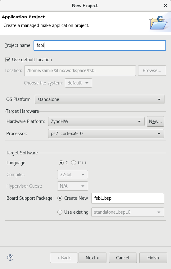

In SDK please choose Files -> New -> Application Project. Provide name and choose option to create a new BSP.

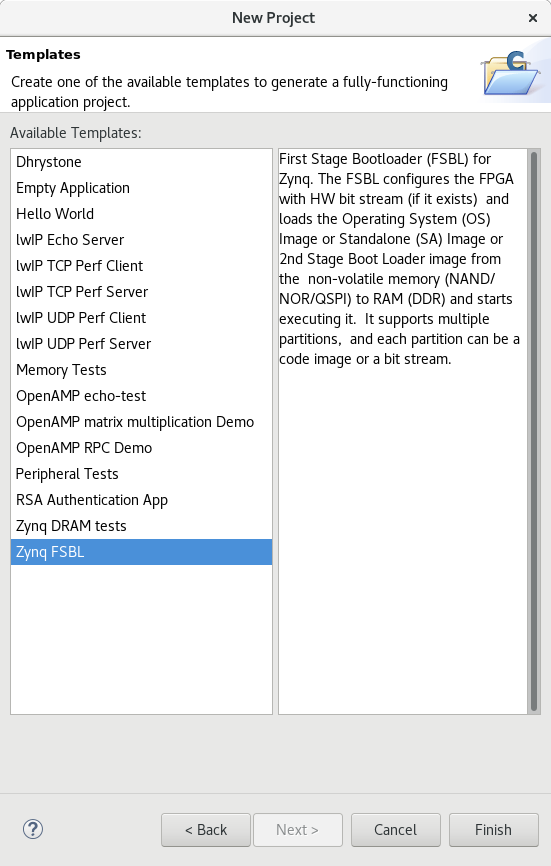

From templates please select a Zynq FSBL:

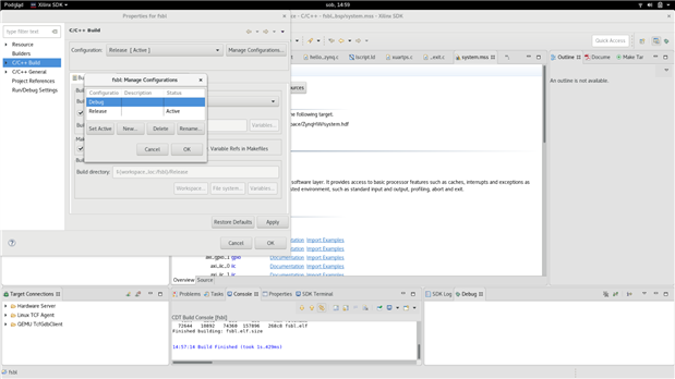

Then press Finish. In case of preparing FSBL for production we could choose Release configuration from project properties available from Manage Configuration options menu.
