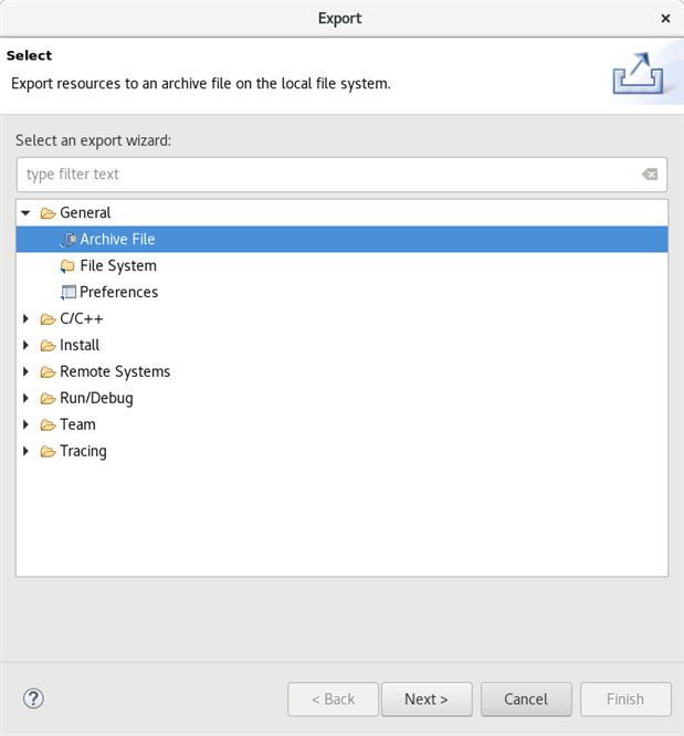

In SDK please choose option File -> Export. Select General -> Archive File and select Next.

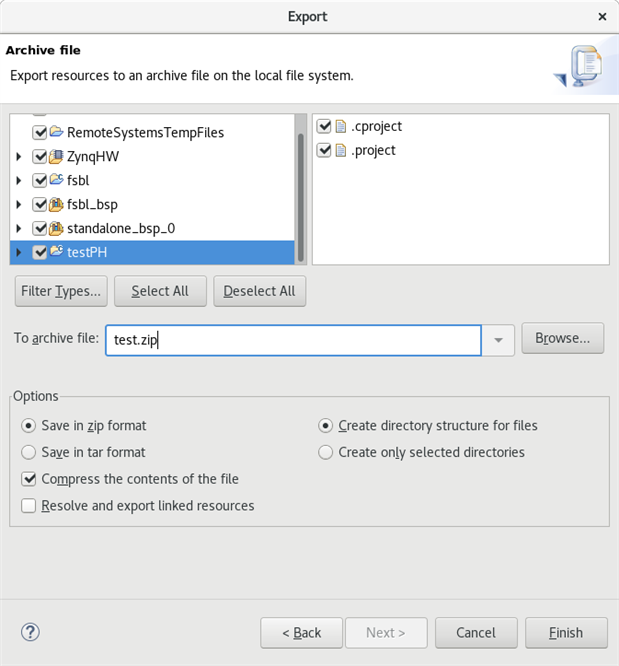

On next screen choose button Select All and enter name of archive. Then press Finish.

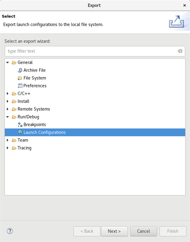

In the same way we could export information about Launch Configurations or Breakpoints.

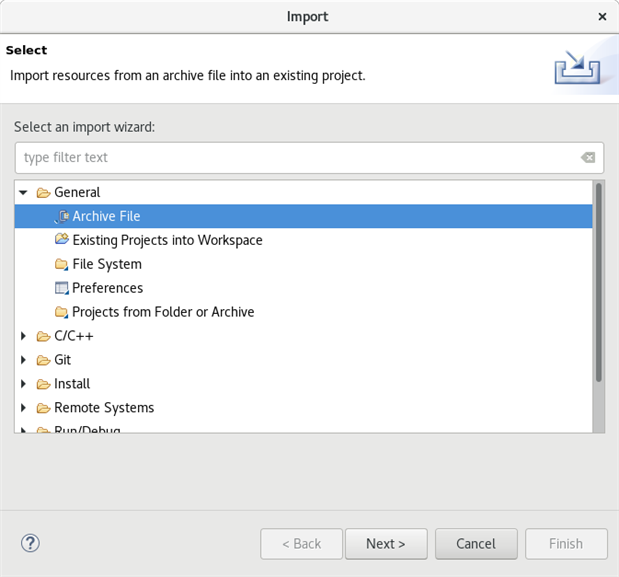

To import project please choose option: File -> Import. Select General -> Archive File:

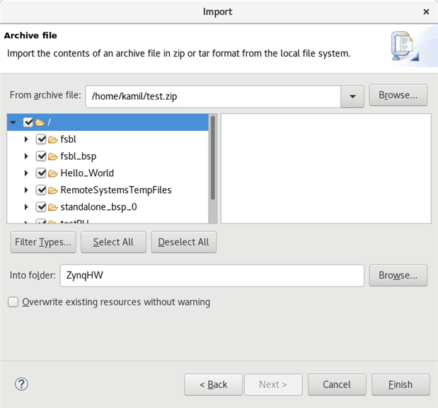

Then press Next and select file with archive:
