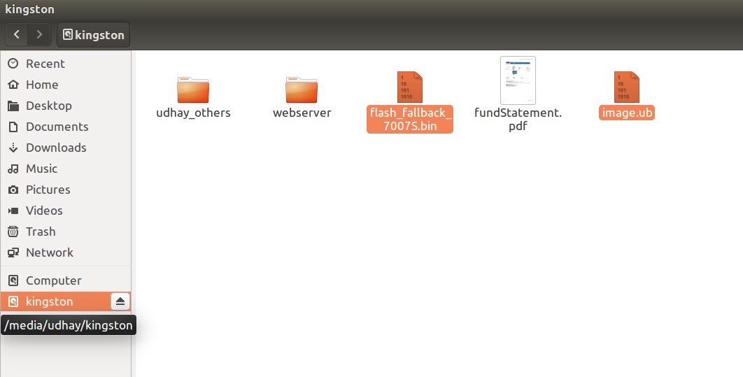

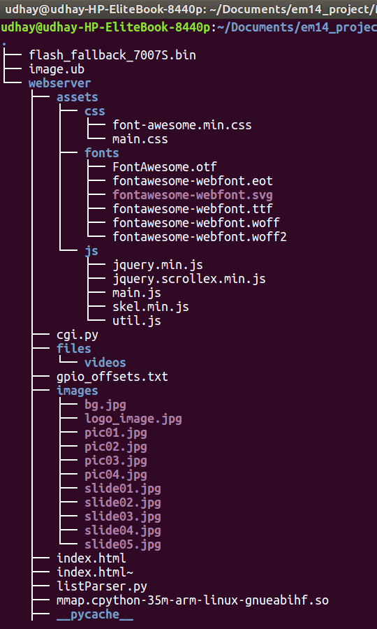

It Contains Directory Structure as shown below:
Step 1.) Loading the PetaLinux on Minized:
Here We Need to:
->Flash the QSPI with "flash_fallback_7007S.bin" file using SDK or XSCT (by Setting Boot Switch to "J" side - JTAG mode)
->Copy the "image.ub" onto the emmc
Just follow the Avnet Document for running "Python Web Server on MiniZed" attached here , if you like you can find that Project Application Here
Step 2.) Loading Website files & Videos to Host on our Minized Webserver :
-> Just Copy the Directory "webserver" onto your Pen Drive(You can also store other folder that don't cause any problem for us !)
-> Copy the Videos from PC into videos directory , its Path = "{Pen_Drive_Name}/webserver/files/videos/"
Note: Our Application Automatically Generates videos.html page only for Videos Copied into that above mentioned Directory only

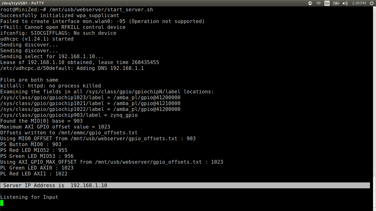

->then Run this Simple Line to Start the Bash Script which automates everything and Displays the IP address of the Website (Server)
/mnt/usb/webserver/start_server.sh
The Website IP adress is same as the IP adress of Minized , it is Displayed as shown Below:

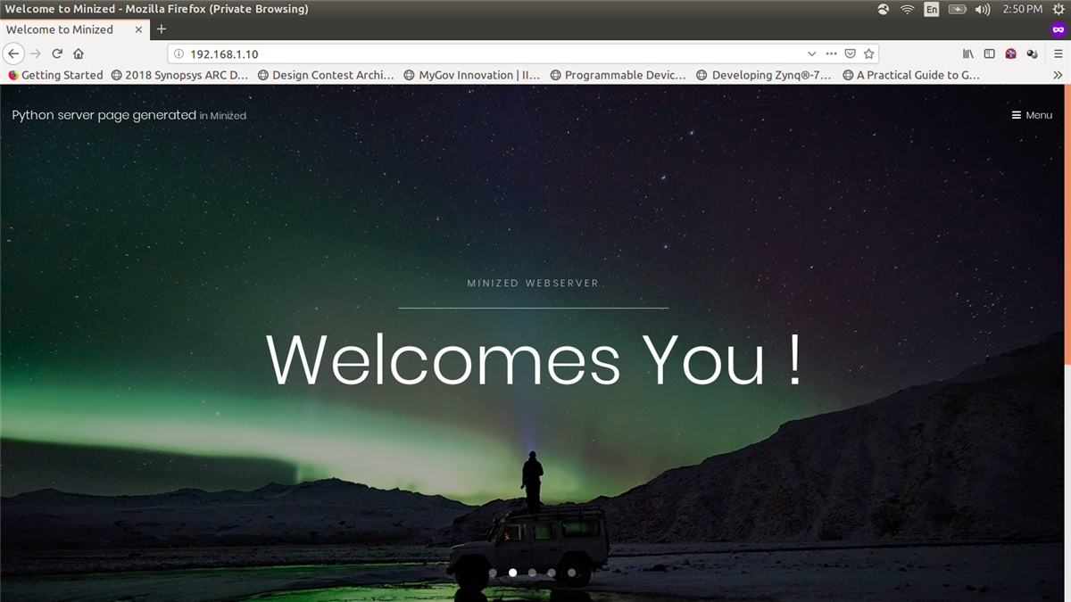

Just Open the Server IP address or Minized IP adress on Browser,It Should Look like this :

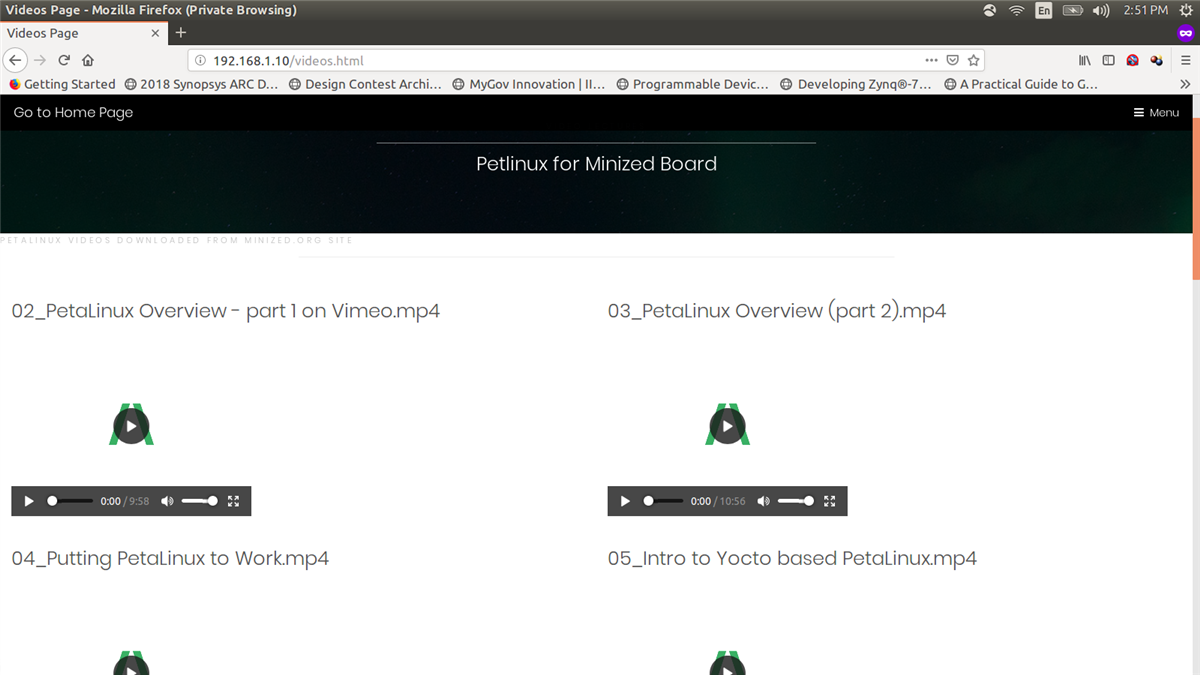

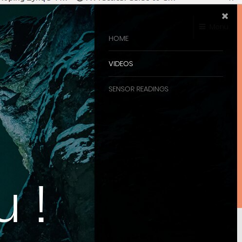

-> Press the Menu Page(Top Right Corner) and Navigae to Videos page where we can See our Hosted Videos:

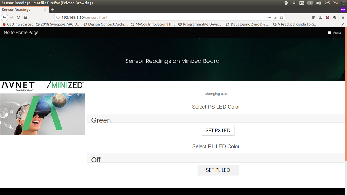

->Navigate to Sensors Page where we input our Server to Turn ON/OFF Leds:
