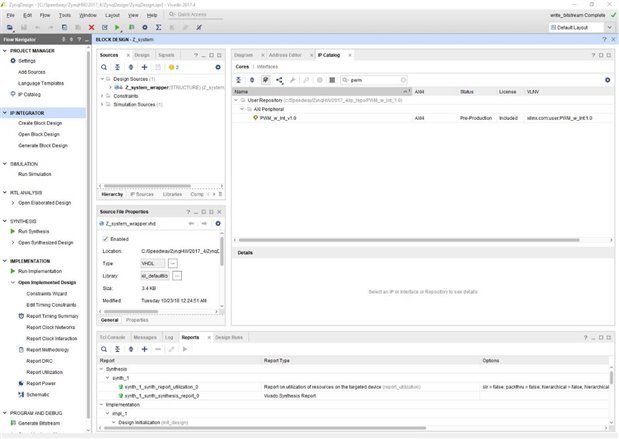

The ip is added to the IP catalog here and can be searched in the window.

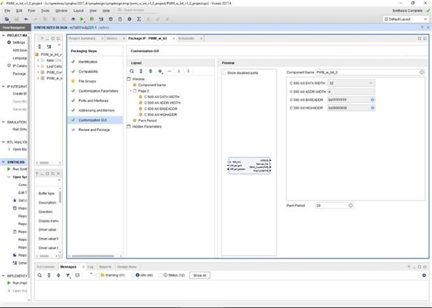

Customize the IP and add it to Vivado
After creating the ip core it can be packaged in the flow navigator and the compatibility of the ip can be set to multiple fpgas such as zynq and artix. And also the life cycle of the ip can be chosen as to be in pre-production or beta. Customization Parameters should also be set in the customization GUI. After the ip core is done it should be reviewed and packaged using the Re-package IP button. This will create the new ip core.

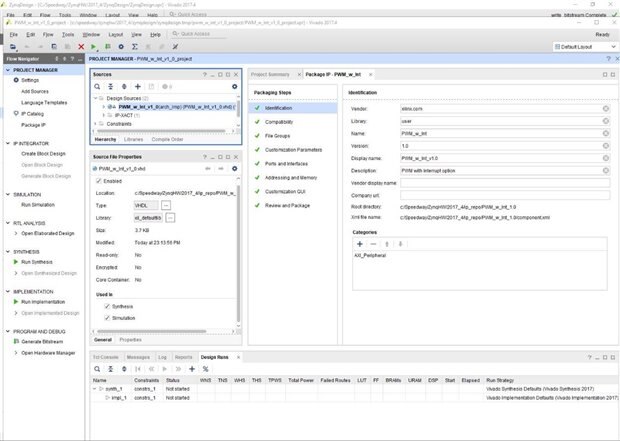

Modifying the VHDL code of the ip core to adjust to the project.
The long process of reviewing and packaging the PWM ip core.
After the customizations are done the ip core should be packaged and all the check marks set to OK.

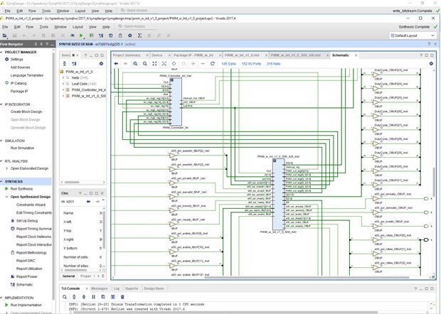

Compilation and the looking into the Schematic
Below are some pictures how the device design must look like once the ip core is integrated in the vivado project.

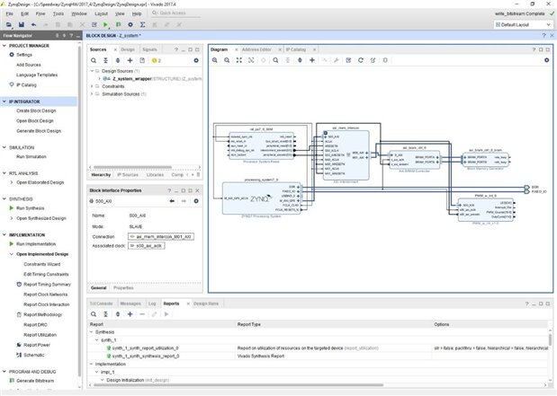

Exp 4: Add IP to Project

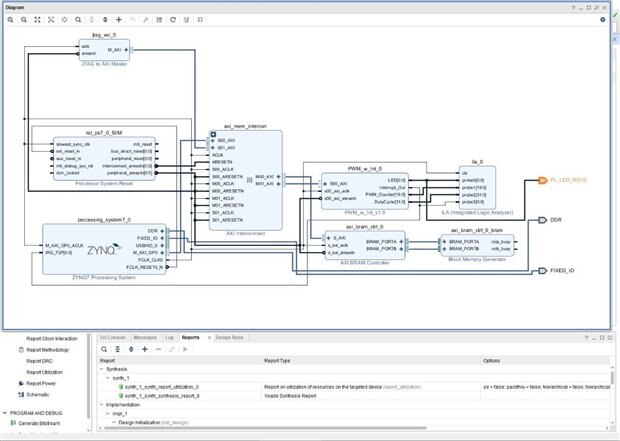

Here I added the ip core into the existing vivado project and and re-run the connection wizard. Later I also regenerated the layout to fit to the block diagram window. The interrupts in the ZYNQ7 Processing System IP block should be turned on and connected to the interrupt of the PWM_w_Int IP. Later I also added the inbuilt logic analyzer ILA for tests and configured the ILA wizard in the design.
The full design of the Block Diagram
