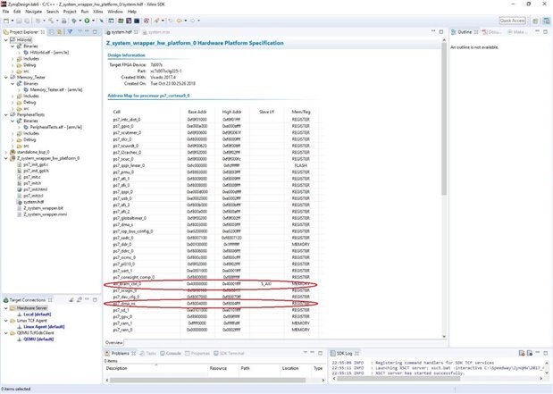

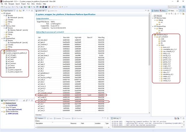

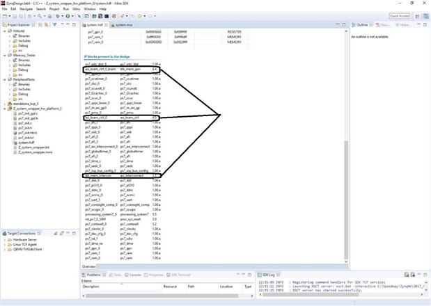

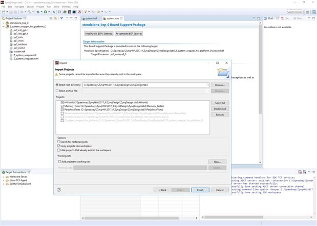

Adding software files from the lab5 to the lab6 SDK.

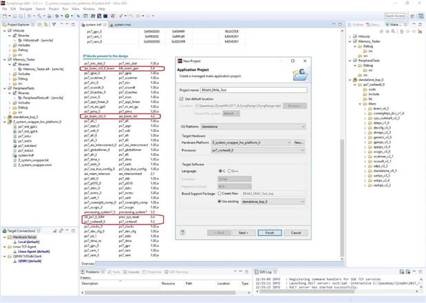

The changes in the peripherals can be seen here with the IP blocks present after adding the software files

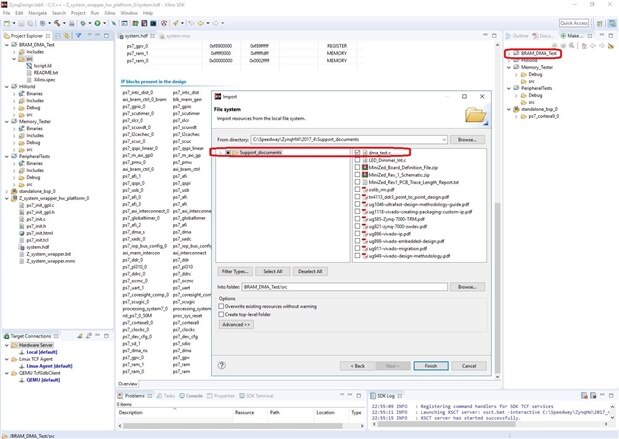

Creating an new software application project for the BRAM DMA testing

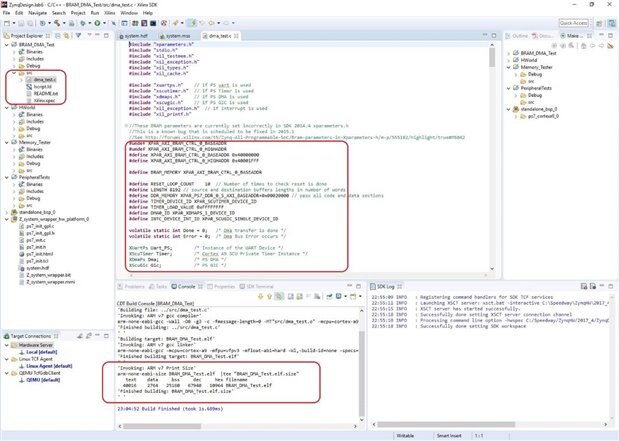

Below we got a sample program from the support guys to add the dma_test.c to the software application.

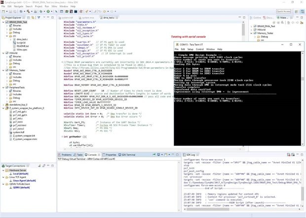

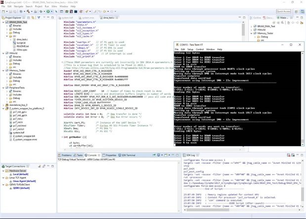

Testing Lab 6 with the serial port
Running the BRAM DMA test by launching the project on the hardware. The serial port is set to @11520 baud rate with the COM port.
