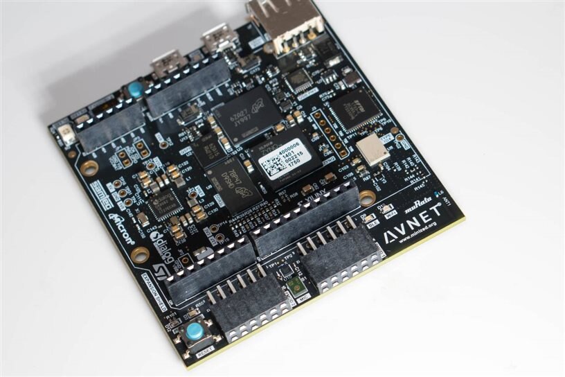

The MiniZedMiniZed is a coaster- (or MiniDisc - who remembers those : ) -sized board containing a Xilinx Zynq chip which contains an FPGA alongside an ARM Cortex-A9 applications processor. Along with my Path to Programmable colleagues I'm doing a training course to get up to speed with it all. The board also contains Flash memory, SDRAM, Wireless, and many other features - for more information, Blog 1 contained a tour of the board.

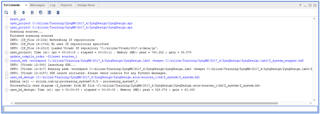

When using Vivado graphically, Tcl CLI commands appear in a pane. Vivado translates each GUI action into Tcl commands (you can see them in blue in the screenshot below). So, you don’t need to use the GUI, you could just type the commands into the command line bar under the pane yourself.

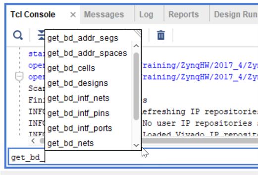

There is also tab completion, and also all the matches are listed as you type more and more characters in a CLI command. Detailed help information is available too, by prefixing the command with the word help (you’ll want to temporarily maximise the Tcl pane to view the help more easily).
Note that it’s not necessary to type commands in the pane inside Vivado; you could also launch a Tcl shell and execute the commands there, and there are also various options to run script files, including specially named files that will automatically execute at a certain stages in the process, e.g. before synthesis.

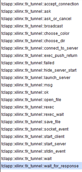

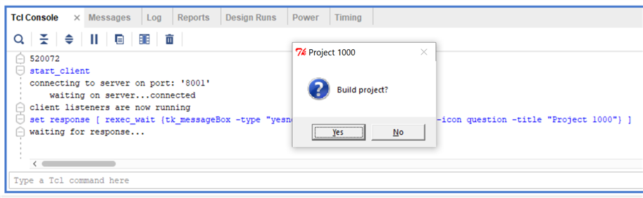

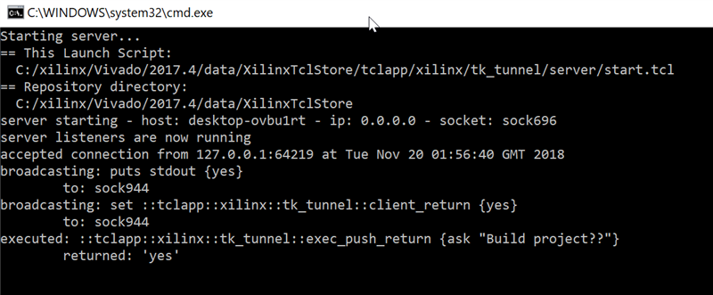

Interestingly, you could even create your own graphical user interface using Tcl and Tk, so that it interacts with Vivado. How is this useful? Say, if you had a project which was going to ship in three versions of memory size. You could as part of the build script, have a GUI which appears and prompts the user to select the board size (small/medium/large). The script would then take the results from the GUI, and configure the Zynq chip accordingly.
I still need to learn how to fully do all this (my Tcl knowledge is rusty – and Tk knowledge is almost non-existent) but I cannot imagine it would take long for anyone dedicated. Today I’d much prefer it if Vivado used Python, but it is what it is, and it’s not that hard at picking up another scripting language, to get stuff done.

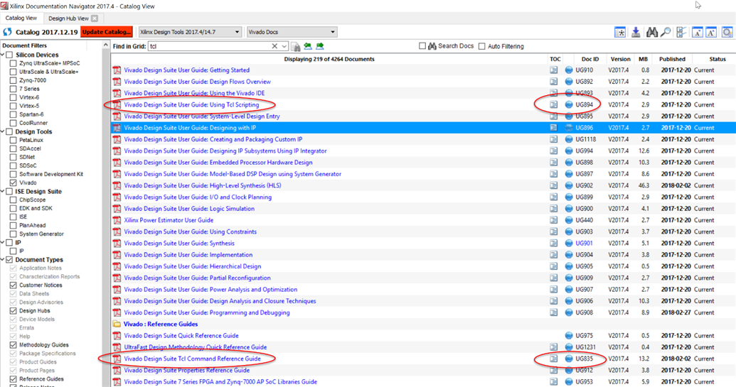

The documentation for Tcl is available within Vivado's Help menu. Click on Help->Documentation and Tutorials and then in the window that appears, there are hundreds of documents accessible. To narrow down, you could type Tcl in the search box at the top labelled Find in Grid. The relevant documentation for Tcl are document IDs: UG894 and UG835.

Custom Graphical User Interfaces
I was curious to see if Tk could be used with Vivado. According to the documentation it is possible, using some example code called tk_tunnel. The way it works, is that it starts another separate Tcl server, and then makes a communications connection (socket) to it. Any Tcl/Tk command can then be sent via that connection or tunnel, and responses can come back too. Some Tk message boxes have shortcuts that can be used if desired.
The available commands are listed here.
To use it, first the tk_tunnel package needs to be loaded into the Tcl interpreter. Then, the launch_server command is used to create the separate Tcl instance and get it listening. The start_client command is used to connect to it. It is all shown here:
lappend auto_path "C:/xilinx/Vivado/2017.4/data/XilinxTclStore"
package require ::tclapp::xilinx::tk_tunnel
namespace import ::tclapp::xilinx::tk_tunnel::*
launch_server "C:/xilinx/Vivado/2017.4/tps/win64/git-1.9.5/bin/tclsh85.exe"
start_client
Next, any other command from the available list can be used. To create a Tk message prompt box for instance and to read in the button-click into a variable called response, then this CLI can be used:
set response [ rexec_wait {tk_messageBox -type "yesno" -message "Build project?" -icon question -title "Project ZynqDesign"} ]
As mentioned there are some shortcuts, so it could also have been implemented as follows:
set response [ rexec_wait {ask "Build project??"} ]
When this command executes, a custom message prompt box appears!
The screenshot here shows what goes on in the server Tcl shell view for the example above:
I didn’t explore this feature much further, but either there is a bug or I don’t entirely understand how to use it, because although it worked and I could successfully retrieve the button-press result from the variable, I couldn’t re-issue the command a second time without closing down the socket and server first : ( And since there doesn’t seem to be any commands to do that, I had to manually do it by pressing Ctrl-C in the server window.
Still, I guess this is a more advanced feature that I don’t really need just yet. It would be handy for commercial projects though, to make it easier for people to use the entire system. For those interested, there is more information on tk_tunnel in the Readme file at this location when Vivado is installed:
C:\xilinx\Vivado\2017.4\data\XilinxTclStore\tclapp\xilinx\tk_tunnel
