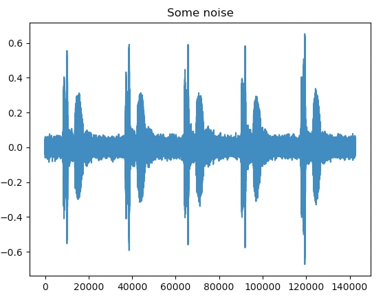

Noise
We can add some noise to the sample, randomly.
Here's the waveform, with a 0.02 noise factor:
