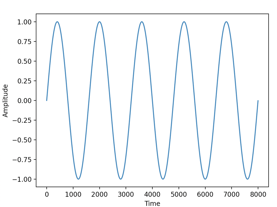

A sound signal is produced by variations in air pressure. We can measure the intensity of those variations and plot them over time.
Here's a very crude representation of a sound wave.

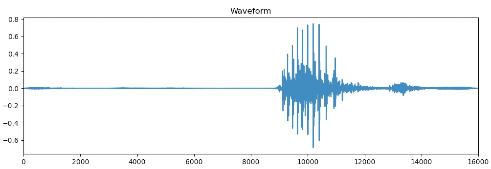

Waveform
A Waveform is a representation of the signal's amplitude at a specific time. Below we have an example of a waveform of a wav file with the word "right".

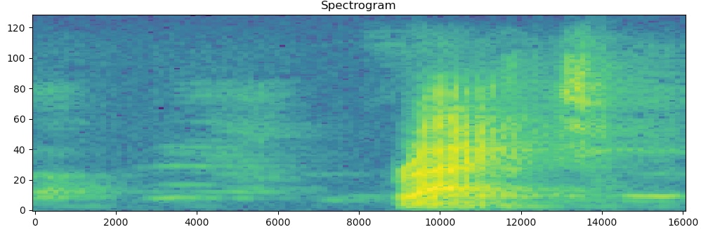

Spectrograms
Since a signal produces different sounds in time, its frequencies also vary with time.
A Spectrogram is an image representation of the waveform of a signal.  It shows its frequency intensity over time.
Here's the spectrogram of the word "right" - the same above
