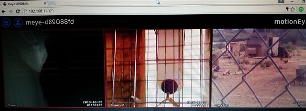

MotionEyeOs even automatically adjusted for the different card and I was able to both ping the RPi B+ and connect into the monitoring software.

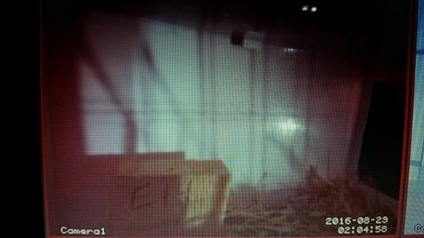

Camera 1 is the baby box monitor, currently looking at the rear of the Momma Rabbit.  As of today, no babies, but they are expected soon.
Camera 2 is the front of the Momma Rabbits cage, usually she is right there checking things out, but right now she is trying to figure out what that camera is doing in her box.  :-)
Camera 3 is the View to the Chicken Casa.
Here in Camera 1 we can see Momma's Ear, she had just put her eye right up to the camera checking everything out.

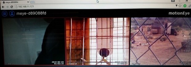

Here is Momma starting to get a little concerned from all of the camera's and activity.

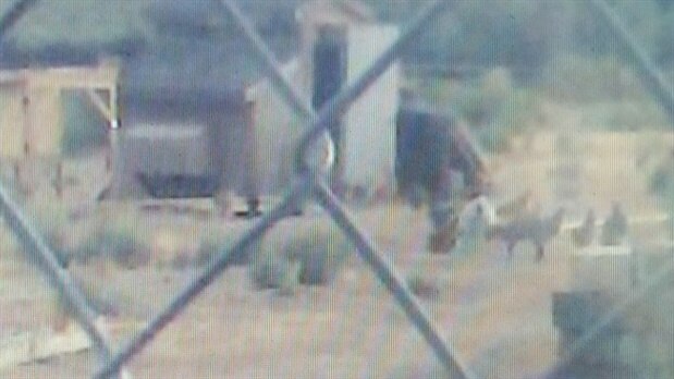

Here I tried to zoom externally on the Chicken Casa Camera, hard to tell but there is a variety of Chickens and G.O.A.Ts scrambling for treats.  The image is a lot easier to see on screen then it is when captured.

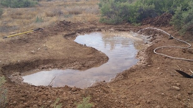

And as a final picture, here is a test run of the efforts of my son and I for making a larger Duck Pond.  I wanted to see how level everything is and how long the water naturally stays in our heavy clay area.
Eventually a little bridge will be added over that middle giving the ducks more shade to work with and the kids something neat to walk across and see their ducklings.
