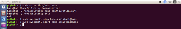

  follow the previous blog post to setup configration.yaml file with Sensors and the Philips Hue bulbs, but since we have installed Home Assistant in virtual environment, we will have to follow the    commands below to edit the file in the nano editor
    sudo su -s /bin/bash hass
    cd ~/.homeassistant
    nano configuration.yaml
    exit
  And then to test the changes stop and start Home Assistant using
    sudo systemctl stop home-assistant@hass
    sudo systemctl start home-assistant@hass

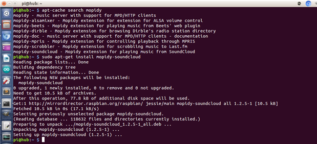

#3  Now lets install Mopidy
      run the following command
        sudo apt-get install mopidy
     Once installed to check out all the extensions that you install with mopidy run
       apt-cache search mopidy
for more info check out the documentation at  - Installation — Mopidy 2.0.1 documentation
#4 Installing extension, in my case I am using soundcloud
        sudo apt-get install mopidy-soundcloud
     if you have a spotify premium account , you can also install it using - sudo apt-get install mopidy-spotify

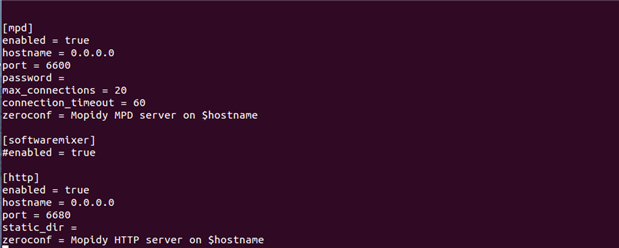

#6  Now modify the mopidy.conf to enable the HTTP and MPD
        sudo nano /etc/mopidy/mopidy.conf
      un-comment the http and mpd section and change the hostname section from 127.0.0.1 to 0.0.0.0 , this will allow you top open  mopidy on your browser
      Also un-comment out the souncloud section , if you have installed soundclound and add the API key which you will have to create an app for in the soundcloud developer console.

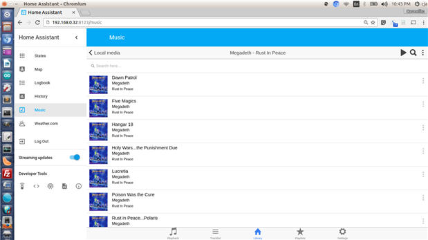

      We are going to use Mopidy-Mobile with Home Assistant as a web panel, in you can create playlist and browse your Pi and Soundclound as shown in the video above.
      And you can use Mopidy-Simple-Webclient ,to give your house guest a link , which will allow them to play your curated playlist , instead of them playing random stuff image..

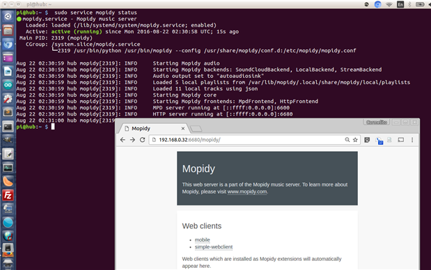

#8  To run mopidy on boot run
       sudo systemctl enable mopidy
    and then reboot your Pi, and to check the status of you install run .And then open url in your browser http://IpAddressOfPi:6680/, you should see the web clients installed.
       sudo service mopidy status
  If you have to stop and start the service , in case you FTP/load mp3 files to your Pi
     sudo systemctl stop mopidy
     sudo mopidyctl local scan
In addition, click the mobile link in the browser and create playlist, which you can then use with the simple-webclient

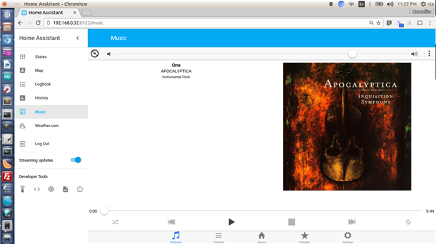

#9 Creating a web panel in Home Assistant to display the Mopidy  mobile web client
      Modify the  configuration.yaml file to add
panel_iframe:
  music:
    title: 'Music'
    icon: 'mdi:music-box-outline'
    url: 'http://192.168.0.32:6680/mobile/index.html#/playback'

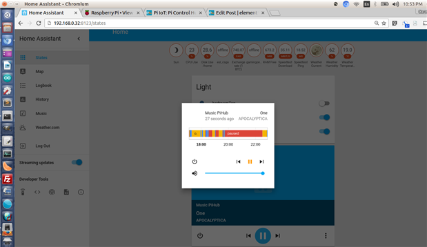

         modify the ip address of your Pi, here is how the web panel should look
this means you can now create and manage your music inside Home Assistant image ..

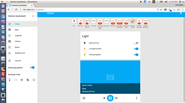

#10 Setting up Music Player daemon(MPD)
    Now if you want to save a couple of clicks image, instead of going to newly created music tab , you can setup MPD, which will show up in the status tab , and will allow you play your songs from    the   track list and control their volume. Add the following to the configuration.yaml file
#mopidy installed on the Pi
media_player:
  platform: mpd
  server: 127.0.0.1
  port: 6600
  location: Music PiHub

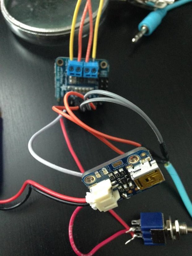

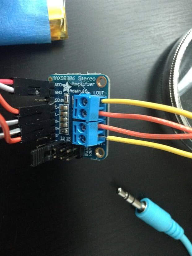

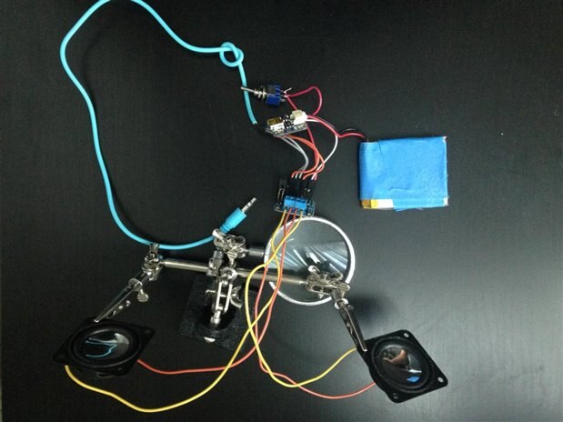

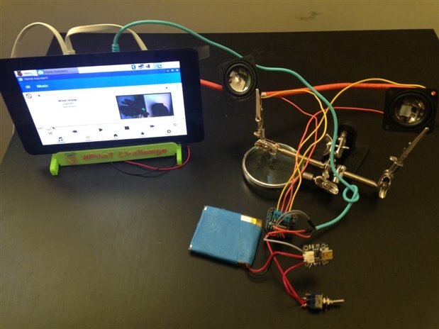

#11 Soldering and connecting audio jack to Audio Amplifier and Lipo battery
As part of the final setup, the idea is to have the speaker and Pi run on Lipo's, which means we will need a Lipo charger and  an On/Off switch.
{gallery} Circuit to connect the Pi to Speakers
Circuit
Stereo 3.7W Class D Audio Amplifier - MAX98306 (https://www.adafruit.com/products/987)
Adafruit Mini Lipo w/Mini-B USB Jack(https://www.adafruit.com/products/1905) or you can use the micro charges as well
Running Mopidy from Home Assistant
Tab setup as panel_iframe in the Home-Assistant configuration.yaml file
Music Player Daemon (MPD) setup
Cut off one end of of female to female jumper and then solder to GND pin on Adafruit Mini Lipo w/Mini-B USB Jack. Then connect the BAT pin to one end of the switch using using bread boarding wire and the other end to female jumper wire.
Now cut the end of your audio cable and connect 2 female jumper wires to the white line and one wire to Left side and the other to the right side.
And then connect negative wire from the Mini Lipo w/Mini-B USB Jack to GND and the positive wire to VDD, as shown in the picture above.
Once you are done with the connections, screw down the speaker in the blue terminal blocks
Now connect the lipo battery and turn on the speakers and connect the audio jack to the phone to test it out..
Also test that your lipo is charging and wait for the lipo to completely charge.
