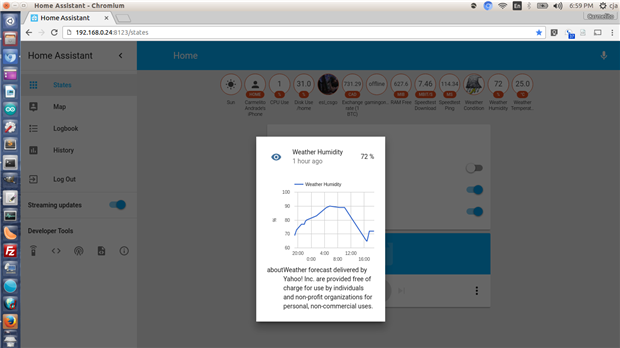

{gallery} Home Assistant controlling  Philips hue
Home Assistant setup on the Pi3 controlling Philips Hue bulbs

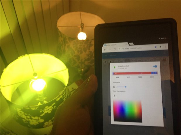

Picking a color for the Philips Hue bulb for my living room
Screenhot of color picker for the Hue bulb
Temperature from the Yahoo weather API
Humidity from the Yahoo weather API
Bitcoin value
CPU usage of the raspberry Pi3
Download bandwidth speed test
Monitoring Twitch channel at - https://www.twitch.tv/

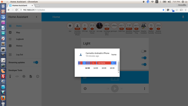

Checking if you are Home or Away by checking if the Pi3 detect the Bluetooth of the phone

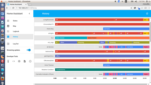

Checking the History of the various devices and sensors
Some more history, in a fancy graphical form

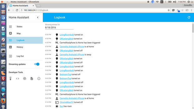

LogBook - And even more History , sorted by time..

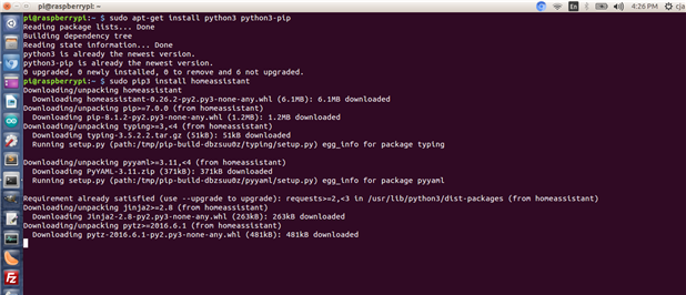

#1 To install Home-Assistant.io you are going to need to install Python 3 on your Raspberry Pi
     update Rasbian packages
         sudo apt-get update
         sudo apt-get upgrade
       Install python 3 and python's package manager PIP for python3
          sudo apt-get install python3 python3-pip
Note: I am using the Raspbian Jessie on a 16GB SD card on a Raspberry Pi 3
#2 install Home-assistant using pip
         sudo pip3 install homeassistant
For more info refer to the awesome documentation on the Home-Assistant site - https://home-assistant.io/getting-started/

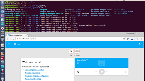

     check the path of the install of home-assistant,using
        whereis hass
     then update the home-assistant@pi.service file with
         cd /etc/systemd/system/
         sudo nano home-assistant@pi.service
      in the nano editor check and validate that ExecStart point to the path which is got as part of the whereis hass command, which in my case is
         " ExecStart=/usr/local/bin/hass --runner "
       Once done you will need to reload systemd to make the daemon aware of the new configuration. Enable and launch Home Assistant after that, using the commands
          sudo systemctl --system daemon-reload
           sudo systemctl enable home-assistant@pi
           sudo systemctl start home-assistant@pi
          Note: in the picture above i had my google chromecast on and connected to my Television called ChromeMainTV which was auto discovered in the Home-Assistant App
         Now when you reboot the Home-Assistant should start automatically
         for more info on the general instruction refer to https://home-assistant.io/getting-started/autostart-systemd/

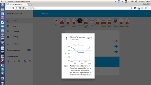

#4  Setting up current weather conditions to show up on Home-Assistant
        To setup weather condition , you will have to edit the configuration.yaml , for this you will need to familiarize yourself with the YAML syntax, but if you've worked with python this should be a           breeze image , given you are already aware of the importance of indentation..
        the  configuration.yaml can be found at
           cd ~/.homeassistant
        the edit the file add the following to the end of the file
          sudo nano configuration.yaml
sensor:
- platform: yweather
  woeid: 4118
  monitored_conditions:
   - weather
   - humidity
   - temperature
           To read more about the yahoo weather components check out - https://home-assistant.io/components/sensor.yweather/

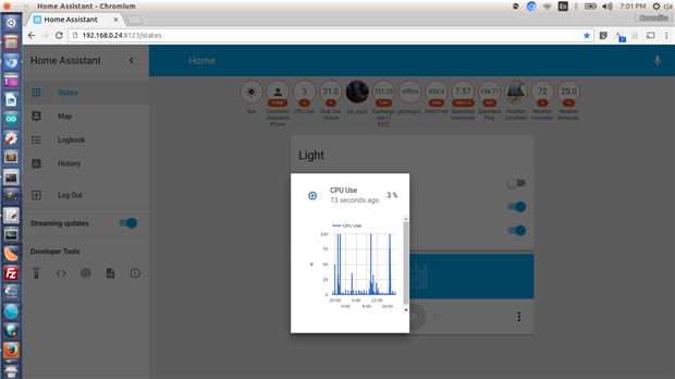

#5 Monitoring you Pi CPU, disk usage etc
      this is setup as a sensor, and add the following platforms section under sensor section of configuration.yaml
#Pi system monitor
- platform: systemmonitor
  resources:
    - type: disk_use_percent
      arg: /home
    - type: memory_free
    - type: processor_use
- platform: cpuspeed
     For more info check out - https://home-assistant.io/components/sensor.systemmonitor/
                                              https://home-assistant.io/components/sensor.cpuspeed/

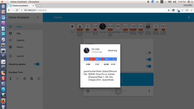

#6 Monitoring your favorite twitch channel to check if it is streaming now!
      This again is setup as a sensor, which means you will have to add this to the sensor section of configuration.yaml , here is an example
- platform: twitch
  channels:
    - esl_csgo
    - gamingonlinux
         here I am monitoring two channels as a demo , the fist one, is the most active Counter-Strike: Global Offensive channel
        For more info check out https://home-assistant.io/components/sensor.twitch/

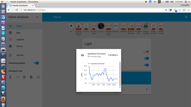

       Add the following bit to the sensor section , i my case I am interested in Download speed and pings, check out this link for more options - https://home-assistant.io/components/sensor.speedtest/
#Wifi speed tests using Speedtest.net
- platform: speedtest
    - ping
    - download

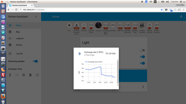

#8 Checking on the BitCoin exchange rate
      In my case I am checking the bitcoin exchange rate in Candian dollars CAD
- platform: bitcoin
  currency: CAD
  display_options:
    - exchangerate

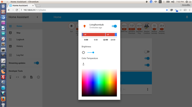

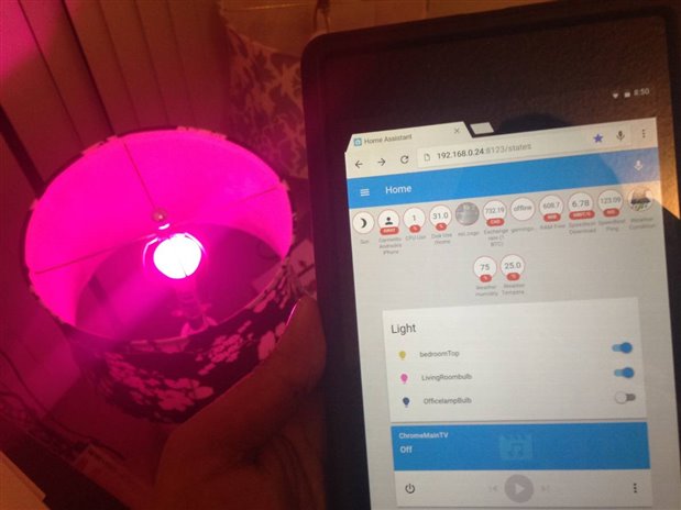

#9 Setting up the Philips hue Lights

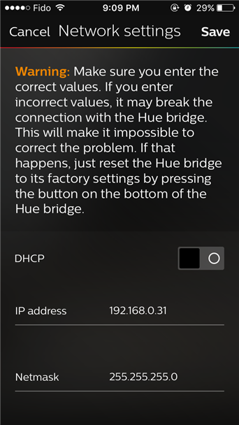

      To setup the Philips hue lights you will first have to get the IP address of the Hue bridge, to do this get on you phone , in the Hue app go to the network setting and make a note of ip address

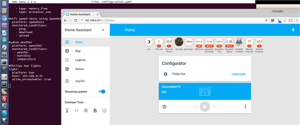

   Add the following lines to the configuration.yaml file
#Philips Hue lights
light:
  platform: hue
  host: 192.168.0.31
  allow_unreachable: true
once you are done with this setup reboot your Pi and then when you  should see the  Configurator for  Hue bridge in the Home-Assistant dashboard
One you hit the configure button , you should see all the Hue device in you dashboard

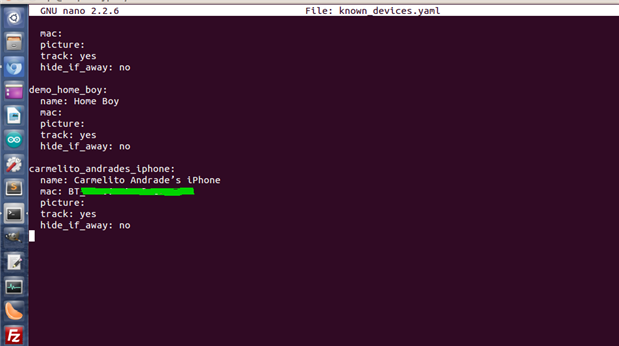

#10  Setting up Bluetooth , to detect your Phone
      It is now  time to take advantage off the Bluetooth on the Pi 3, basically we are going to check if the phone is Bluetooth range of the Pi 3 and switch on the Hue lights in the Living room, this           mimics that you have reached home and the Lights come on automatically. Start off by installing
         sudo apt install bluetooth libbluetooth-dev
      And then add the following to the configuration.yaml file
device_tracker:
  platform: bluetooth_tracker
       once done reboot your pi , and also switch off and switch on the Bluetooth on you phone , to check if device is discovered and added to Home-Assistant check the file at
           cd ~/.homeassistant
        and open the file,and you should see an entry for your phone, as show in the screenshot below
          sudo nano  know_devices.yaml
    For more info check out - https://home-assistant.io/components/device_tracker.bluetooth_tracker/
Now to lets setup an automation rule in the configuration.yaml file to check if your phone is detected by the Pi 3's Bluetooth
automation:
  alias: CarmelitosIphone is Home
  trigger:
       platform: state
       entity_id: device_tracker.carmelito_andrades_iphone
       state: 'home'
  action:
    service: light.turn_on
    entity_id: light.officelampbulb

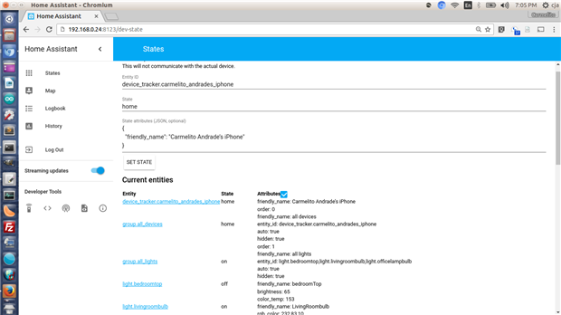

   to get the name of you device to add to the rule in the Developer tools of the Home-Assistant dash board , ie http://ipaddressofPi:8123/dev-state , as you see in the screen shot below the entity_id for my phone is "device_tracker.carmelito_andrades_iphone" and the state is "home"
Note: this is a very basic rule to get you started, you can modify this to add time check in the trigger section, to only switch on the lights if you get home at night between 7 PM to 11 PM..
