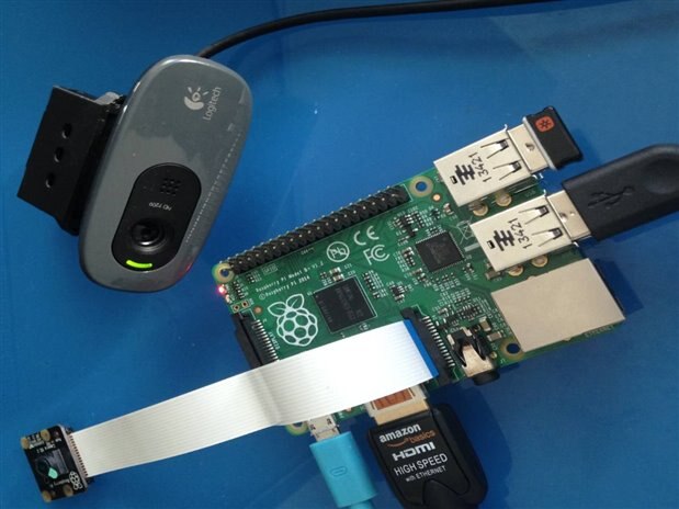

For testing the setup I am using the Raspberry Pi B+ as you see in the picture below, as I realized after buying the Pi zero that you need a special HDMI connector to the connect to a screen image  and in addition you  cannot use a console cable as the headers pins are not soldered to the Pi zero image ..
As part of the setup you can either use a USB webcam or a Pi Camera.
<the screenshot above show video stream from a Logitech USB camera connected to the Pi . Note: at this point in time the Pi NoIR Cam is not in use>

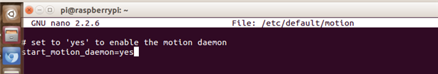

#4 To enable motion to start at every boot of the Pi, change the value of the start_motion_daemon from no to yes
      sudo nano /etc/default/motion

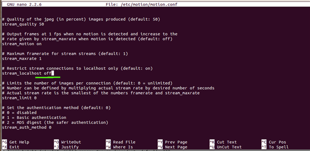

#8 But if you are running you Pi headless, dont worry we will modify the motion.conf file to turn off the following two parameter -- webcontrol_localhost and stream_localhost
         sudo nano /etc/motion/motion.conf

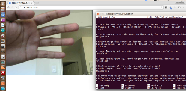

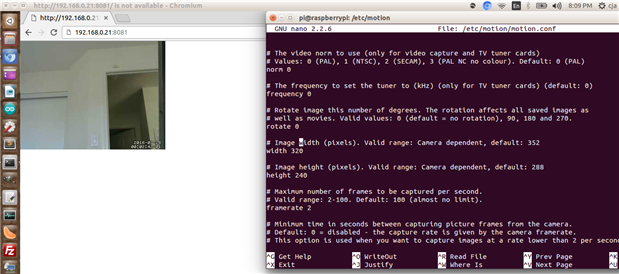

#9 In addition also modify the width and height in the motion.conf
       width 640
       height 480
Video stream before changing the width and height
#10  Once you made the changes to the .conf file stop and start motion using
    sudo service motion stop
    sudo service motion start

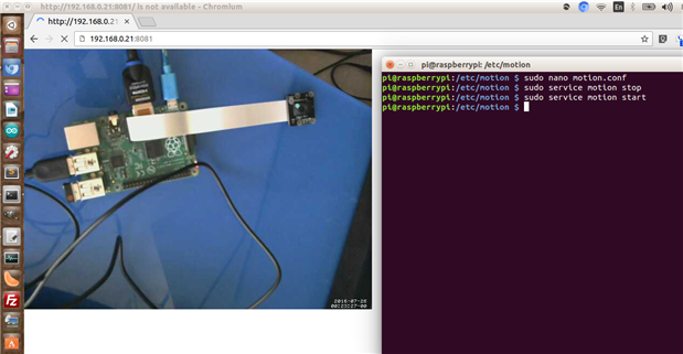

Here is the video stream after changing width 640 and  height 480 and starting motion

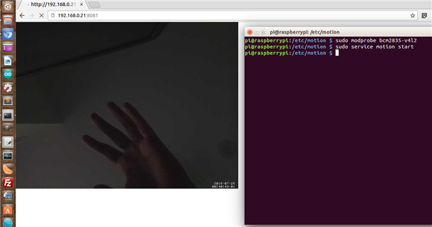

Note: if you are using the Pi cam instead of the USB Camera you will have to enable the Pi Cam driver with the commands in step below for the video steam to work.
In addition there are lot of other parameter that you can modify, and experiment with as part of the motion.conf file, like changing the framerate from 2 to 4, if you think the rendering of the video is slow, this is idea if you are using a Raspberry Pi 3 , but I would not suggest this parameter on a Pi zero or B+
#11 Set for the Pi Cam  - enable the Pi Cam driver
  Now if you plan on using Pi camera , and if you have not enable the drivers , using the command below , you will see the following error  in your browser "UNABLE TO OPEN VIDEO DEVICE",
  to resolve this stop the motion service  and activate the Pi cam driver
    sudo modprobe bcm2835-v4l2

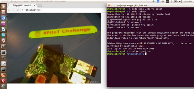

  you should now see the video stream as shown in the screenshot below, in my case i am using Pi NoIR camera V2

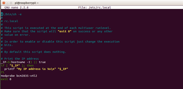

now to step the driver for every boot modify the  rc.local file as shown the screenshot below
  sudo nano /etc/rc.local
add the following line just above exit="0"
once done you can reboot your pi to test it out using
    sudo reboot
Here is a screenshot with the Pi NoIR camera streaming video to my computer, late in the evening with a table lamp on top of the camera.

    Thanks for the comment fvan ..Agreed if the image size is  set to 640x480, it wont make much of a difference ..
    I have the set the frame rate to 2 as part of the motion config file with a B+ which the minimum value you can set and this is just enough to detect movement(the jpg images are stored at /var/lib/motion), but having said that this parameter is configurable in the motion.config file. In addition, while setting it up, I did set the parameter to 30 fps, but as soon as i opened the URL in the browser the service crashed and  felt the Pi was heating up , which means i am going to stick to 2 or may be 4 image  ..
    With respect to latency there is noticeable amount of latency, i would say about 2 or 3 second..
