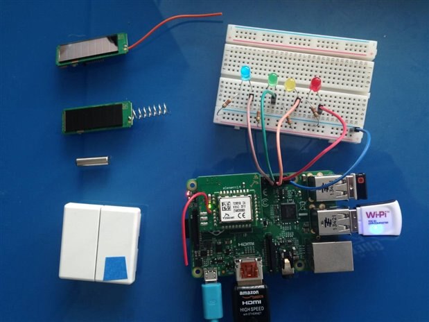

#1 Create a simple cuircuit
     Connect the EnOcean module to the Raspberry Pi B+
     And then connect the LEDs to the following pin on the Pi B+, you will also need a 330 ohms resistor
  •     Blue LED  to pin 6 on the Pi B+ , this corresponds to the one side of the push button switch, basically the side on which you see a small piece of blue tape in the picture below,basically when  you click on the  blue tape the LED is turned on and when you click on the opposite site the LED is turned off
  •     Green LED to pin 12 which corresponds to the other side of the button
  •     Yellow LED to  pin 13, this LED goes on when the magnet is in contact with the Magnetic Contact sensor
  •      Red LED to pin 16, this LED is turned on when temperature reading is received by the FHEM server

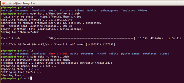

     Install the dependencies for FHEM
     sudo apt-get install perl libdevice-serialport-perl libio-socket-ssl-perl libwww-perl
     Get the latest deb from the fhem.de website
     wget http://fhem.de/fhem-5.7.deb
     Install the deb
     sudo dpkg -i fhem-5.7.deb

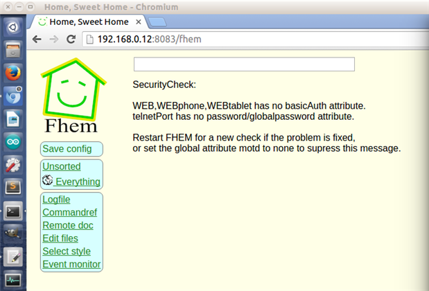

       Get the IP address of the Pi using the ifconfig command and check if FHEM server is up and running

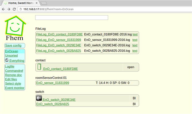

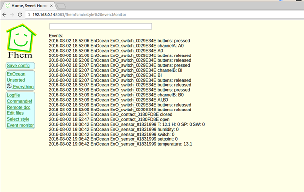

#3 Check out the Event Monitor of FHEM server webpage above, to check if the sensors are detected when you click the push button and the other sensor
In addition check out EnOcean Tab, where you should see all your sensor detected.
Note: In the screen shot ignore the second record under the Switch section, this is an extra push button switch, which I received in another kit .
In addition , if you receive the following when you press the button on the temperature sensor ""No EEP profile identifier and no Manufacturer ID"-wait for the sensor to charge, it took the sensor about 4-5 mins before it returned a reading.Also this is my first time using the enocean kit , so do leave a comment if there is way to resolve this image..

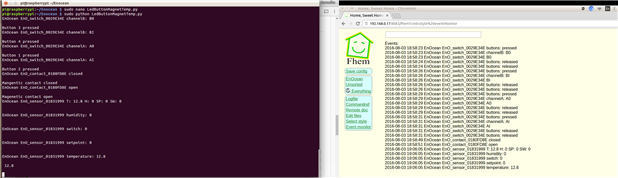

#4 Run the program below to light up the LEDs as shown in the video above
      Copy paste the code below  to you Pi using nano
         sudo nano LedButtonMagnetTemp.py
      run the python program using
         sudo python LedButtonMagnetTemp.py
Here is output once the PushButton switch(PTM210) pressed at all the 4 ends,and the magnet is brought close to Magnet Contact Transmitter(STM329) and the Temperature sensor(STM332)
