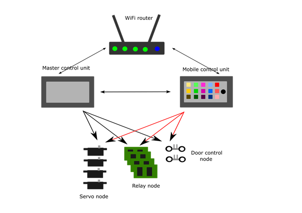

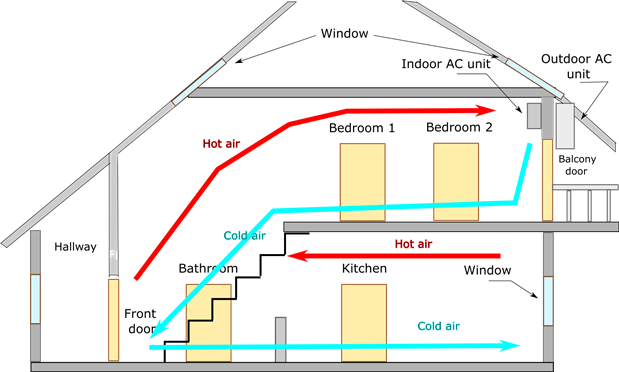

  I will present a use scenario, thought for my particular case (please look at the picture for a better understanding.)
  My apartment is on the third floor, have a east-west orientation and it is structured on two levels. On lower level is living room, bathroom and kitchen, on top level two bedrooms.
I have plants placed on both eastern and western windows, trouble is, they are sensitive to direct sunlight. So in the morning I have to close the blinds from the east part and ideally open them after noon and do the opposite for the blinds on the west side. Problem is, there is nobody home to do these maneuvers and to prevent plants to be harmed and also to prevent heat come through the windows during summer, the blinds are closed most of the day.
An automated system to manage the blinds and control water for plants would help plants to have more light in a more controlled way.
  An other aspect is air conditioning. The AC unit is placed on top floor and can provide cooling(and some heating) for entire space. Problem is, it cannot be programmed by default to start at a certain hour,
run for a determined amount of time, switch then to dehumidification or turn off, and so on. Moreover, if bedrooms doors are opened the cold air will spread in to these rooms and the lower floor will get
very little cold air. I plan to deal with these shortcomings by providing a more flexible control of AC unit and to provide an automatic way to control when bedrooms doors are opened or closed with the help
of two small robots attached to the doors. These robot are remote controlled by the two control units (Master and Mobile) according to temperature requirements configured by user.
There are also many other aspects that can be monitored and controlled remotely, these are only two examples of how this system can be implemented. Below is the system schematic:
