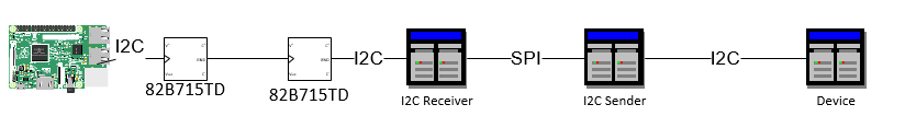

The main system is based on a server application that works on a Raspberry PI. I chose the version 3 for this because it has more connectivity options and more processing power. Mostly there are not many things to process but as the system grows it might be an issue.
This is how the system looks like:
Main Server:
The Raspberry that holds the application for the main server is the most important part since it is the one that ensures the communication between the devices. I started writing the application in C++ since it gives me the possibility to optimize it as much as possible. The server also holds a database where all the necessary data is stored (users, current state of things, reports of usage, etc).
I2C Interface:
At this point the I2C communication is the most used. This can also be reused for other devices that are centralized by another Raspberry, or another device with more processing power than an AtTiny chip. I chose the I2C because it is cheap to use and easily integrated with any other controllers. Here is a good explanation of how I2C works: https://en.wikipedia.org/wiki/I%C2%B2C
The main issue is that there can be only one master on the I2C network and because the micro controllers are not powerful enough I chose to always use the Raspberry as a Master and it pings the devices one by one to see if they have new notifications. When and communication is initialized by the master to a certain device it can also listen for messages sent by it. I made a ping function on the devices that when it is triggered the device responds with the number of notifications that it has. The Master can then ask for them one by one. With the ping function the Master can also know if something happened to a device and it can notify the user.
Another important function is the Identify function. You can see how it responds in the code for the light controller. The idea is that the Raspberry can send an identification message to all available addresses (there are only 127) and if there is an device on that address it can identify itself by saying what type of a device it is and some parameters necessary for the Server to control it.
In the case if the light controller the message was: 1#4#3#Lumini sufragerie#1. The first number is the type if the device. in this case it is defined as  switch and the main server knows to make a switch controller base don it. The second parameter is the I2C address of the device. The next ones are particular to the switch devices. The 3 is the number of switches it controls, then there is the name of the switch to be shown to the user (it says "Dining Room Lights"). The last number is an boolean value that states if the switches can be controlled or not.
An issue I encountered is that the I2C communication does not work well on long distances. I used an LAN Cable which has pairs of two wires twisted together. I paired one signal wire with a ground and this clears the signal a bit. Also, to communicate through a 100 m wire I used an transceiver like this one P82B715TD, which actually amplifies the signal to 35 amps and then lowers it back down. This also raises a cost issue but normally you can communicate with no issues in a room through normal I2C but for communication between rooms I've set up a "parrot" device made of two attiny's connected through SPI.
So the Raspberry server sees in the message an address written on 4 bytes, the first two are for the parrot device and the last two for the actual device.

  • michaelkellett
    michaelkellett over 10 years ago in reply to bosc +2
    For long distance, low cost coms you still can't beat RS422/485 - as you have discovered I2C isn't very good for long distances (more than few feet) without buffer chips and this reduces its cost advantages…

    For long distance, low cost coms you still can't beat RS422/485  - as you have discovered I2C isn't very good for long distances (more than few feet) without buffer chips and this reduces its cost advantages.
    422/485 uses the usual UART found on pretty much every micro and an interface chip.
    It may be much too late to change but here's  a link to a useful TI paper (but read some others before you buy anything image).
    www.ti.com/lit/an/slla070d/slla070d.pdf
