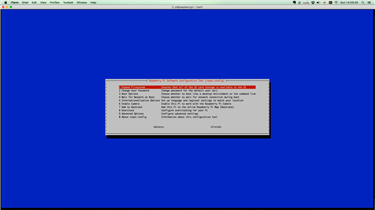

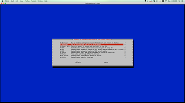

After connecting via SSH (via ethernet or wifi), the file system was expanded using "raspi-config":

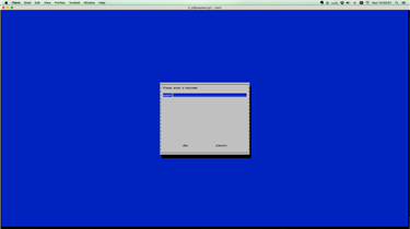

Using the same application, the hostname was changed to "puppet":

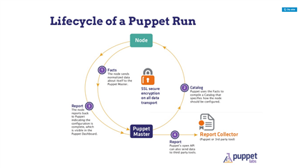

The puppet master holds the definition of every node by means of reusable modules. A node is then defined by a specific combination of modules, in order to obtain a specific role.
