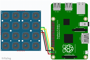

Trellis
In order to implement this tab switching functionality, I'm using the 4x4 button matrix called Trellis, which I introduced in my previous post. It connects to the I2C pins and requires two software libraries to be installed.
On the hardware side, nothing fancy: connect the Trellis to the I2C pins and power it via the 5V pin:
