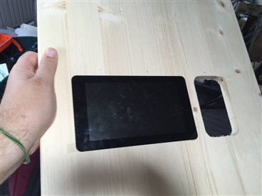

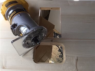

Enclosure
This unit will obviously also require an enclosure. The same wood and acrylic highlights will be used, making a consistent set image I'm still trying to figure out which shape to go for and how to tackle it, but here's a first attempt at the front panel:
To gain on milling times, I'm trying a combination of CNC routing for the outer edges, and manual routing to create grooves and depth. This drastically reduces CNC time!
