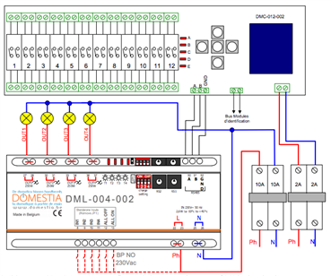

Next to the electrical wires, the modules have a three way connector labeled A, B and GND. Searching the datasheets, it is explained the domotics modules are connected to a RS485 bus for communication.
The wiring is illustrated in the module's manual:
The RS485 bus could be an entry point in reading the lights or outlets' status, and eventually control them.

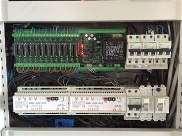

Here's what it looks like in real life:
The RS485 bus can be accessed via the dimmer's blue, green and orange wires, labeled A, B and GND.

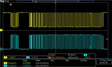

I started by first connecting my oscilloscope to the bus, verifying there is activity. Probe 1 was connected to line A, probe 2 to line B. This is what I saw:
Three things can be observed/confirmed at a glance:
  • there is a constant flow of data
  • there is a short sequence followed by a long one: request vs response?
  • line B is indeed an inverted version of line A

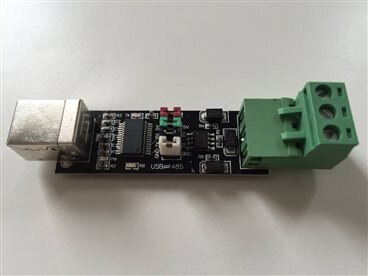

Knowing there is data present, I could perhaps find a script or piece of software able to decode the data. For that purpose, I bought a generic RS485 to Serial USB module.

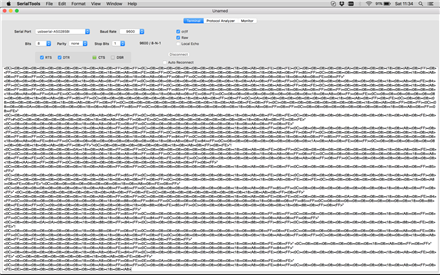

Using a basic serial tool, I was able to dump the raw hexadecimal data. A new observation, is that every new line, starts with the hexadecimal value "0x0C".
With a script I found and modified to suit my needs, I captured the raw data and jumped to a new line every time the "0x0C" value appeared.

Some of the captured sequences:
0c 08 08 08 08 08 08 08 08 08 08 18 08 a8 08 ff 08 ff
0c 08 08 08 08 08 08 08 08 08 08 18 08 aa 08 ff 08 fe
0c 08 08 08 08 08 08 08 08 08 08 18 08 a8 08 fe 08 ff
0c 08 08 08 08 08 08 08 08 08 08 18 08 a8 08 ff 08 fe
0c 08 08 08 08 08 08 08 08 08 08 18 08 a8 08 fe 85 ff
0c 08 08 08 08 0a 08 08 0a 08 08 18 08 a8 08 fe 08 ff
0c 08 08 08 08 08 08 08 08 08 08 18 08 a8 08 ff 85 ff
0c 0a 08 08 08 08 08 08 08 08 08 18 08 a8 08 ff 08 fe
0c 08 08 08 08 08 08 08 08 08 08 18 08 aa 08 fe 85 ff 22 20
0c 08 08 08 08 0a 08 08 08 18 08 a8 08 ff 84 ff
0c 08 0a 08 08 08 08 08 08 08 08 18 08 a8 08 ff 08 ff
0c 08 08 08 08 08 08 08 08 08 08 18 08 a8 08 ff 85 ff 22 20
0c 08 08 08 08 08 08 08 08 18 08 a8 08 ff 08 ff
0c 08 08 08 08 08 08 08 08 08 08 18 0a a8 0a fe 08 ff
0c 08 08 08 08 08 08 08 08 08 08 18 08 a8 0a ff 08 fe
0c 08 08 08 08 08 08 08 08 08 08 1a 08 a8 08 ff 08 ff
0c 08 08 08 08 08 08 08 08 08 08 18 08 a8 08 fe 08 fe
0c 08 08 08 08 08 08 08 08 08 0a 18 08 a8 08 ff 08 ff
0c 08 08 08 08 08 08 08 08 08 08 18 08 a8 08 fe 08 ff 22 20
0c 08 08 08 08 08 0a 08 08 08 08 18 08 a8 08 fe 08 ff
0c 08 08 08 08 08 08 08 08 08 08 18 08 a8 08 ff 08 fe 22 20
There is a very repetitive pattern, with occasionally different values. But what does it do or mean?

    Long live Belgian designs The 0x0c is the form feed character. One would expect that they'd use a line feed to separate lines.

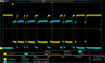

    I agree. It looks like your bit period is ~26us which would point to a baud rate of 38400 not 9600. Don't even bother trying to interpret the serial capture until you have done it at 38400.
  • pettitda
    pettitda over 10 years ago
    Looks like from the oscilloscope shot above that the baud rate is maybe 38400.  Your capture window shows a baud rate of 9600.  Can you recapture with 38400?
