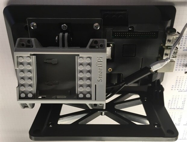

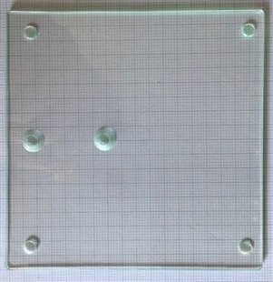

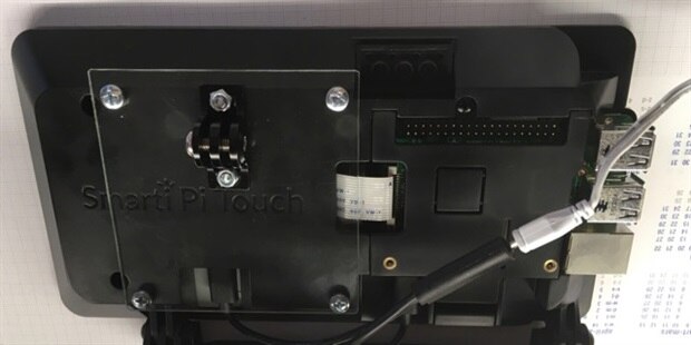

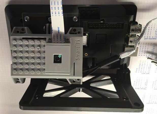

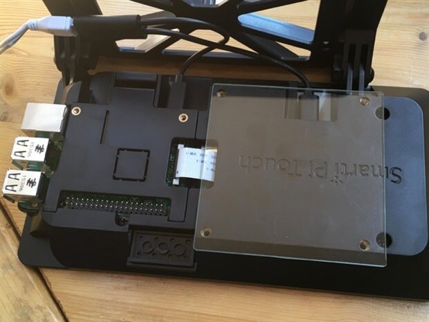

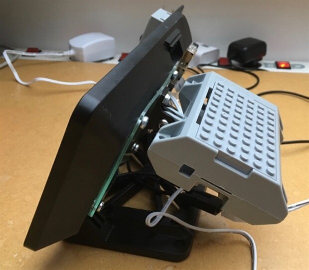

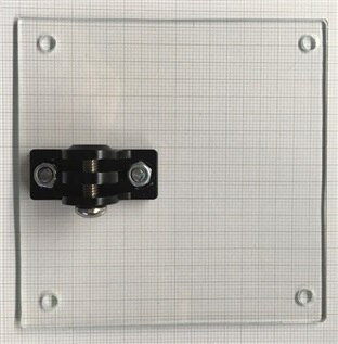

In my previous blogspot I told you that I planned to buy the 'Smarti Pi Touch' case. For the additional Pi B I decided to use the plain 'Smarti Pi'. Although this case is quite expensive, it has its benefits. Like the 'Smarti Pi Touch' it is also LEGO compatible. And it also comes with a LEGO compatible case for the camera. So now I have two LEGO compatible cases and two LEGO compatible camera cases. For mounting the 'Smarti Pi' to the 'Smarti Pi Touch' I made a small plate of LEXAN which I mounted on the back of the 'Smarti Pi Touch'. With the supplied bracket the second case is mounted. The camera's can now be put on the LEGO plate covering this case.
LEXAN plate, bracket mounted.
Plate will fit on the back.
Like here.
Second case added.
One camera added.
View from the side

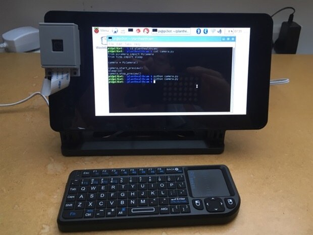

I started to connect the color camera to the Pi 3 using the instructions found on https://www.raspberrypi.org/learning/getting-started-with-picamera/worksheet/. The camera software was initially disabled, so I enabled it using the configuration tool.
After a reboot I tested the camera with a small python program:
from picamera import PiCamera
from time import sleep
camera = PiCamera()
camera.start_preview()
sleep(10)
camera.stop_preview()
Although I preferably control the Pi via a remote connection from my laptop, in this case I'm using a small wireless keyboard and touchpad.
For testing the camera is placed on the front of the case. (I really like this LEGO approach).
Here is a 10 seconds live video shot using the python script above.
