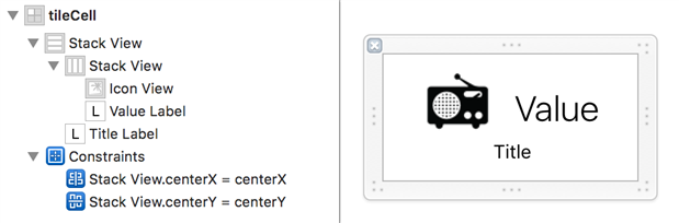

The model doesn't say anything about how the tile will look on screen, it just focusses on managing the status. So what about the UI? For that we use the TileCollectionViewCell, which is a subclass of UICollectionViewCell. It is defined using a nib-file and structured by using Stackviews:
The corresponding class is a simple subclass of UICollectionViewCell which takes care of the border radius and hides the value label if there is no text defined (due to the Stackview that results in the icon being centered above the title). The heavy lifting happens in the TilesViewController, which is a UICollectionViewController. It has a property to hold a list of Tile objects. To high light a few parts: in viewDidLoad all tiles are subscribed to their respective MQTT topics:

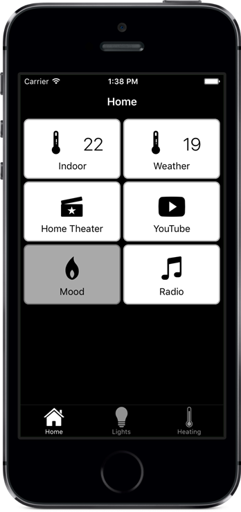

Putting it together
To put it together we create multiple instances of the TilesCollectionViewController and add them to a UITabBarController. Each instances overrides a single method defining the tiles. For the icons we use a library which enables us to use IonIcons instead of images. The home screen displays the most-used tiles:
class HomeViewController: TilesCollectionViewController {
    override func initTiles() -> [Tile] {
        return [
            InfoTile(title: "Indoor", icon: .Thermometer, topics: [.status: "Thuis/weatherIndoor/temperature", .icon: "Thuis/weatherIndoor/icon"]),
            InfoTile(title: "Weather", icon: .Thermometer, topics: [.status: "Thuis/weather/temperature", .icon: "Thuis/weather/icon"]),
            ButtonTile(title: "Home Theater", icon: .FilmMarker, topic: "Thuis/scene/homeTheater"),
            ButtonTile(title: "YouTube", icon: .SocialYoutube, topic: "Thuis/scene/youTube"),
            ButtonTile(title: "Mood", icon: .Flame, topic: "Thuis/scene/mood"),
            ButtonTile(title: "Radio", icon: .MusicNote, topic: "Thuis/scene/radio")
This brings us the result of this blog post: a working iPhone app which communicates with Thuis through MQTT.
When messages arrive on the status-topics, the selected-status of the button-tiles and the value of the info-tiles are updated. When one of the button-tiles is tapped a message is send to the set-topic with the new status. As described in Publishing activity from Z-Way to MQTT this is already picked up and executed.
You probably do notice that it looks very plain yet: we'll fix this in a next blog post. We'll also add some more controls, like slider, which can be used for dimmers and a volume control.
