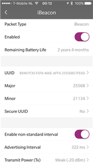

Hardware set up
We want to know who is where on a room-level, so who is in which room. To identify different rooms we'll deploy a iBeacon is every room we're interested in. We're using 3 Estimote Location Beacons and 3 older Estimote Proximity Beacons. In the entrance, living room, bedroom, kitchen and office 1 beacon is installed at the center of the outer wall (as far as possible from other beacons). The signal strength of each of them is tweaked ranging from -30dBm (±1.5 meter) in the smallest rooms to -20dBm (±3.5m) in the bigger rooms. Each beacon is configured to broadcast its ID approximately 3 times per second. These values will likely be optimized further over the coming period.image

And the beacons are defined as:
struct BeaconIDs {
    private static let uuidString = "B9407F30-F5F8-466E-AFF9-25556B57FE6D"
    static let all = [home, bedroom, office, living, kitchen, entrance]
    static let home = BeaconID(uuidString: uuidString, identifier: "home")
    static let bedroom = BeaconID(uuidString: uuidString, major: 23476, minor: 64333, identifier: "bedroom")
    static let office = BeaconID(uuidString: uuidString, major: 25568, minor: 21134, identifier: "office")
    static let living = BeaconID(uuidString: uuidString, major: 40474, minor: 19278, identifier: "living")
    static let kitchen = BeaconID(uuidString: uuidString, major: 16433, minor: 64211, identifier: "kitchen")
    static let entrance = BeaconID(uuidString: uuidString, major: 16433, minor: 21894, identifier: "entrance")

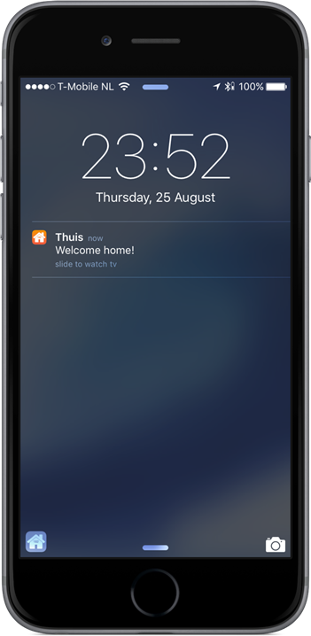

Based on the same events we can welcome a user home as well and directly give him a useful action. I could directly turn on some lights for example, but I rather give the user the choice. So we'll send the user a notification with an action. We'll start with a single action, but later multiple actions can be added depending on for example the time or person.
When we get home we often watch an episode of a TV series (currently we're watching The Mentalist, very nice show!), so the action of choice will be turning on the home theatre system.
Sending a notification is easy. In the BeaconManager we create a function for it:
func sendLocalNotification() {
    let notification: UILocalNotification = UILocalNotification()
    notification.alertAction = "Watch TV"
    notification.alertBody = "Welcome home!"
    notification.soundName = UILocalNotificationDefaultSoundName
    UIApplication.shared.presentLocalNotificationNow(notification)
We'll call it from the didEnterRegion method when we enter the home region. To avoid getting too many notifications in case of exiting and entering the region by accident we'll add a cool down period of 5 minutes. This looks as follows:
if beaconID.identifier == BeaconIDs.home.identifier
   && (lastLeftOrEntered[beaconID] == nil || (lastLeftOrEntered[beaconID]?.timeIntervalSinceNow)! < -60*5) {
The result is you receive this notification when you arrive home:
