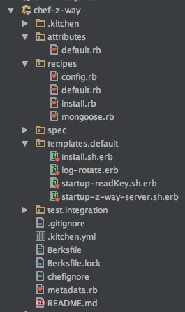

The most difficult to get working was Z-Way. There is no cookbook available yet, so I had to build this one from scratch. I could have taken a relative easy way out by just letting the cookbook execute Z-Way's install script, but as I want to learn Chef I went for the hard road. On the right you can see the structure of the cookbook. The full cookbook is available on Github at Edubits/chef-z-way.image
The cookbook uses a few recipes to install Z-Way to the device, and more importantly to safely upgrade it while retaining the configuration of all devices. It also installs the required services and enables them to automatically start like:

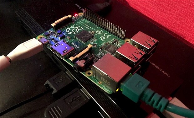

Chef has a very nice way of testing cookbooks using Kitchen and Vagrant: it spins up a virtual machine from an image and runs the recipes on that. I used this for the general testing, however quite some of my changes and configuration are specifically made for the Raspberry Pi. This means to test those I had to use an actual device. For this I used my good old Raspberry Pi 1B. This required some patience, as one chef-client run without any changes takes about 5 minutes on this device. As there are some differences in architecture between the 1B and the 3B I expect there will be some small changes needed when deploying the cookbooks to the new device.

As soon as the kit arrives (somewhere in the coming week) I will install them using raspbian-ua-netinst, assign a static IP in my router and then I can bootstrap the Raspberry Pi's with just one command each:
knife bootstrap 10.0.0.201 -t raspbian-jessie-chef.erb --ssh-user root --ssh-password 'raspbian' --node-name 'thuis-server-core' --run-list 'recipe[thuis::thuis-server-core]'
knife bootstrap 10.0.0.202 -t raspbian-jessie-chef.erb --ssh-user root --ssh-password 'raspbian' --node-name 'thuis-server-tv' --run-list 'recipe[thuis::thuis-server-tv]'
