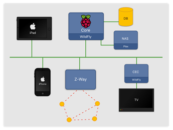

Since quite some time my home automation is build around a core app made in Java EE. As part of this challenge I'm improving the core and integrating it more tightly through MQTT. The core is responsible for coordinating all nodes and enforcing the business rules for our home.
The Thuis core runs on the Raspberry Pi 3 in a WildFly container. Like all nodes it's connected to the MQTT broker for communication with the rest of the system. It also takes care of communication with some external applications, like Plex (media server) and Netatmo (weather station). In this blog I'll focus on the integration of MQTT, Z-Way devices and the rules.image
The building blocks of the application are as follows:

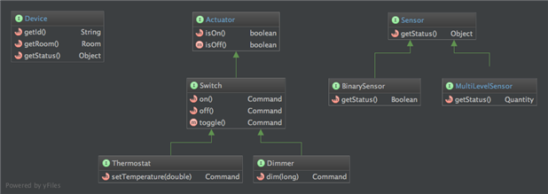

Device Model
The two base models are Device and Room. To be combined with Device there are different types of Actuator and Sensor. The following image and table show the interfaces. There are several implementations, for example there is MqttSwitch which implements Device and Switch and defines a switch which can be controlled through MQTT.
InterfaceDescription
DeviceGeneral definition of a (virtual) device: an identifier and it's status (type will be overridden by more specific interfaces)
ActuatorA device with controls
Switch
extends Actuator
A switch with on/off and toggle features
Dimmer
extends Switch
A switch which also has can have values between 0 and 100, where 0 is off
Thermostat
extends Switch
A thermostat supporting a set point for the temperature. It can be turned on/off, which will put it on predefined on and off temperatures
SensorA device that provides a (single) value of a sensor
BinarySensor
extends Sensor
A sensor with a value that can be true or false
MultilevelSensor
extends Sensor
A sensor with an arbitrary value and a configurable unit of measurement
All devices are virtual devices, each with a single function. For example a sensor that can measure both temperature and trigger on movement will be implemented as two sensors: a MultilevelSensor and a BinarySensor.
