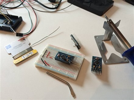

This post covers the "final" versions of the code and hardware used for the nodes in the living room, parents and kids´ bedrooms. I say "final" as I expect to require some bugs, the nice thing of prototyping image. In the project status update, you can see that in this post I´m wrapping previous features and putting together the detailed workflow of the nodes.

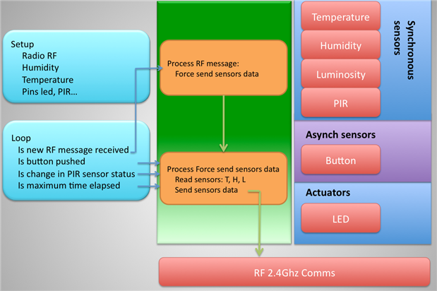

The Living Room node - Process flow
Let´s start by the Living Room node as the other two will be a subset of this one. As a summary of posts 2 and 3, the hardware is an Arduino Nano, a movement sensor PIR, RF 433Mhz, IR receiver, temperature sensor DS18B20, humidity sensor DHT11, a photo-resistor and a RF2.4Ghz for the comms. Additionally I have added a button and a LED as you never know when you can need them image - in the posts you can find links to all of the components and some reasons for choosing them. For the software, the specific libraries I am using are the RF24, RF24Network, DallasTemperature, DHT, IRremote and one that I wrapped myself some code on the Internet into a library: DIO_lib. You may check the posts 2, 3 and 4 for some explanations on the libraries and external links.
An additionaly homemade library I'm using is the Defs_y_Clases.h, here I define some commands for the RF24 and I have also created a timer object to be able to control the time elapsed - this object takes care as well of overflows, approximately after 50 days the "long uint" variable will overflow, since the project will be used in the long run, there is a need to take care of this. The overflow control is though still under testing... Attached to the post.
As you can see in the diagram, the set-up and the loop functions are quite straight forward.

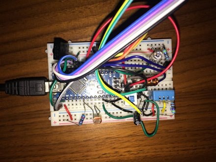

The living room node has a number of sensors that are polled synchronously in the loop function -  it is the program which decides when to read the data. Additionally, it has the IR receiver that is read asynchronously, meaning that the IR library captures the IR data when it comes and then the loop function reads and process is synchronously. This approach, sync/async, is the same one used for the RF 2.4Ghz Comms. The library reads the data when it comes and then the loop function process is in sync.
Arduino code of the living room node:

One issue to call out, call it mistake or just the typical bug you don´t know how to solve and spend lot of time trying to fix, is that turning on and off the lights with the TV remote was sometimes working and others not. I reviewed the code several times, thought there would be interference or just a week signal, maybe there was a problem with the double click of the TV buttons, etc... Until I found the solution, I had to add the lines 323 and 335 and also 344 and 354. Basically I had to disable any interrupts when sending the RF 433Mhz instruction to the RF plugs. My speculation: there are lots of IR interference and probably also on the 2.4Ghz, meaning that I "guess" that the Arduino was called via interrupts by the IR and RF24 libraries. Even if these could take only microseconds up to 1 millisecond, this pause in the RF433Mhz message is enough to damage the message and the plug would not recognize it correctly.
Another issue I am facing is that from time to time the Arduino is not processing the IR command to turn on/off the light. My feeling this time is that I need to send the RF433 message a couple of times -  basically add a for loop from line 345 to 355. More to come when I test it!
A couple of pics of the node:

The soldering itself is not that difficult but I looked in the Internet for some "best practices" and found a couple of good ideas. Here is a short video as an example.
In my case, it took me a bit longer, not a professional on soldering image Besides, that, nothing really special to raise. This is the processflow for the nodes:
