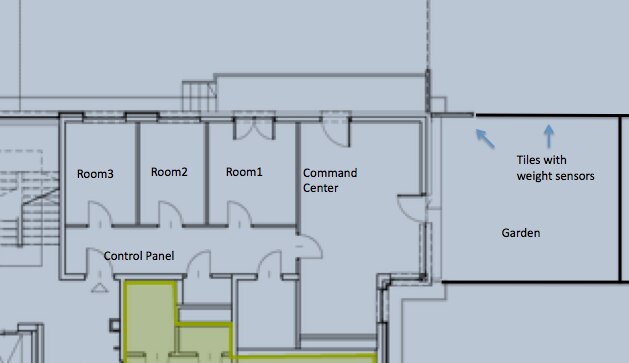

Modules of the SmartSpace
The above diagram with the flat and the garden should help to better understand the flat distribution, showing where the main components: the Command Control and the Control Panel
Command Center
The Command Center governs the actions required to make my SmartSpace more comfortable and secure. It captures the data, analyses it and, by combining it with the DB knowledge, actuates. The command center allows also manual override. As a fault back plan, the things connected to the Command Center will be designed to allow some autonomy in case they cannot connect with the Command Center after a time threshold - you don't want to have a blinking lamp just because a module lost connectivity with the center...

Control Panel
This will allow human interface and will be placed at the door entrance (inside home). It will provide information on the weather forecast and pollution forecast (obtained via Internet, a good starting point is the Weather Underground API), as well as key information from the SmartSpace - like people presence, recommendation on going by car or biking, outside temperature, rain, is the car in the garage, etc.

Things in the rooms
In each of the three rooms there will be a module consisting of an Arduino Pro-mini, four sensors (temperature, humidity, luminosity and PIR) and a RF-2,4GHz. These will communicate with the Command Center via radio. Their main function is just to inform of the environment situation and any motion, therefore will be quite a light module. They will be quite light and easy to hide of the eye-sight to avoid non-geek people get stressed

    jkutzsch over 10 years ago +2
    Looking forward to seeing how this works through each phase. I love the break downs and priorities with future expansion potential. Great way to plan the minimum of what you want to accomplish within the…
  • jkutzsch
    jkutzsch over 10 years ago in reply to mg.sergio
    On the plus side if you have a neighbor or family close by you could possibly ask them to check out the alarmed state of the house.
    The flame sensor was for the natural gas heater, if it does not sense a flame it shuts off the gas.  With the sensor having just a little carbon build up, it believes there is no flame and shuts down the gas, after this happening a couple of times the entire system goes to an alarmed state with a preset flashing alarm sequence and thing start getting cold.  :-)  If you were really serious about monitoring heating/cooling you probably could look at your system and tie into the alarm/LED and have some options for some where around Phase 4 of your planning.  :-)
    Not sure of you current Fire protection (smoke/CO alarms), but some systems have whole house wiring so if one alarm goes off all of the alarms are set off, looks like a pretty basic communications system and you could probably drop an extension down from your nearest detector to one of your PIs to be tied into the existing protection system.  Our system is pretty old but it does have the whole house wiring.
  • rhe123
    rhe123 over 10 years ago in reply to mg.sergio
    Okay, that's the same ones I used to have. Luminosity might work as a solution. Another option could be to detect if there is power on the outputs, although that means having to deal with 230V...
  • mg.sergio
    mg.sergio over 10 years ago in reply to rhe123
    Thanks rhe123 for the hint, I was not much aware of the Z-Wave switches. I have at home 3 DIO - Chacon plugs similar to these ones. They work at 433Mhz and as you say... you are blind and can't confirm if the signal was received correctly. As an improvement (phase 2), I will leverage the luminosity sensors in the rooms to detect a peak on the light, not yet ideal as your point, but...
    Thanks for the hint and look forward to your project as well!
  • rhe123
    Sounds like a really interesting and extensive project! I see we have a few things in common, so also looking forward to learn from each others progress.
    I see you'll be using RF-433Mhz switches. I used those before and at some point exchanged them for Z-Wave switches, the lack of a return signal (or being able to ask for the status) made 433Mhz a lot less reliable. They are a lot more affordable though... So, if you didn't order these already, I would advice you to look into some alternatives.
    Good luck and enjoy!
  • mg.sergio
    mg.sergio over 10 years ago in reply to jkutzsch
    Thanks jkutzsch for your idea, I have added to the planning a temperature alarm that should notify us if the temperature is outside a given range. Most probably remotely I will not be able to fix it, but by knowing it when we are out, at least as you say we can get ready image
    Building up also on your flame sensor point, I have added a fire detection feature - I believe there are some sensors that can detect flames in the distance and it is worth having a look at it.
