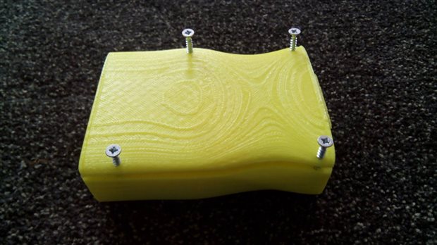

A special case
The position and motion sensors information from the SenseHATSenseHAT on the Raspberry PI3Raspberry PI3 together with the RGB 8x8 display are  the perfect tool to make the controller interactive interface for IoT project.
Making the device easy to control by any kind of user the hardware needs a case. The form design and the impacting bright yellow colour harmonise with the site where the installation will be set in place; it is also an easily identifiable object by visually-impaired users.
The following images shows the rendered design of the case hosting the PI3 and SenseHAT
The design has been split in two halves to include the hardware elements as shown below:
Top and bottom parts will be fixed with 4 Parker screws. Based on the first tests the internal air circulation should be sufficient for Raspberry PI3 cooling.
3d printing and assemblilng
The 3D printing operation requires about 5 hrs total with a 0.4mm nozzle and a layer thickness of 0.2mm The case will not be stressed mechanically so it is sufficient setting the internal fill to 25% with a 0.6 thickness to the sides. As shown in the above image most of the time required depends on the need of a full internal support of the empty spaces.
The above image shows the "kit" components ready for assembling; note the the open window for the SenseHAT LCD will be sealed with a 2mm opaline acrylic frame: this generates a nice effect for the display readability. The internal hardware does not need to be fixed with screws but a 5mm antistatic foam bed is sufficient, pressing the internal assembly when the screws are closed.
{gallery} Assembly steps
The components ready for assembly
The top side with the Raspberry PI3 fit in place.
The case ready to be closed
Closing the case with the four screws

    Hi Enrico, That looks amazing, especially the curves, and it is practical too, with ventilation slots and everything : ) By the way, if you want to use M3 machine screws (bolts) instead of wood screws…
    balearicdynamics over 9 years ago in reply to shabaz +1
    Hello Shabaz! Happy to see you aboard again I have already saw these in some industrial cases but I have hot though how to search them. Sometimes I loose a lot of time because I don't know the technical…
    shabaz over 9 years ago in reply to balearicdynamics +1
    I've unfortunately not found a seller of M2 inserts like that, I too would like to obtain some. There is this manufacturer https://www.tappex.co.uk/multisert-inserts#selectors but they don't have an online…
